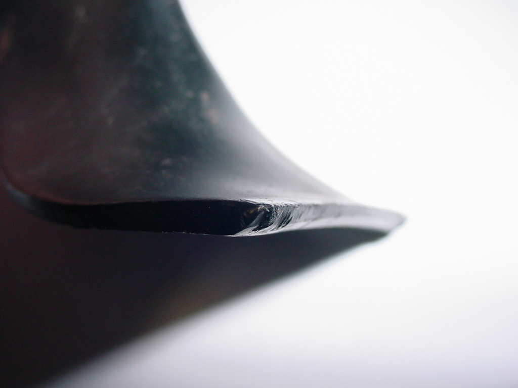

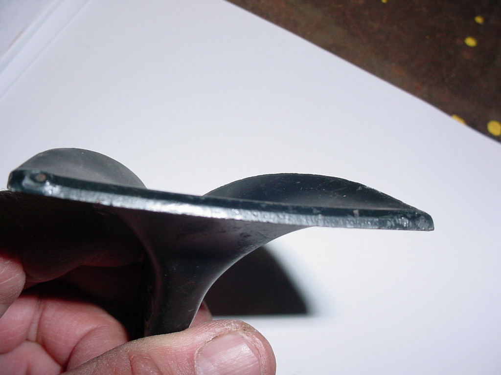

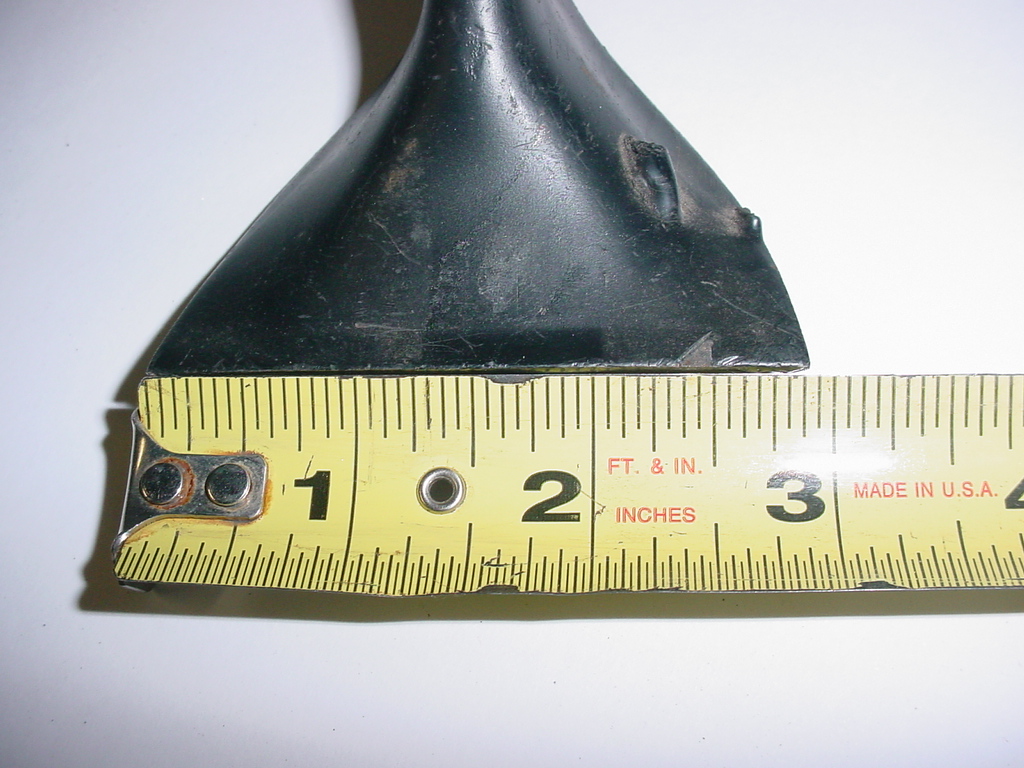

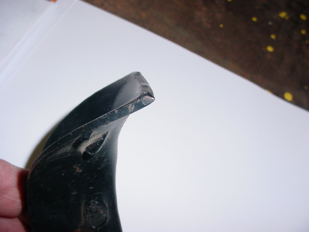

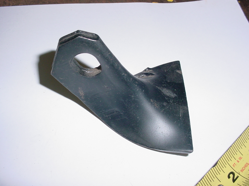

I was just about to post a new message asking about how sharp flail mower knives should be.
I just purchased a used John Deere 25A. It's turning out to be a bit more of a project than I was hoping, the rotor bearings are disintegrating. I have taken it all apart (it was easy because it has lived indoors all of its life) and luckily the rotor shaft and bearing carriers appear to be fine.
While I have it apart I'd like to resolve all of its issues so that it will hopefully be trouble free for at least the next couple years. The flail knives are pretty dull, almost blunt. They're not rounded off at the corners, just not sharp at all on what would be the cutting edge. How sharp is a new John Deere 25A flail knife, the kind that looks like a duck foot?
Thanks!
   / Flail Mower RX #4
I plan to install a few new blades on my 25A. Here is a few photos of my new blades, I hope it helps.
   / Flail Mower RX #5
Mr. DocDryden, that was extremely helpful, thank you!
You do live up to your tag line, that's for sure.
