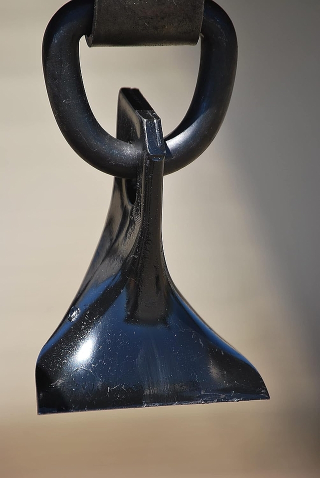

I raise mine as high as I can on the 3PH and put jack stands on each side. I pull the flails off to sharpen them but, for me, it's just a bolt and nut holding the link and flail on. Mine uses the folded cup knives with a hole in the top for the triangle link. I only remove the ones that need work or replaced. I try to keep a stock of them ready to install so it goes pretty quick. And they are a heck of a lot easier to grind when they're in a vice. ;)

For balance, try to grind them all the same amount.
