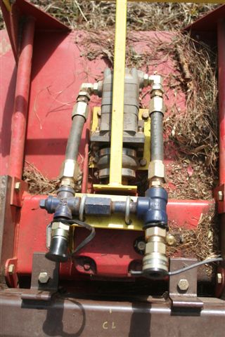

This is the relief valve I should have posted.
Surplus Center - 1/2" NPT 20 GPM 1500-3000 PSI RELIEF VALVE RV-H4
It is used across the motor, paralleled.
If you think you will ever turn the motor in reverse, then this valve is the way to go.
Surplus Center - 1/2 NPT 30 GPM 1500-3000 PSI HYD CUSHION VALVE
Here is a pic of a relief valve across a hyd motor.
The controlling valve for the flail should have a motor spool valve to let the flail mower wind down.

Relief valve should be in parallel circuit and normally set higher than operating for surge protection.
