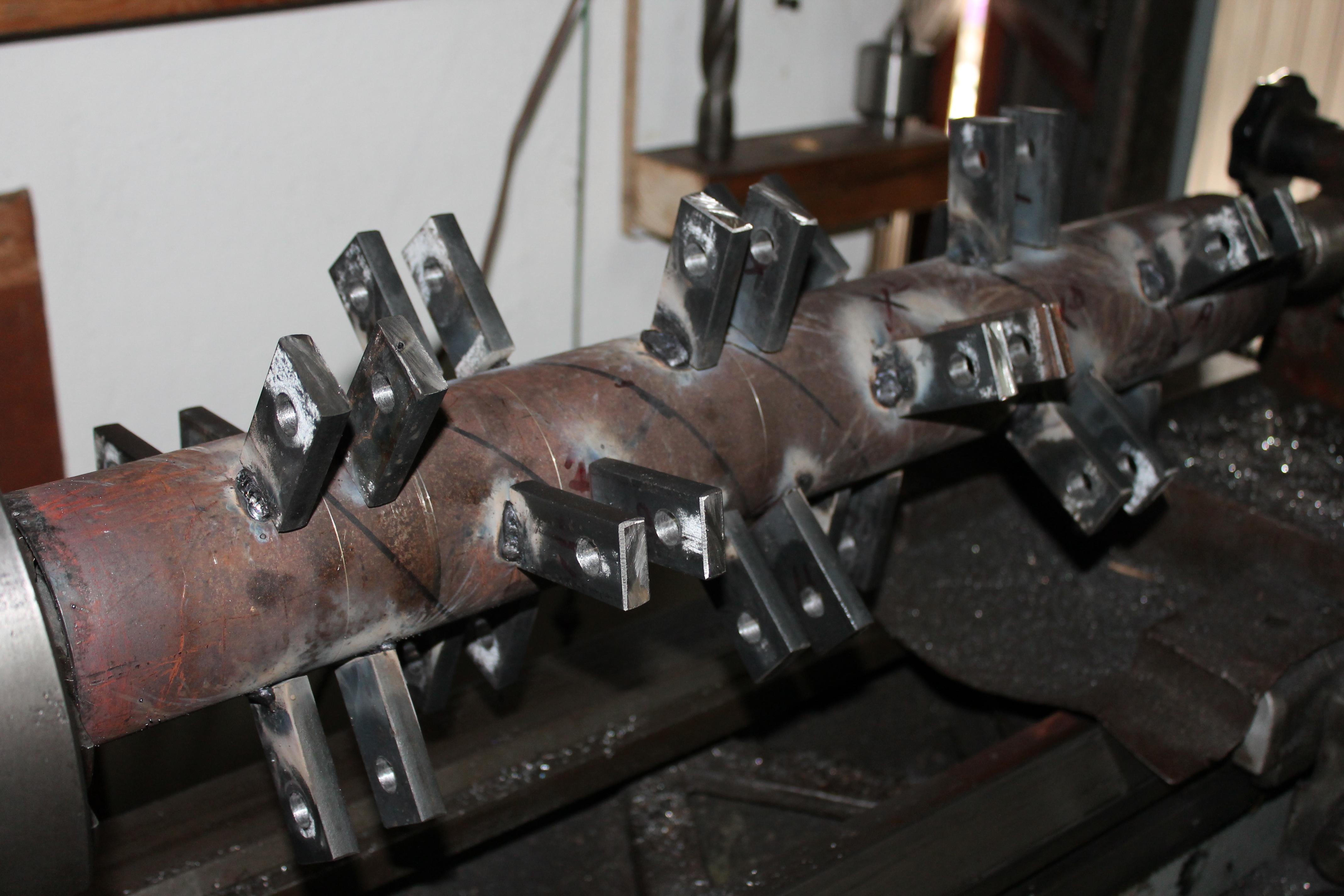

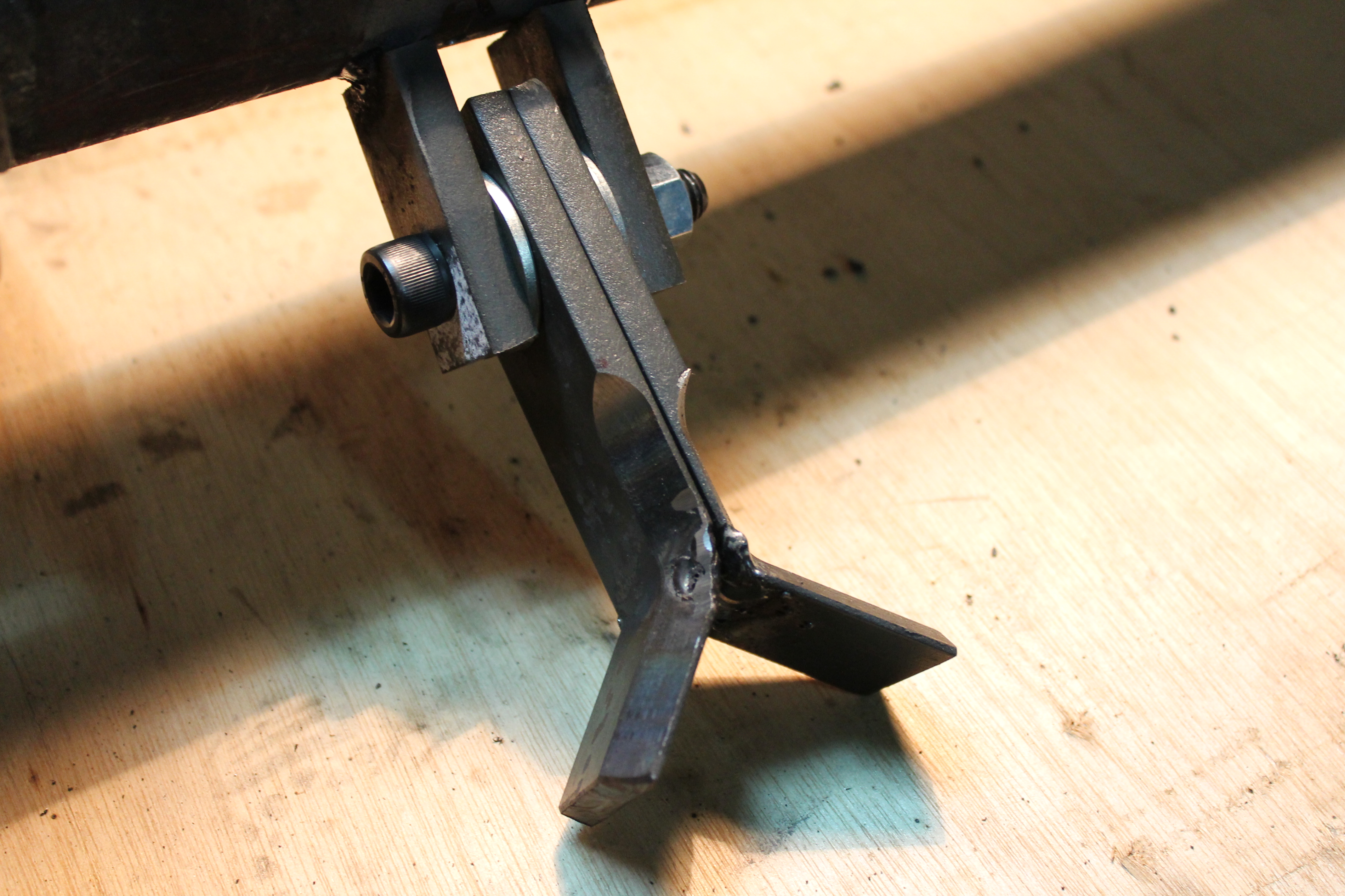

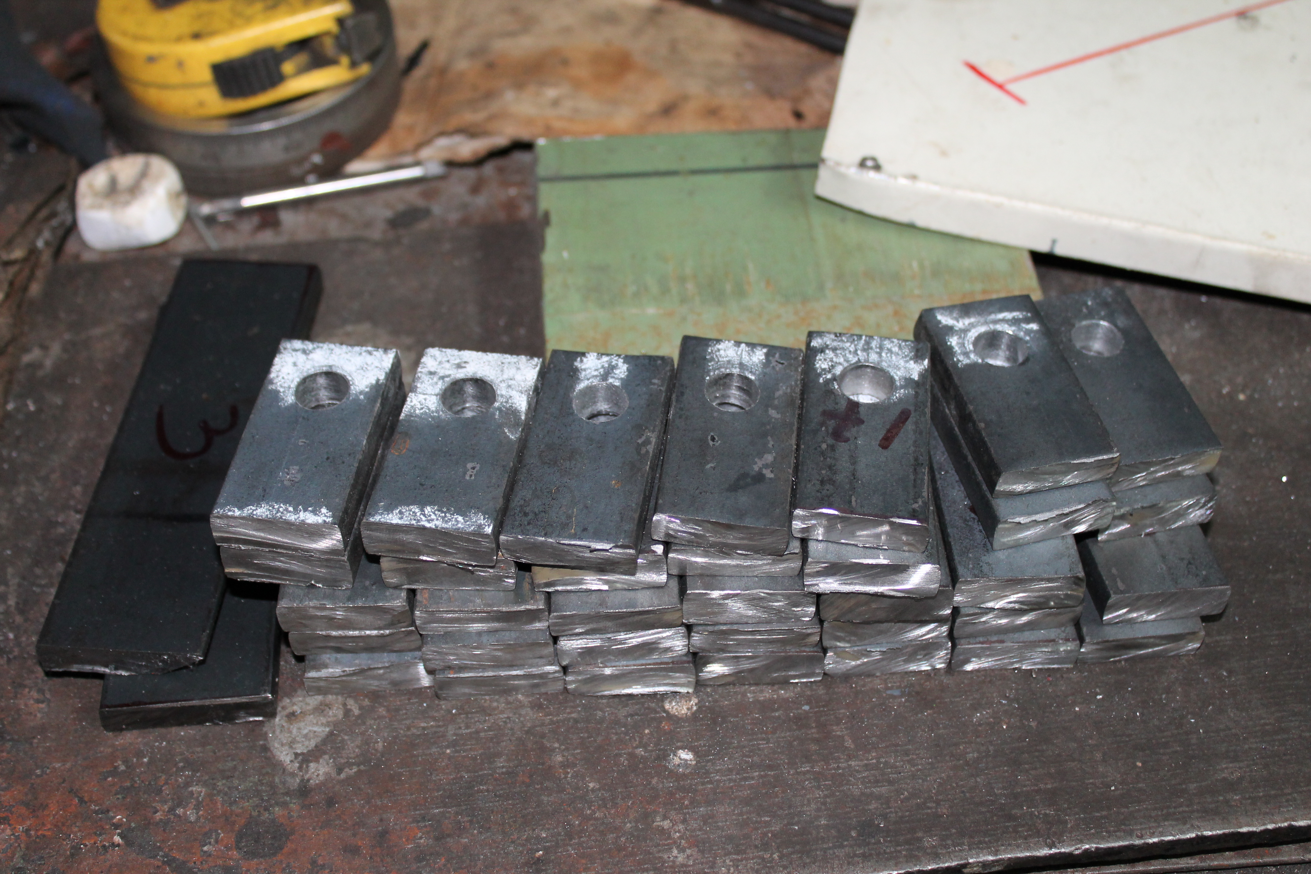

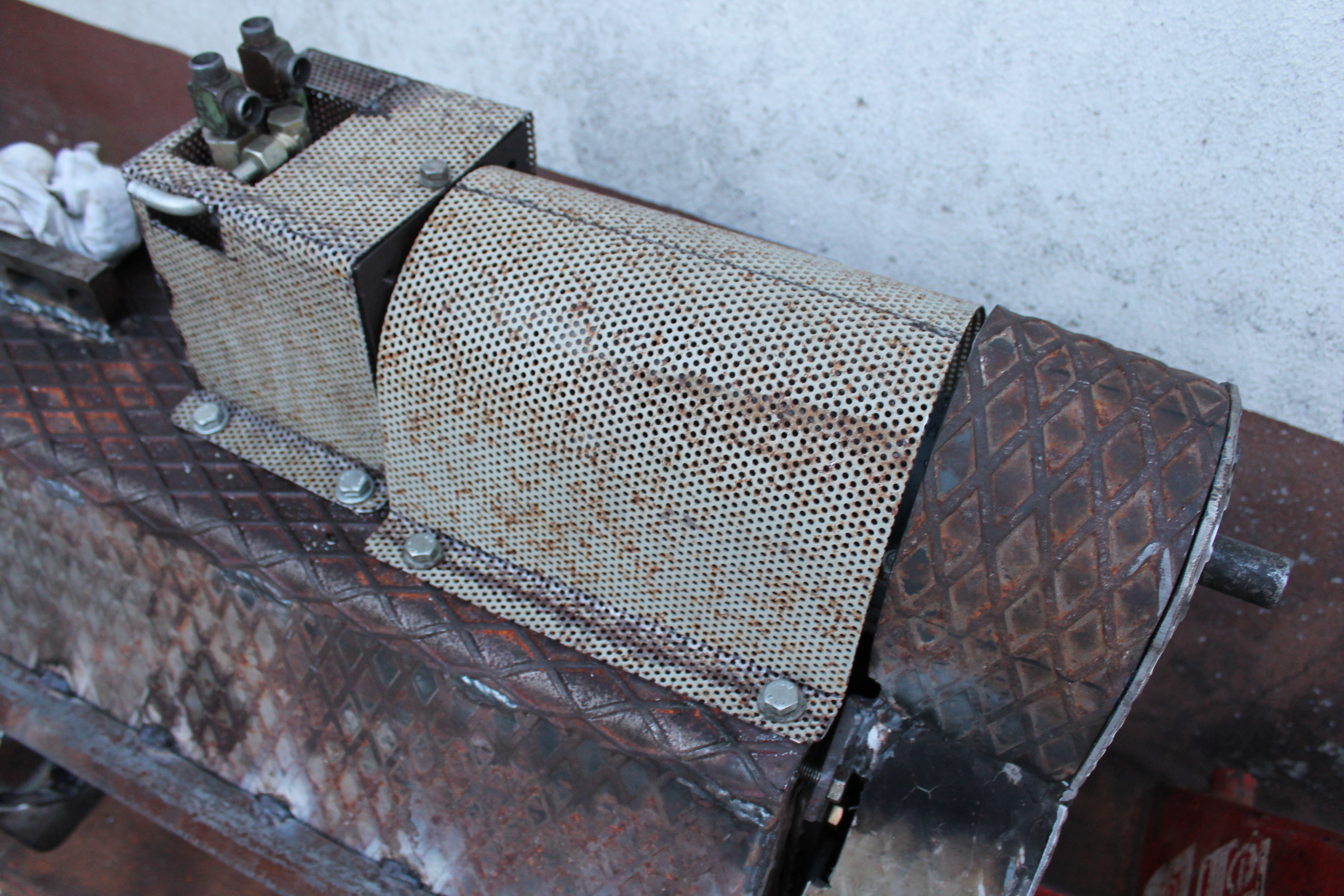

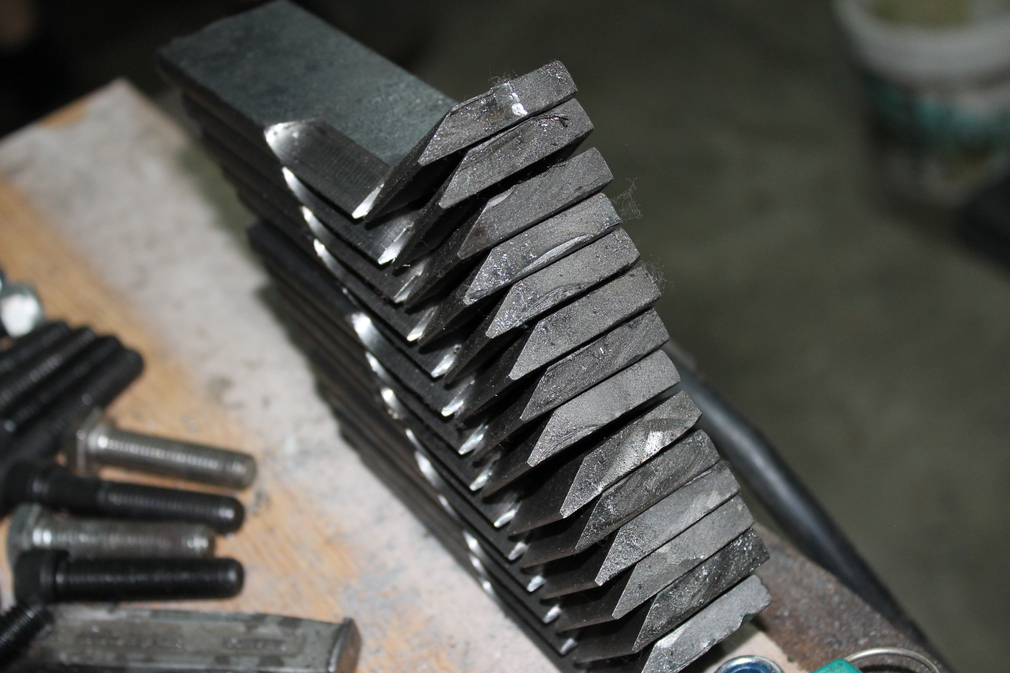

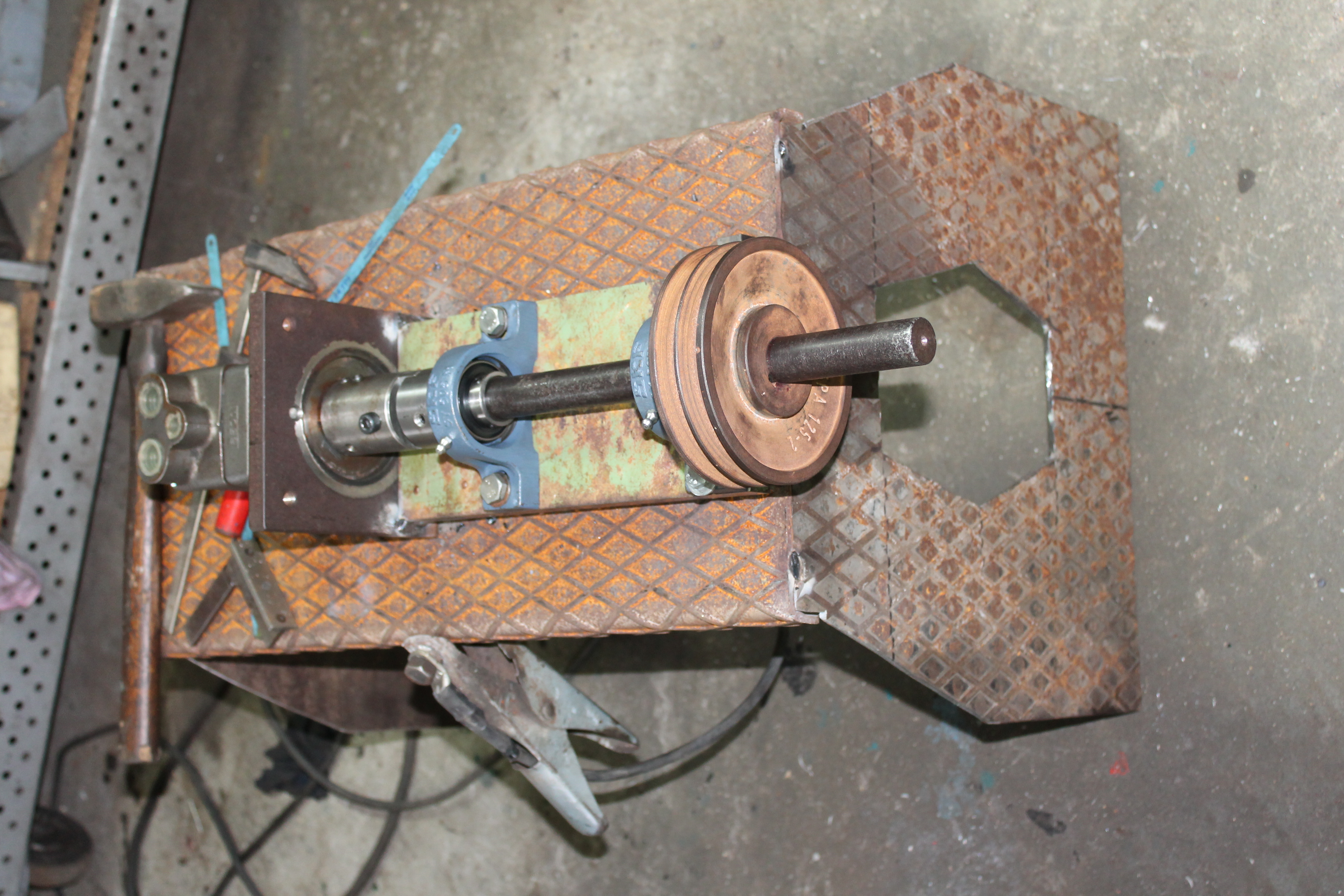

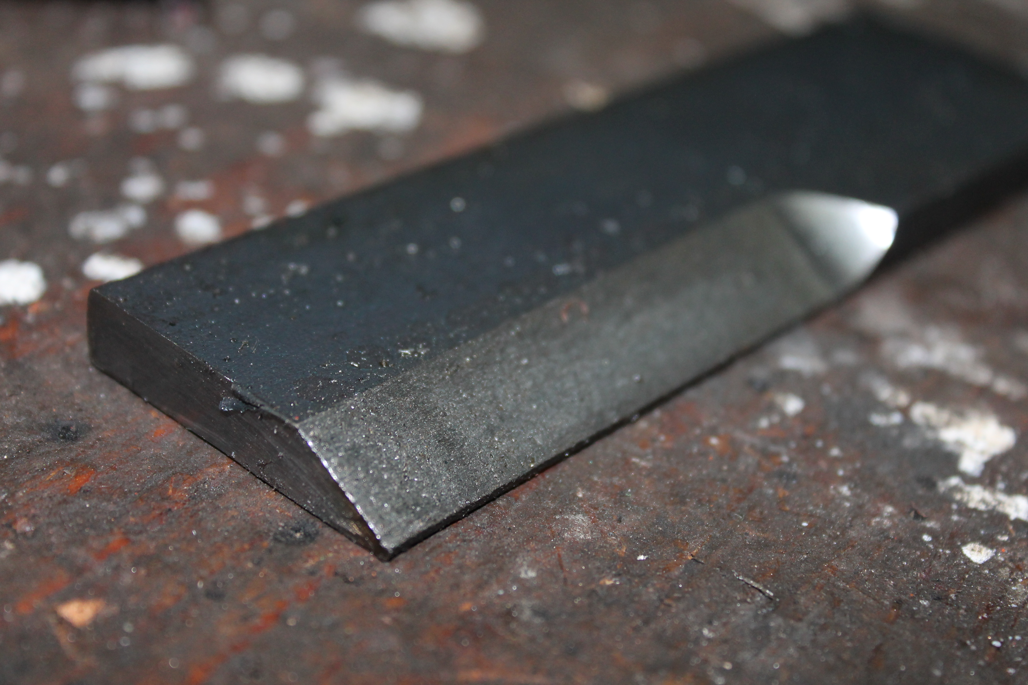

I did built one from scratch for my homemade backhoe a few years back.
Works very nice but I did take the heavy duty build a bit too far but mostly because I had the steel laying around. The flail blades are made of 10 mm (~3/8") thick flat bar, again overkill.
The main frame is 1/4" thick steel, including the belt guard. It's powered by a 0.305 ci Parker hydraulic piston motor, which spins at around 2200 RPM with the pump setup of the backhoe, and I reduced it to around 1800 RPM on the flail rotor via a couple of pulleys. I'm using two A belts on the flail, which turned out to be a mistake. I keep burning belts. The flail has been in storage waiting for its revival for some time now. I will take the V belt pulleys off and replace with timing belts and pulleys so it doesn't slip like before.
Other than the belt issue, the flail does work very nice.
I'll throw some pictures and a video of the build. If you have any questions, just feel free to ask.
