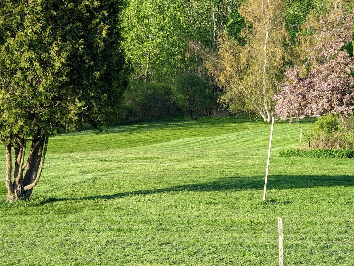

Hammers are definitely tuffer that y blades... and they do pretty good job..as long as your not looking for yard of the month..
   / Flail mower blades #6
My Woodmaxx with the Y knives makes my yard look great! Just look at that cut and striping! I love flail mowers.
