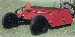

The one thing that you must understand is that wanting a wider cut is not the be all end all for your mowing needs.
flail mowers/flail shredders use a center mounted right angle gearbox connected to the cross shaft which rotates the V belt drive pulley
which then rotates the driven V belt pulley that spins the flail mower rotor to
If you have CRP ground and you only wish to mow it occasionally you have one issue already staring you in the face and that is long stem grass and weeds that can create problems for a standard flail mower with hammer knives or side slicer knives.
With CRP ground that is only maintained a few times per year you need a flail shredder with cup knives.
Please take a look at the Hiniker model 5710 towed 6 foot flail mower. It has a CV joint to allow tighter turns and it operates
with a 540 RPM PTO.
It has a dynamically balanced 32 cup knife flail mower rotor with the high suction lift cup knives mounted on ring hangers that can be replaced with hand tools following the service manual instructions.
It is equipped with 5.5 by 15 inch tires and an overrunning clutch to protect the mower and the tractor.
The Model 5710 flail mower can be equipped with either a ratchet jack to adjust the cutting height or a hydraulic cylinder to raise and lower the mowers cutting height.
The Model 5710 flail mower has a cutting height of 10 inches down to 2 inches in mowing height.

My basic thought with this was he would be a new user and a smaller towed flail mower
with a constant velocity universal joint with the overrunning clutch will offer more protection
for the flail mower and the mule.
A flail shredder with wider cup knives will be even more friendly as he will only have 32 cup knives to worry about.
