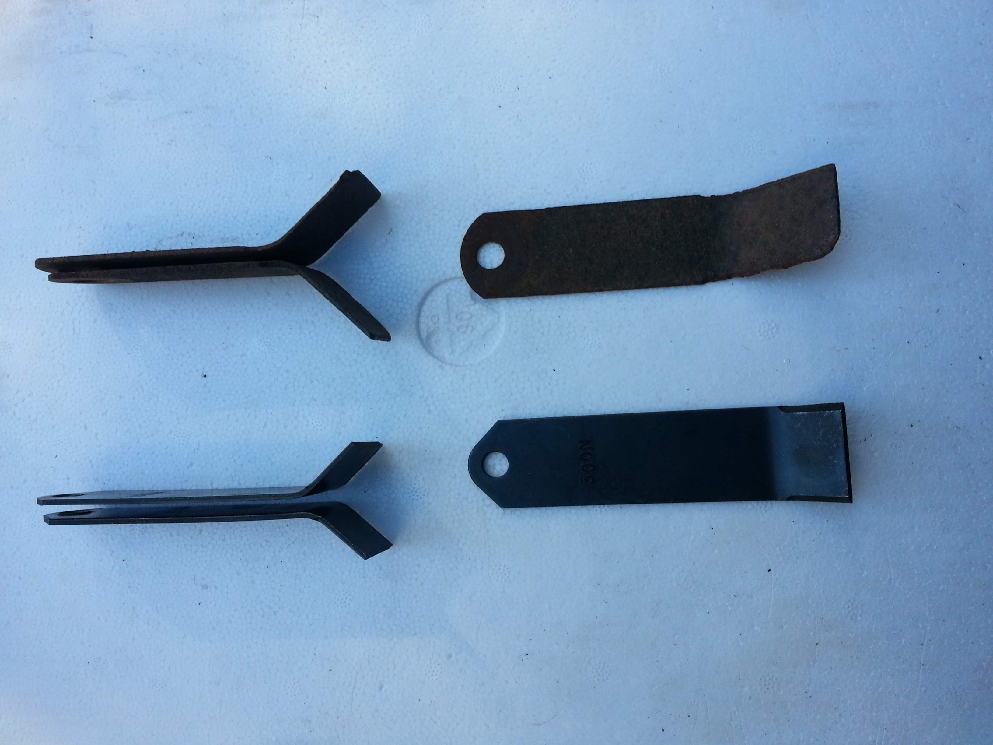

Flailmaster said some people were substituting Mott type flail blades for Ford type blades due to cost. The Ford blades that fit the 917L are nearly $5 each while the Mott are $.65. ($400 compared to $52)
The Mott blades have a more narrow cutting width and smaller hole for the attachment bolt but are the same length. Flailmaster claims the attachment hole is 3/8 inch when in actuality it is smaller and my existing 3/8 attachment bolts would not fit. My options were to enlarge the attachment hole or buy new bolts. I opted for new bolts from Fastenal.
Upon completion of the blade installation I tried the flail in my field which only had grass about 5 inches high. The mower had no problem with this task and left a neat lawn-like appearance. It will probably be next spring before it sees any real tall grass but so far the "transplant" recipient is preforming well and saving big bucks is always great.

Can you post a picture of both the old Ford blades and the new Mott blades?
   / Flail Cutter Blade Transplant Successful, Patient Mowing Fine
The blades on the top are the originals.
