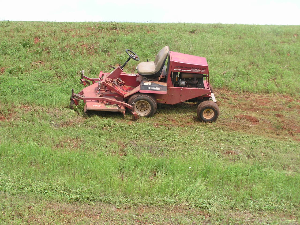

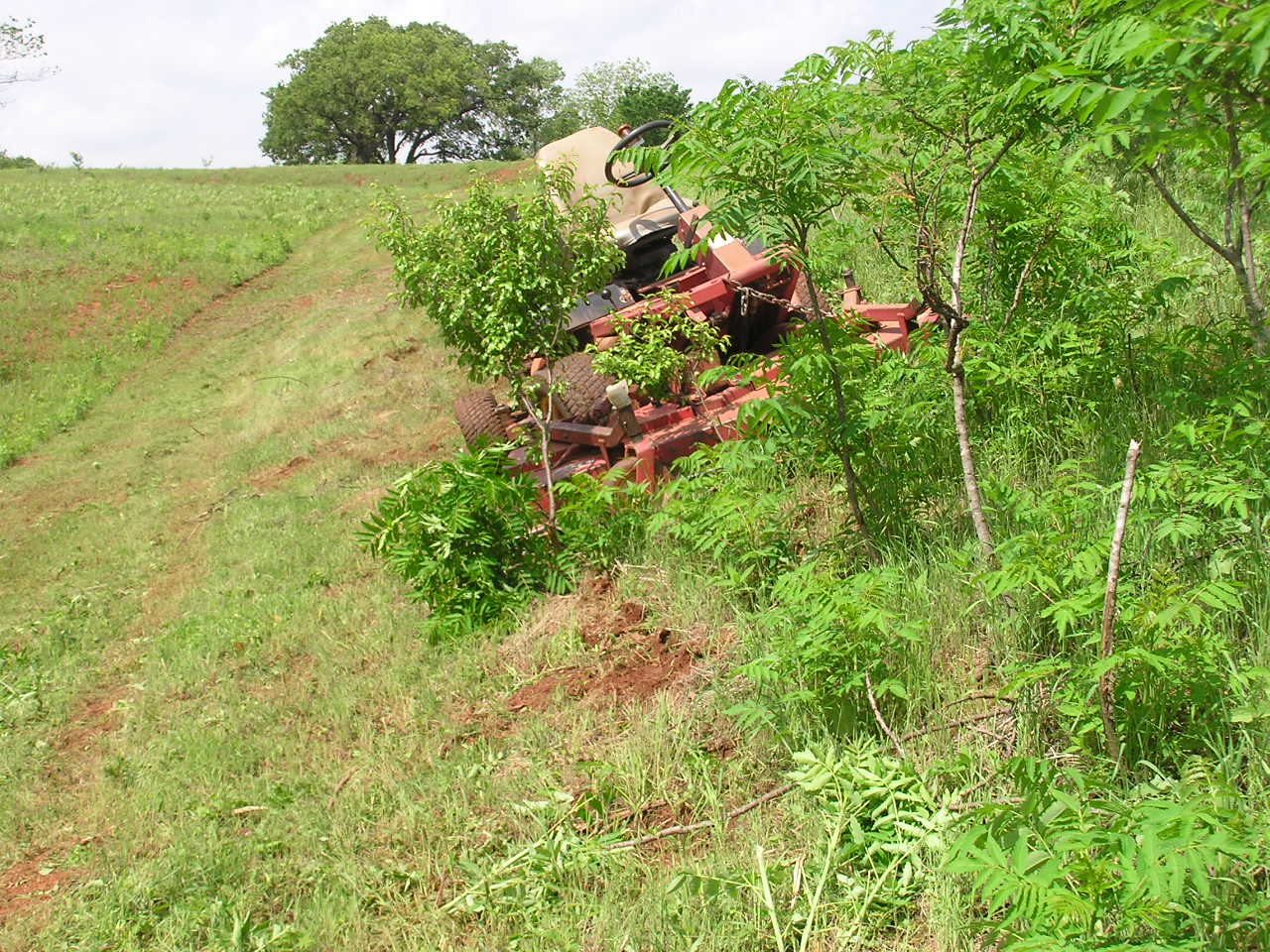

This is what I would recommend, an out front mower deck.
This one is a 1996, with 4WD and a 6' deck.
There several brands available and cabs and snow blowers too.
Kubota is the most popular here on TractorByNet: http://www.tractorbynet.com/forums/kubota-lawn-garden/278809-kubota-f-series.html
