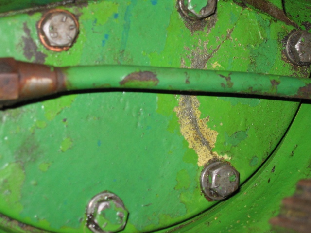

This is my first tractor and its been nice having on our new farm so far. I've enjoyed getting to work on it as well. So far I've replaced a leaking fuel line, replaced the seat (or what was left of it I should say), scraped off about 1/2 of the dirt and sludge so far.
Discovered the main fluid leak on the right hand platform was a cracked steering cover. Part is on order and I picked up a gasket over the weekend. Someone mentioned that this cover will crack because of something not right in the steering column. Can anyone shed some light on this for me? I'd hate to go through replacing the plate just to have it break again because I didn't solve the real problem.
Once the cover is replaced, I plan on changing the fluids and filters, then addressing any other leaks I can find.
Thanks in advance for any help with this project!

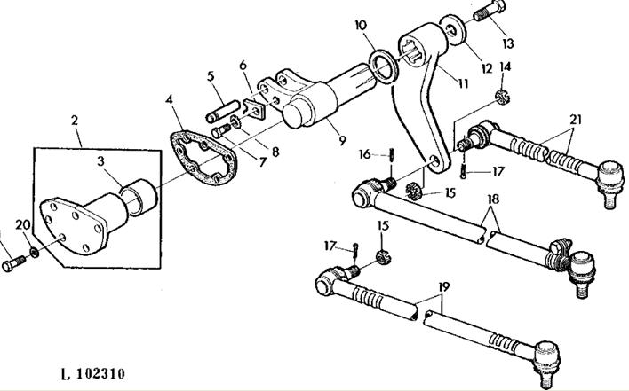

From the looks of the cover, it was broken when tightening down the 6 or 7 bolts.
But it may be something under the cover pushing out (that you can decipher when replacing).
The cast won't take much bending from unequal bolt pressure (just a thought).
Appears to be more than just a cover, but holds the bushing and the end of the steering arm.
Maybe something to how it works, and a chat with a Deere mechanic may bring up some pointers.

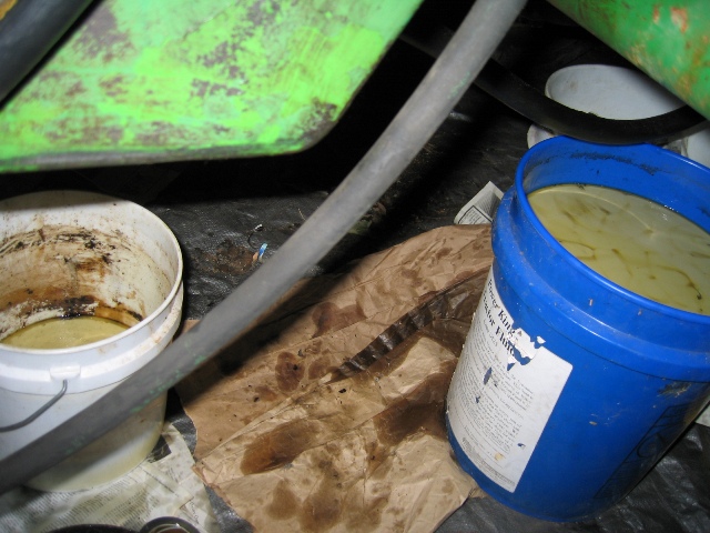

Draining hyd fluid and have the cracked steering cover off. Hyd fluid is very milky. Fluid coming out from under the steering cover has a lot of water in it that is separated from the already milky fluid. Put my hand in and there's a pool of water in a low area in there. Is there a drain for it? There's also sludge and metal shavings.
Also, I can't budge the screen plug next to the hyd filter. Any suggestions?
Thanks!

You just might have your answer to the cracked cover. If that cavity behind the cover was full of water when you had freezing temperatures, the expanding ice might have broken it. There shold be a plug below that cover on the side of the clutch housing that will drain that cavity.
On the screen plug, take a flat faced hammer and smack the plug a good strong whack or two and the plug should come out easily. Be sure to inspect the screen for brake facing material. Water in the oil causes the lining to separate from the disk and fall off. It ends up clogging the screen.

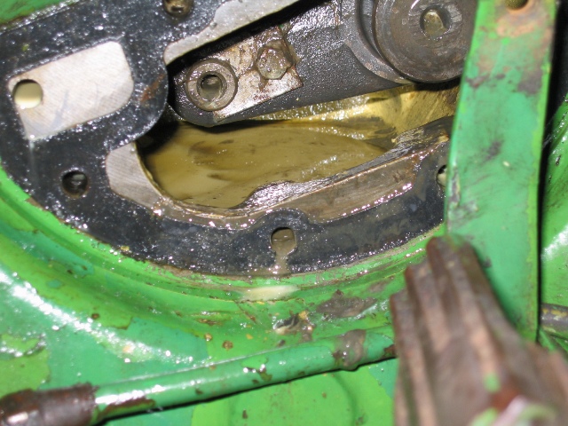

Couldn't find a drain anywhere for the area under the steering cover. I got it out by hand the best I could then wiped it out with newspaper. Pic is before I cleaned it. Its yellow on top, but very gray under the top layer. Doesn't look too bad now that its cleaned out.
There's some play in the steering wheel and when I move it, there is some orbital type movement in the cylindrical piece. There doesn't seem to be any play in it as is...only when I move the wheel. I'm concerned this may crack the replacement cover.
No idea if how I'm describing this makes sense, so if there's any clarification needed, just let me know!
Thanks!

The boss just below the cover is where the drain plug for that cavity is on my 2030. Looks like they they stopped putting a drain plug in with the 40 series.
On my 2030 I found the most steering slop was from the bellcrank the draglink and tie rods connect to. I could see no easy way to fix it so I live with the slop.
Ditto on ice causing the break. I do not think overtightening it would do it.
