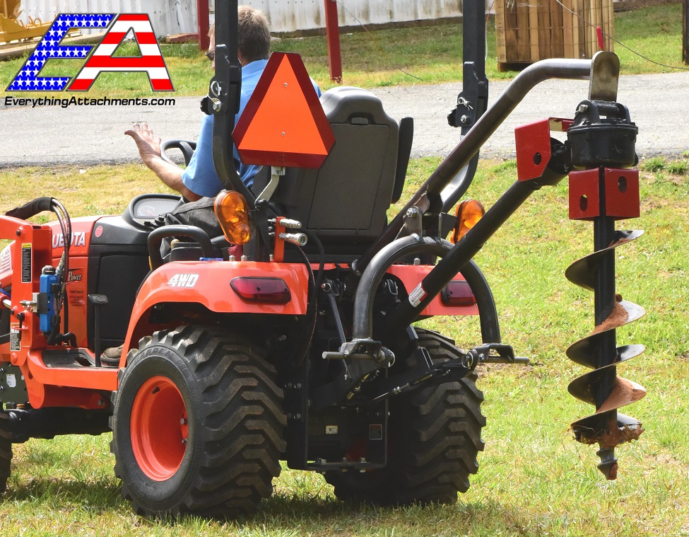

For years, we've been making our 3pt. EA Post Hole Diggers for tractors ranging from subcompacts up to larger utility sized machines.
The EA Compact PHD was designed to work with small tractors like the B & BX Kubotas. It has worked.
It gets the job done and allows enough clearance for you to use a 48" auger, even on a BX, but can be quite a strain for those little tractors in certain conditions.
If you've used a rear PHD, you know the conditions i'm referring to.
The EA Compact PHD hooks up to the BX without any interference and functions properly, however, there is room for improvement.
The extended boom length extends the center of gravity and is pretty tall, so augering dirt out of a 48" hole can be challenging.
We want our attachments to be IDEAL for the recommended tractors, so now you know the mission.

Here's what we started with:

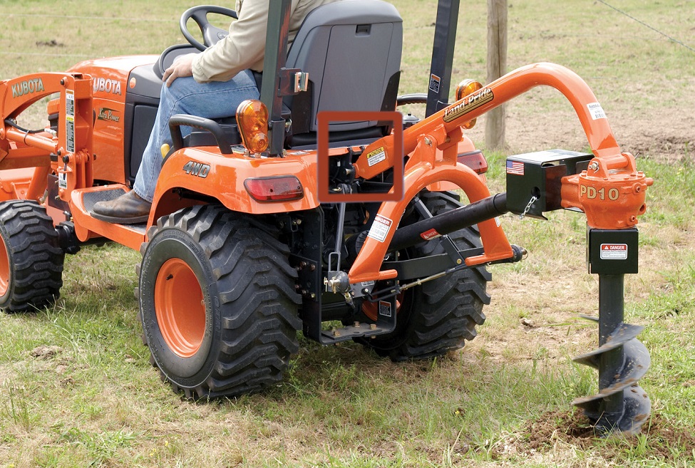

We started out by picking an existing PHD which is sold specifically for the BX by Kubota dealers.
It looked like it would be a great match, but, after installing it, we discovered it wasn't such a good fit.

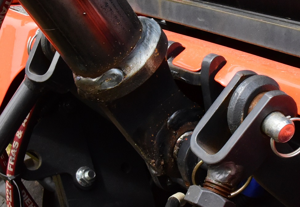

Problem #1
The tubing on the tractor end of the boom, by design, is compressed together and welded, resulting in this:
When we raised the lift, the boom caused stress on the BX toplink bracket on the tractor and bent it.
If you look inside the red box, you'll see why. Notice how close it is, even when the hitch is somewhat lowered with the auger in the ground.
   / Fixing our BX Post Hole Digger #6
What is your fix for this?
Here's our fix. This is with the lift raised up all the way.

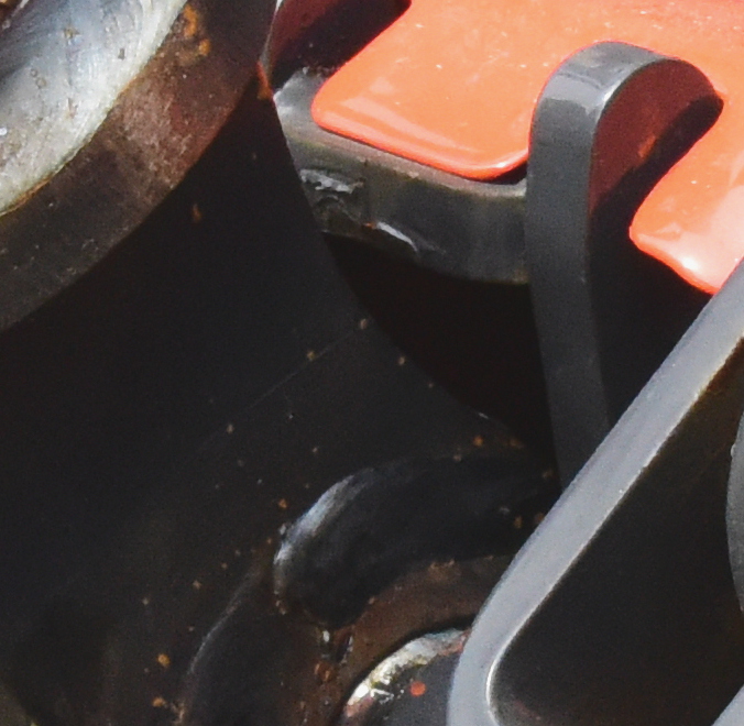

In this zoomed pic, you can see where the LP boom came in contact with the bracket.
This is not from using the post hole digger, it is only from hooking it up and raising the lift.

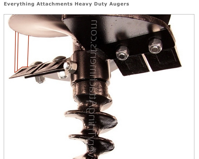

Feel like experimenting with a tooth design?
I saw an auger with this design, probably in an Eastern European Youtube video, but I can't find it again.
The tooth is sort of an "L" shape, with the vertical part reaching to or near the next flight. This may stop the problem of screwing the auger into the ground, and may make a smoother sided hole. Probably would be needed on both sides. This might be a bolt-on replacement, or the "L" tooth may require a redesign of the auger bottom.

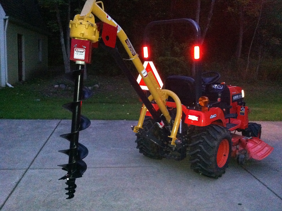

Something else we didn't like is that you have to spread your lift arms out SO far to hook it up.
It looks like someone had the right idea with the pins toward the inside, but didn't follow through.
We followed through and built a true Subcompact Tractor post hole digger. It hooks up much easier, fits perfectly and produced excellent results in our red clay soil.
