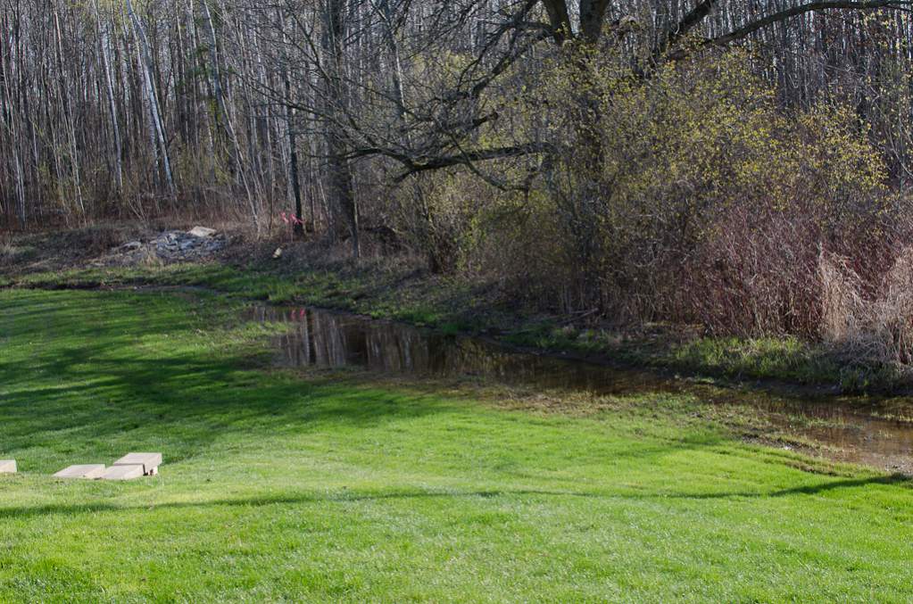

Strange question for you...
Over 100 acres of farmland drain into my back yard. There is a slope where the water is supposed to go, and continues in a creek for a long distance (don't know where it goes) around a bend. (Photo of back yard and bend attached)
My house was built recently and the slope of the yard was changed in some places. The result is that water now sits in my back yard. It's as deep as 8" in some places.
Last weekend, I took the tractor back to the bend to get it dug out a bit to get the water flowing again. This was easy work for the FEL. The problem is, my turf tires got covered in dirt/clay, and were rendered completely useless. I had to use the FEL to push my way out, making a big mess.
I really need to get the tractor up to the creek to fix the problem areas, but I'm not sure how to get traction. One thought was to use pallets if I could get some, so that I could put those next to the creek and drive on them. Another thought was to use some boards.
This BX2660 is my first tractor, so I'm looking for any tricks of the trade. To get over a muddy area.

I wonder if you guys are overestimating how big the sides are. I may not have been very clear. If you look at the far left side of my photo, that's where I got stuck. This is a 1ft drop over a 4 foot span. I even got stuck in a flat part of my yard that was a little more wet than I thought. A spot that I had mowed earlier in the day.
The section I did was a piece of cake, just used the bucket to push open a small channel.
Am I really crazy for thinking this should be easy for the Kubota? I understand chains and weight are key to getting any traction in mud.
I like the mulch idea. I didn't think of that. I suspect if I covered the mud in mulch I would be good to go.

My thought, exactly. Looking at the photo, there are lots of trees along the edge of your yard. All you need is a few big roots to really stall your ditching project. If you can build up the low spots so that drainage occur on the other side, I think your will be much better off - and able to mow without getting mired more often.

Thanks for the help everyone. Today was much drier, and I was able to get in there and open it up without issue using the FEL.
In my back yard, I just used a spade shovel to open up a channel and get it to drain into the deep part outside my yard.
That mud really does neutralize the turf tires. Thanks for all the traction ideas.
