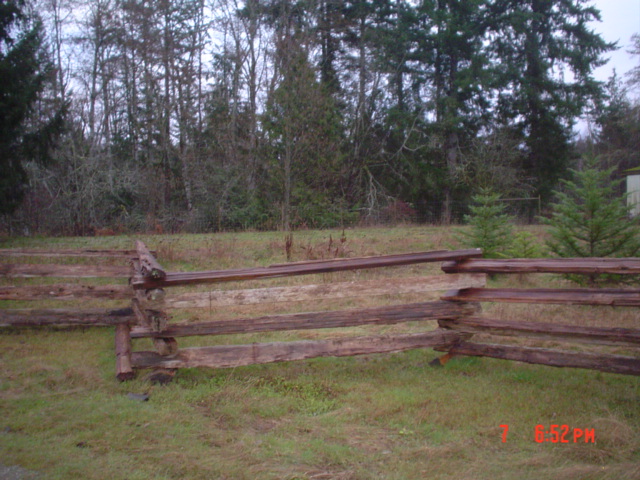

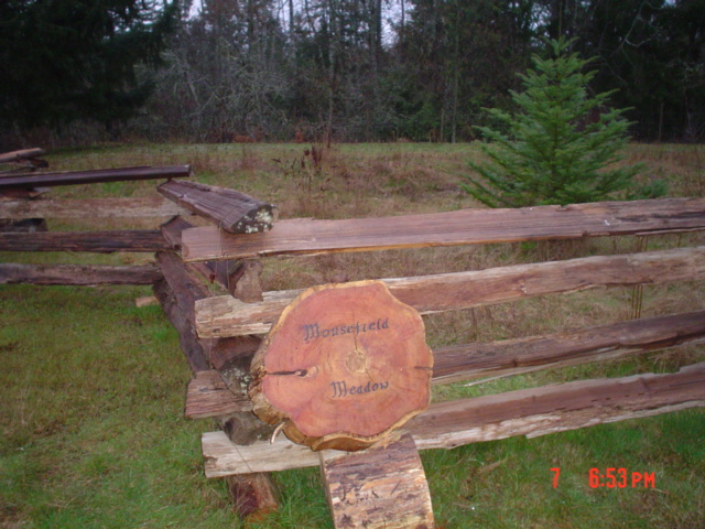

I'm currently fencing an area of paddock that will be used for horse pasture. Some of the ground has shale only a few inches below the topsoil and the shale is too deep to break through for posts. I'm thinking of using split rail cedar snake fencing in these areas so I can abandon the posts. I'll have around 100 feet in all.
There are some illustrations of split rail fencing for stock online but there's none around our island. As it's likely to suffer a deal of wear and tear from contact with the horses, I thought I'd ask if there's anyone who has used split rail fencing for this purpose and how it stood up.
Most of the cedar snake fencing I've seen is fixed using long galv. spikes, olylog fasteners or rebar. Any tips or advice on how best to secure the rails so they're not a running sore in terms of maintenance would be appreciated.

We have some cedar fencing but only for decoration. Tied it with wire to keep it together. I know up in the Cariboo area, were we used to holiday, they use a lot of it, some for live stock including horses.
You could use, as you mentioned, long spikes or rebar. I think if you tied it well with wire it would stand up to hard use. :)

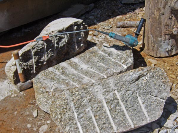

Anchor points or hold downs could be made by drilling a rebar size hole and then cementing in the rebar.
All it would take is a 1/2 inch rotary hammer drill and a long bit of maybe 3/4 inch size.:)
Even just a plain rotary drill would work. Would not take much for a trial hole.
Picture shows my rotary 1/2 in Makita drill and some holes made in granite.
