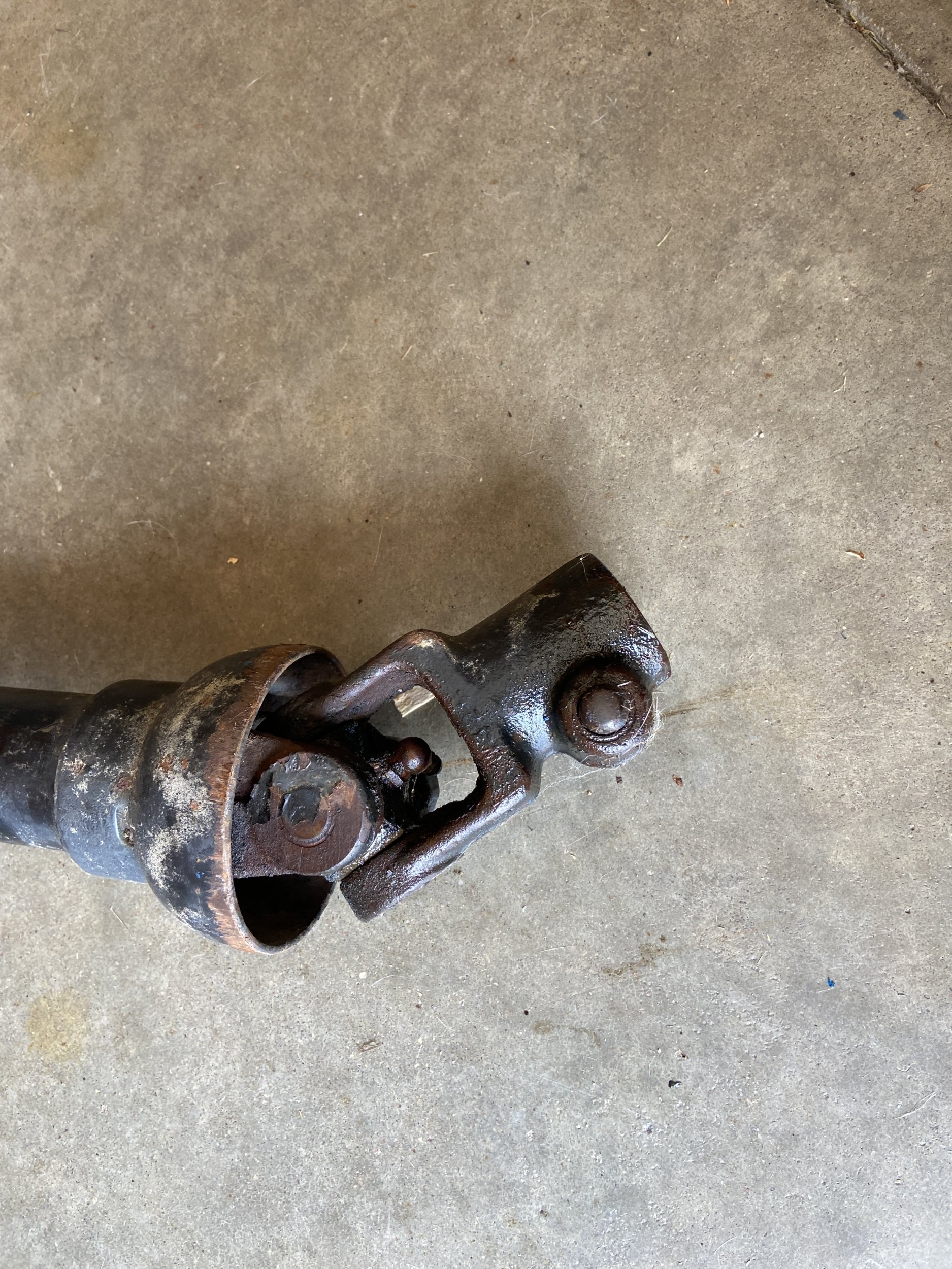

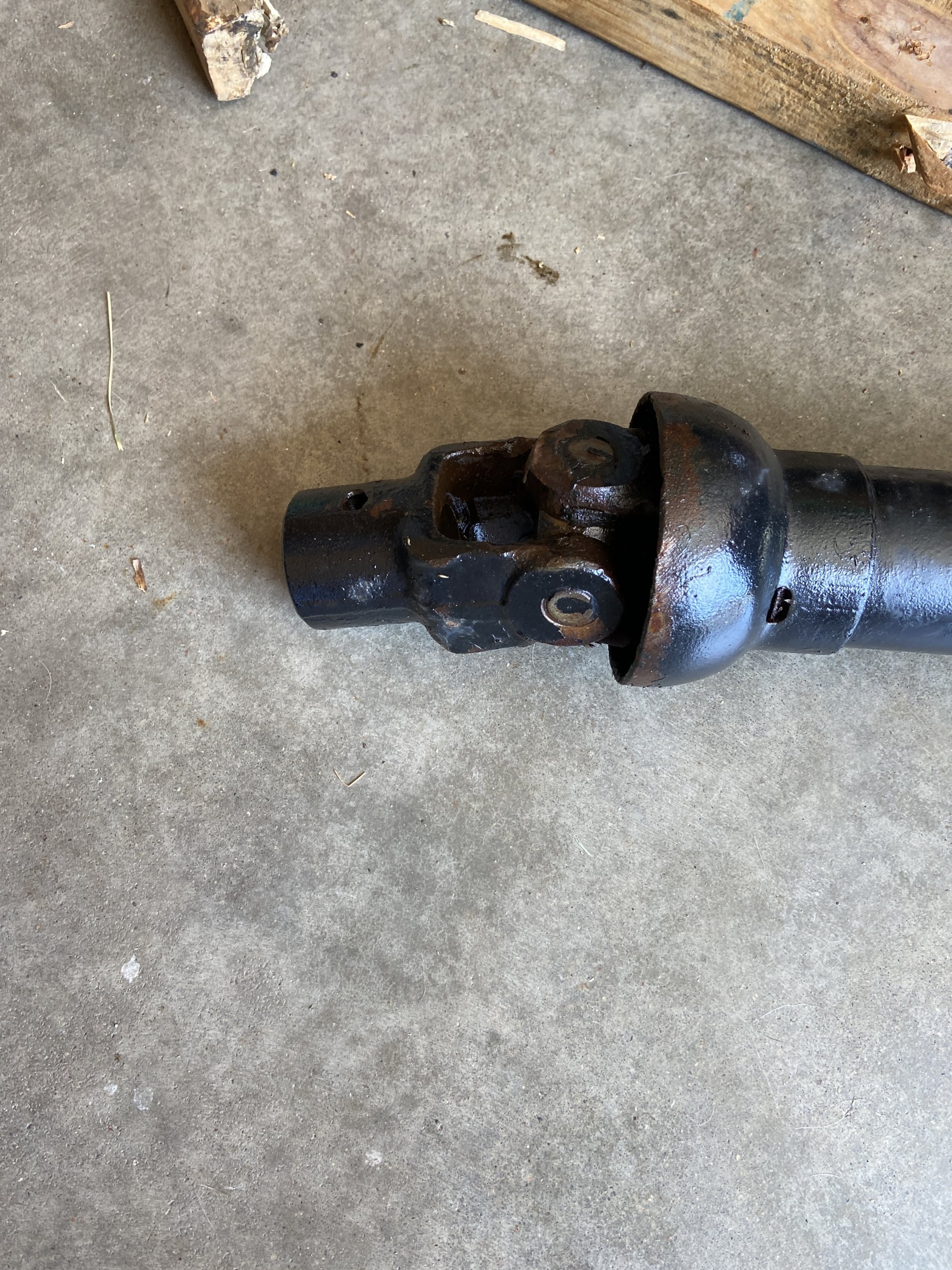

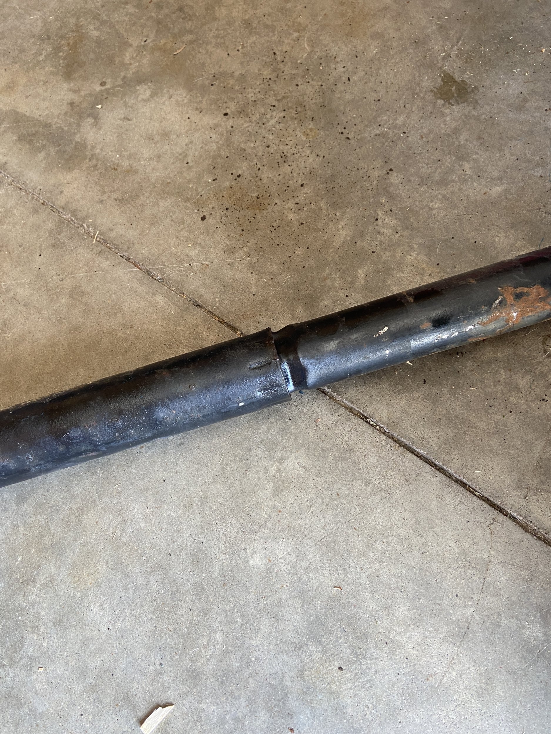

/ Fixed length PTO Shaft?
Here's the photos of each end and the joint. The joint is crimped tight and will not come apart. Also interesting is the only identifying mark on the post hole digger is a number on the gearbox, 202298. It also has a 1-1/8" input shaft which seems to be non-standard. All of the round input shafts I've seen for sale are either 1-1/4 or 1-3/8 inch input. I think I'll need to talk to a PTO shaft company like Weasler to see what my options are. I'd rather not dump $300+ into a gearbox for this thing which puts me at the price of a new one, $350 for the post hole digger + $300+ for a gearbox.
Thoughts, comments?
/ Fixed length PTO Shaft? #9
To me, the middle picture showing the "crimped" area sure looks like a larger (left) tube and smaller (right) tube of the guard. Why is it crimped there??? Who knows. Had the shaft been broke or bent???? It is an old shaft for sure with that style u-joints.

yeah. So now I'm looking for a round bushing 1-1/4" to 1-1/8" so I can buy a PTO shaft assembly off the shelf vs put together from parts
