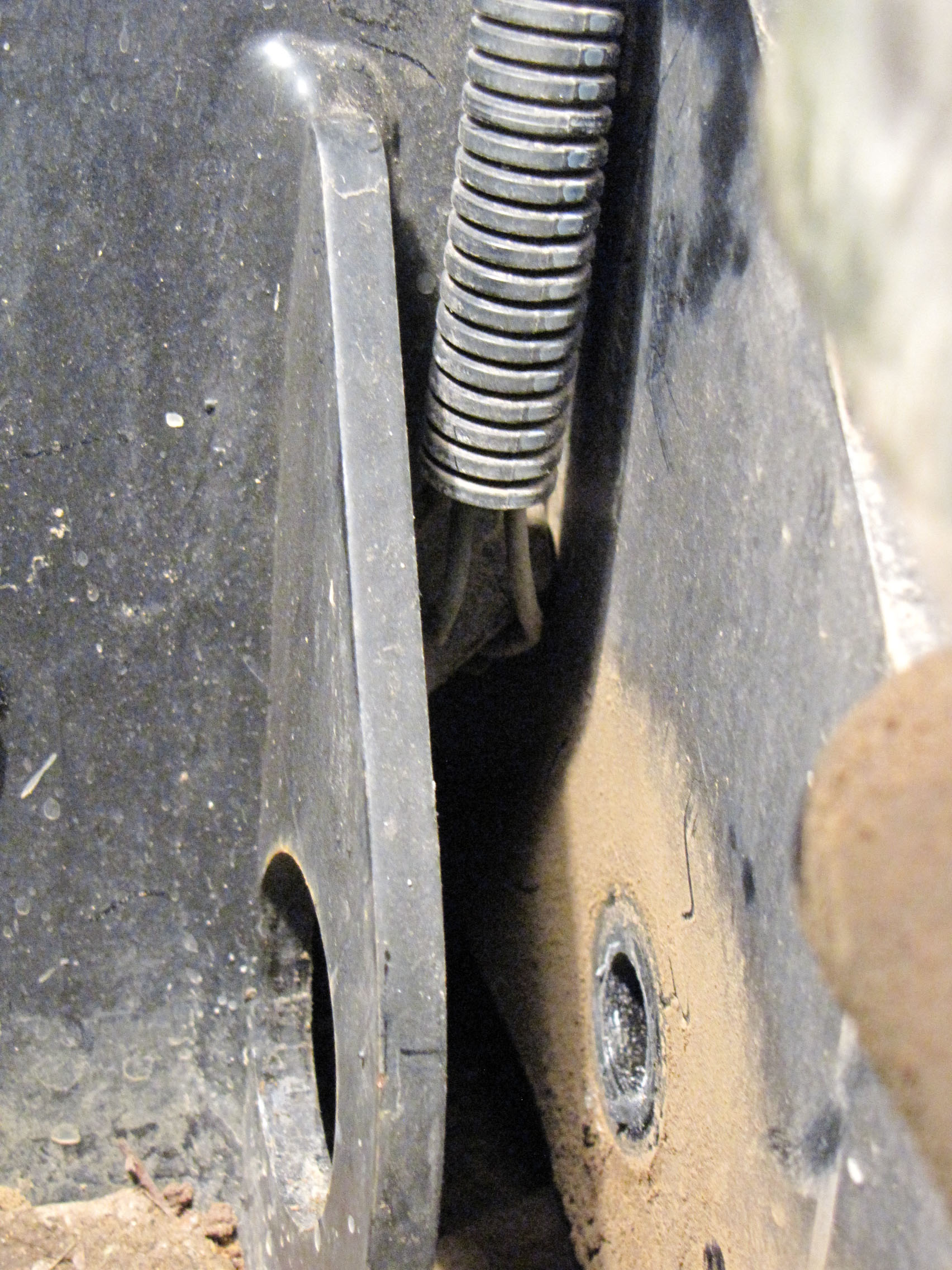

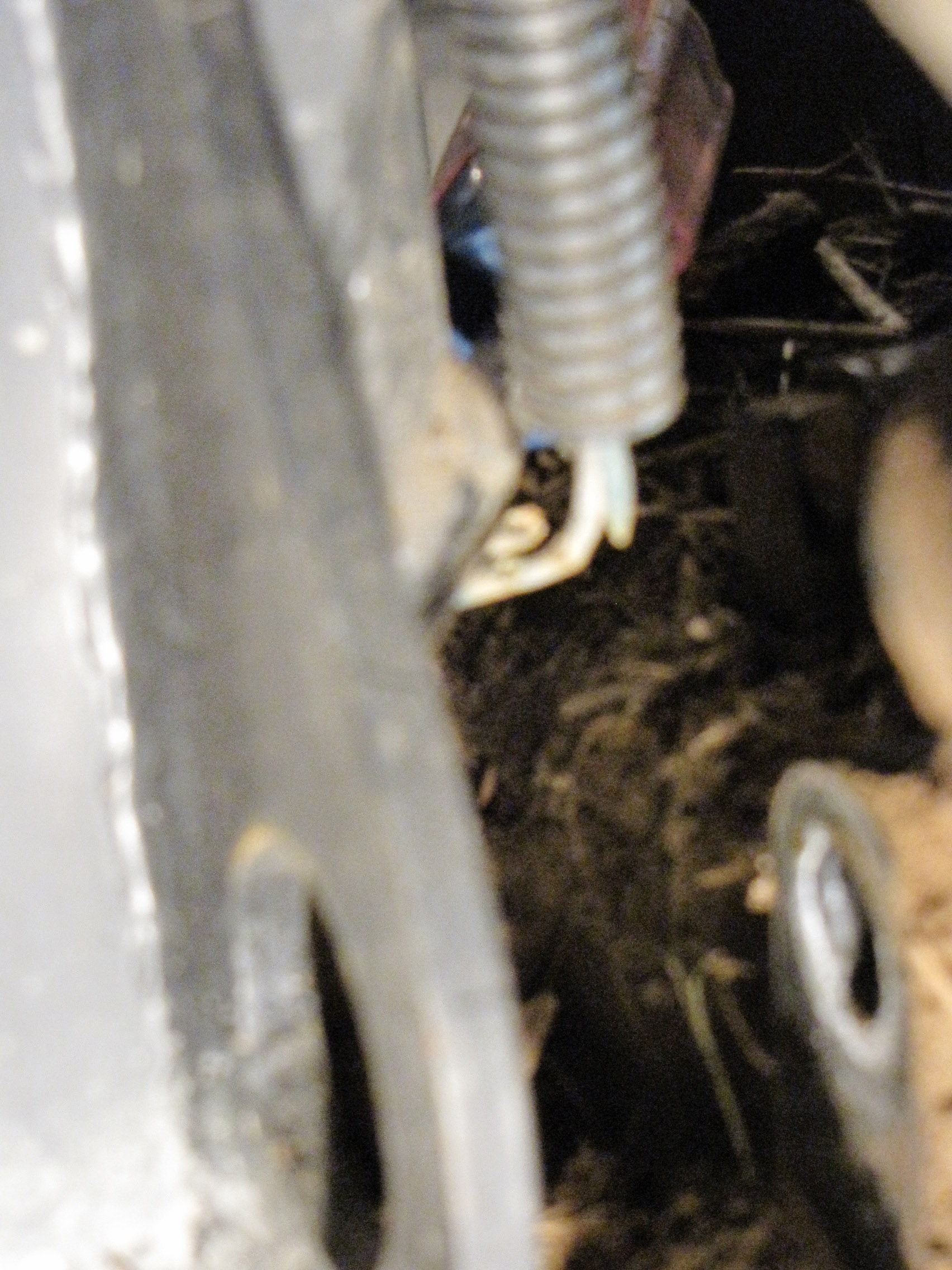

The errors had been off/on for 4-5 months, so I dug into it a little deeper and found error 61/65 to be broken wires going to right blinker and brake light. Dealer had installed the 447 backhoe in Jan 07, the installer had pinched the green (right blinker) and black (ground) between right side plate and axle. :mad:
I had to take the fender off and also the 447 plate. Took me around 3 hours to fix, works great now. :D Glenn
Plate on / plate off

Good work and I am glad you found it and were able to fix it.
