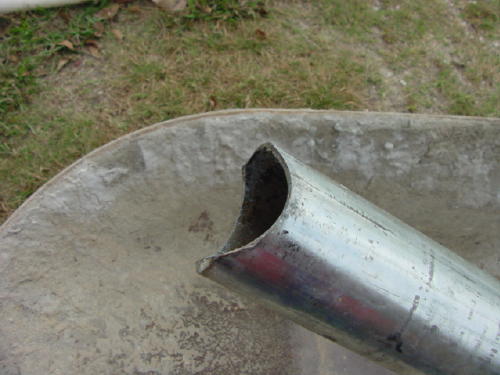

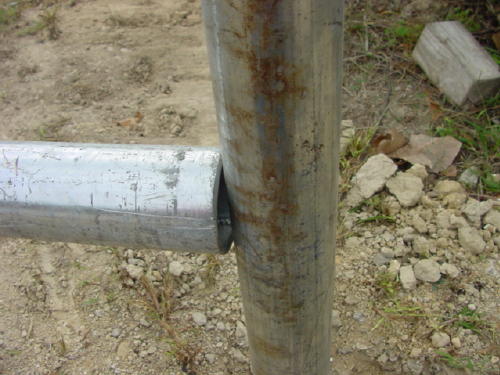

An attorney friend was trying to explain patents to me. The way he put it was along the line of skinning cats. There are lots of ways to skin a cat. If you have a unique and innovative way it's patentable.
These are not patentable ways of fitting pipe. /forums/images/graemlins/grin.gif
I have a Vogel pipe notcher that works wonderful. It just so happens to be mounted in a punch press sixty miles away. The pieces I need to cut are here.
Here's the finished joint I want.

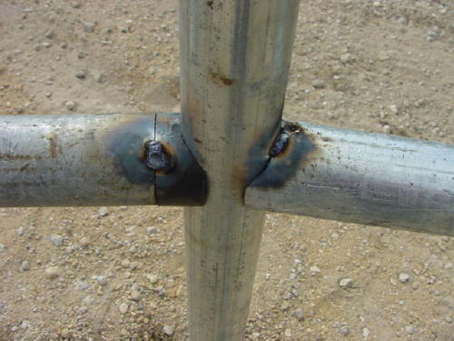

Here's an example of what the Vogel does so well.

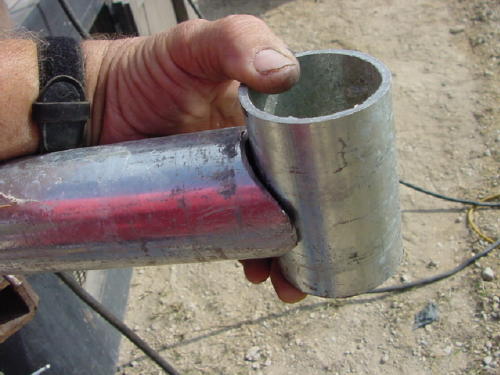

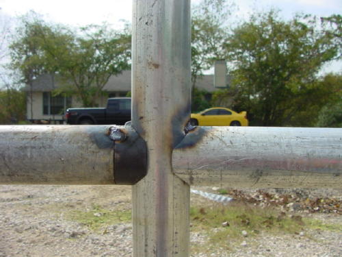

Here's the joint without a notch. Now some folks smash pipe to get more welding area. We don't say what we think about those people. It isn't polite. /forums/images/graemlins/blush.gif

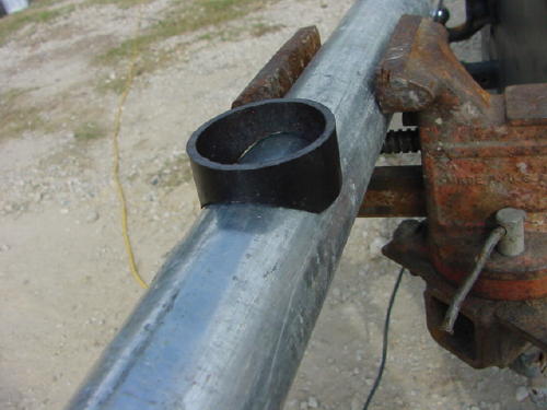

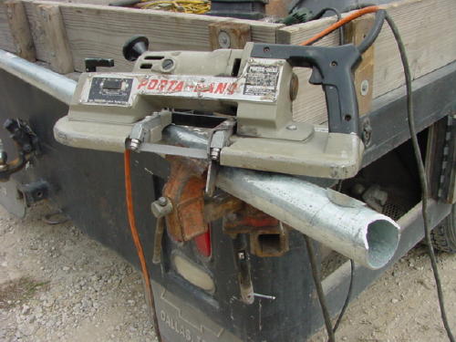

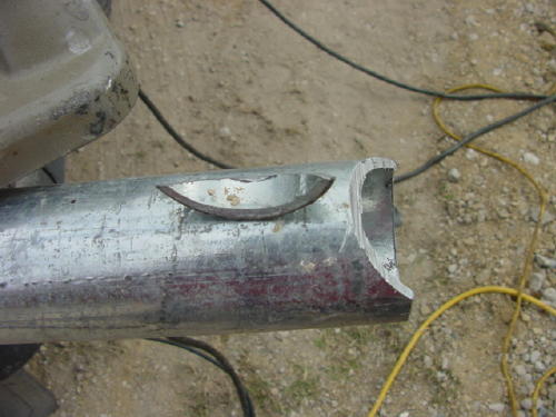

This is an alternative I use quite often. Let's say I've only got one joint to cut in or as in the case today, five or six joints, but the notcher is in use elsewhere.
If you look at the previous picture and follow me for a minute I'll explain.
I measure the space between the outside edged of the pipe joint when they are in that position.
Let's say it's five eighths like it is here. I take my Portaband and start a cut five eighths of an inch at an angle to cut down approximately one third of the cross section of the pipe.
I want it to look like this.

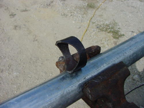

   / Fitting pipe aka skinning cats
Did you notice how the vice slides into receiver hitch inserts welded into the corners of the bed? That's handier'n a pocket on a shirt.
I then roll the pipe over and make exactly, as close as possible the same cut on the opposite side of the pipe.
This can be done with a torch, a hacksaw, sawsall, chop saw, even a quick saw if you have a metal blade.

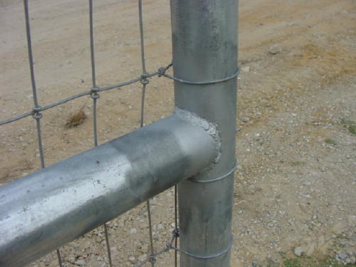

Just a brushing with an angle grinder and you have this fit. Even someone with Ray Charles' talent for welding can sew up this joint.
