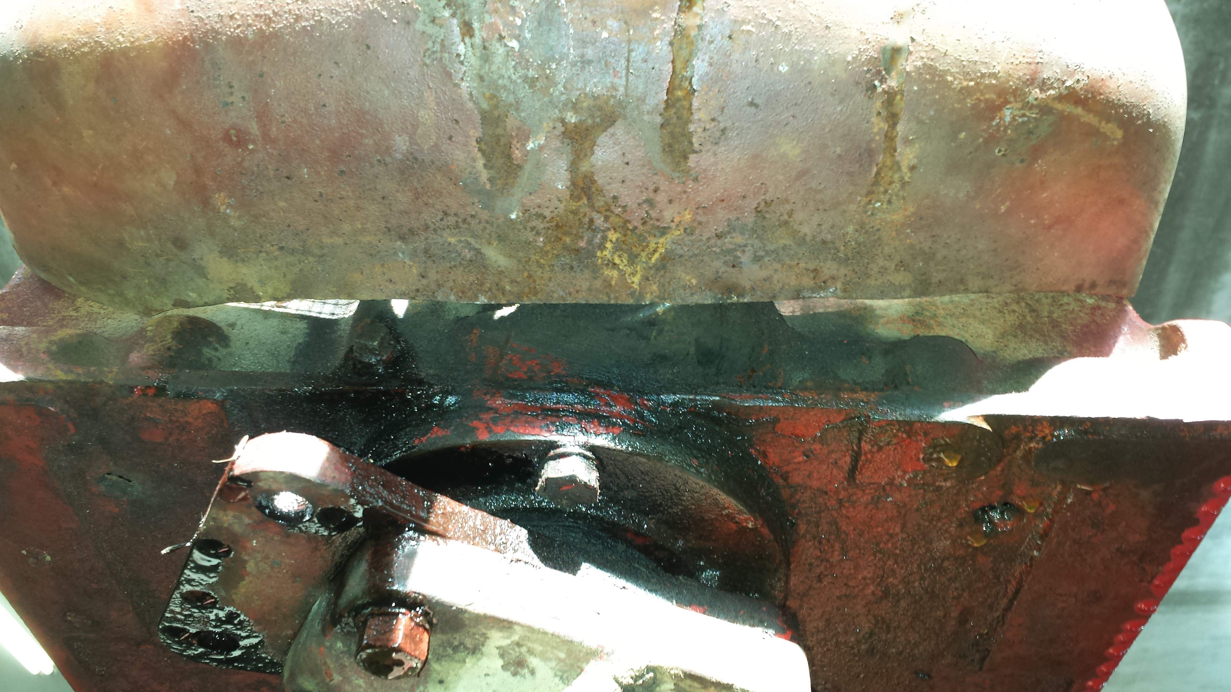

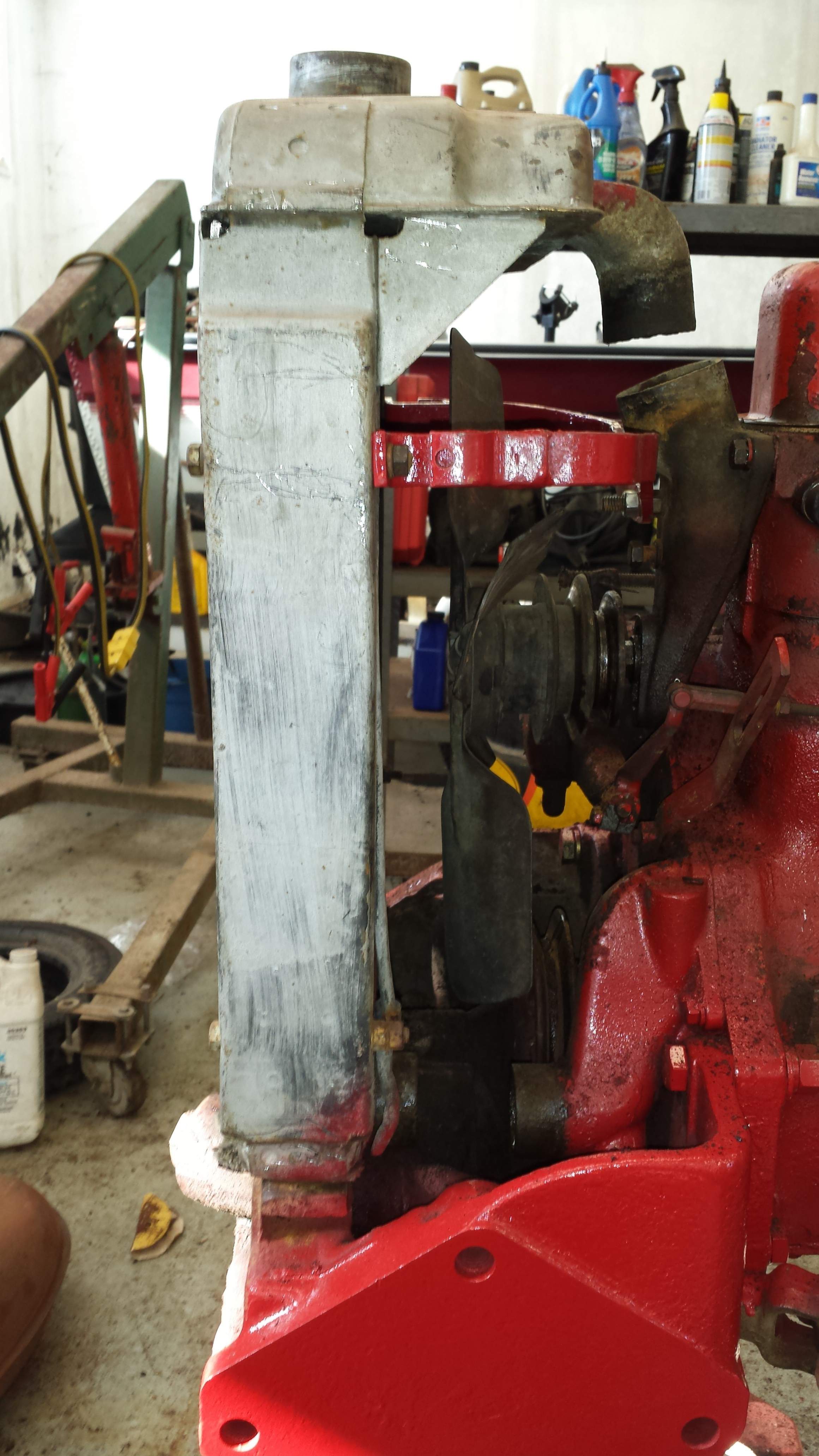

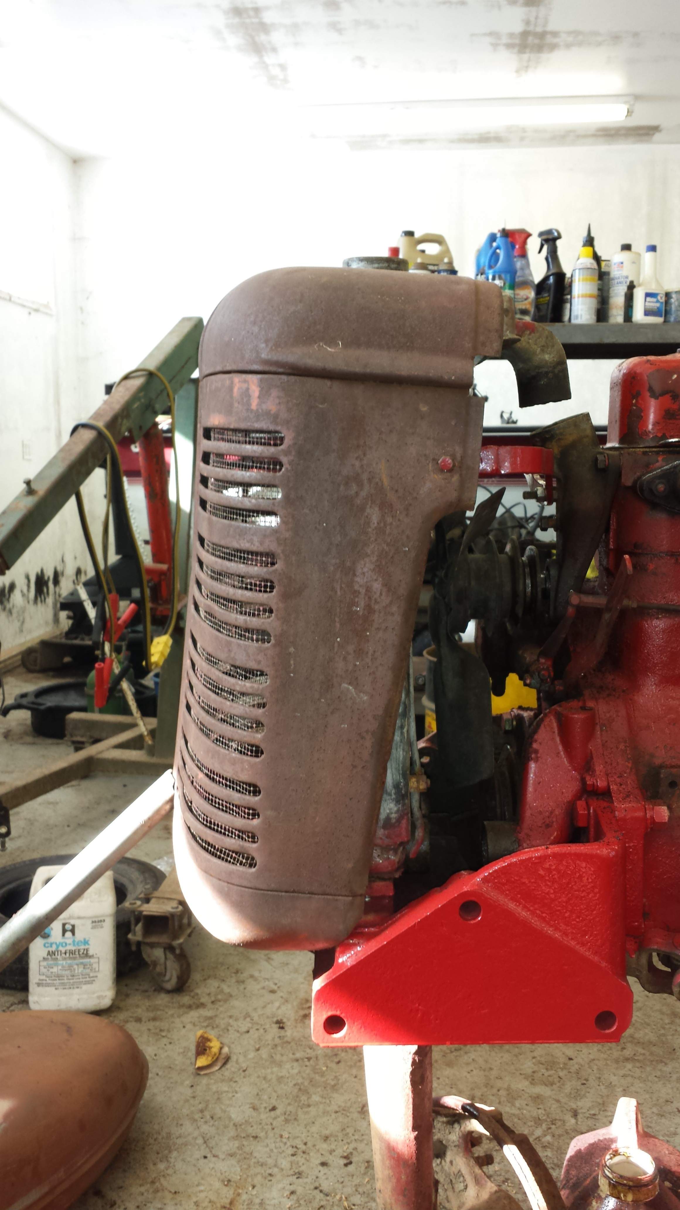

I'm restoring a C and purchased a used grill in really good condition but the lower section doesn't seem to fit well with the steering bolster casting. the grill face isn't vertical when viewed from the side. Do these lower sections have to be custom trimmed?

Thanks, the pictures help, mine is apart right now, I did quick test fit and then took it apart including the radiator. I noticed in the photos that the angle of lower section of your grill matches the angle of the steering bolster. Mine doesn't look like that. I'll try to post some pics. I wonder if it's a different model or maybe model year.
   / Fitting a Farmall C grill
Thanks, The top mounts of the grill seem fine, they line up good with the bolts in the radiator for the upper radiator / grill support. Just the lower section fouling the bolster casting

Without even seeing it, sounds like a grill for an A. One for a B or BN may fit as it has a similar narrow front bolster.

Thanks, My neighbor has an A that I can look at. The bottom piece on my grill definitely doesn't look the one on my dad's super C.

See attached photos. Guess I have the wrong grill.
