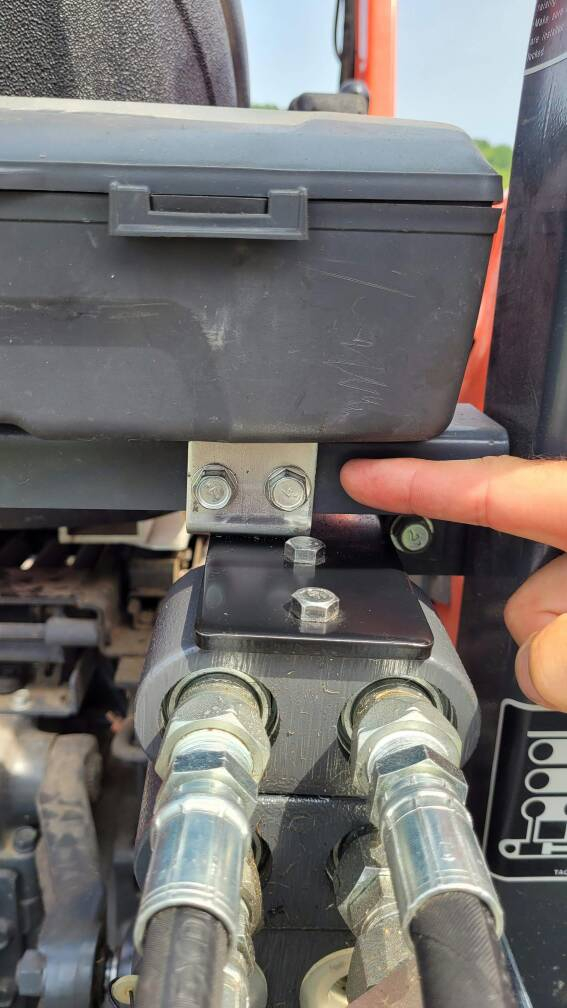

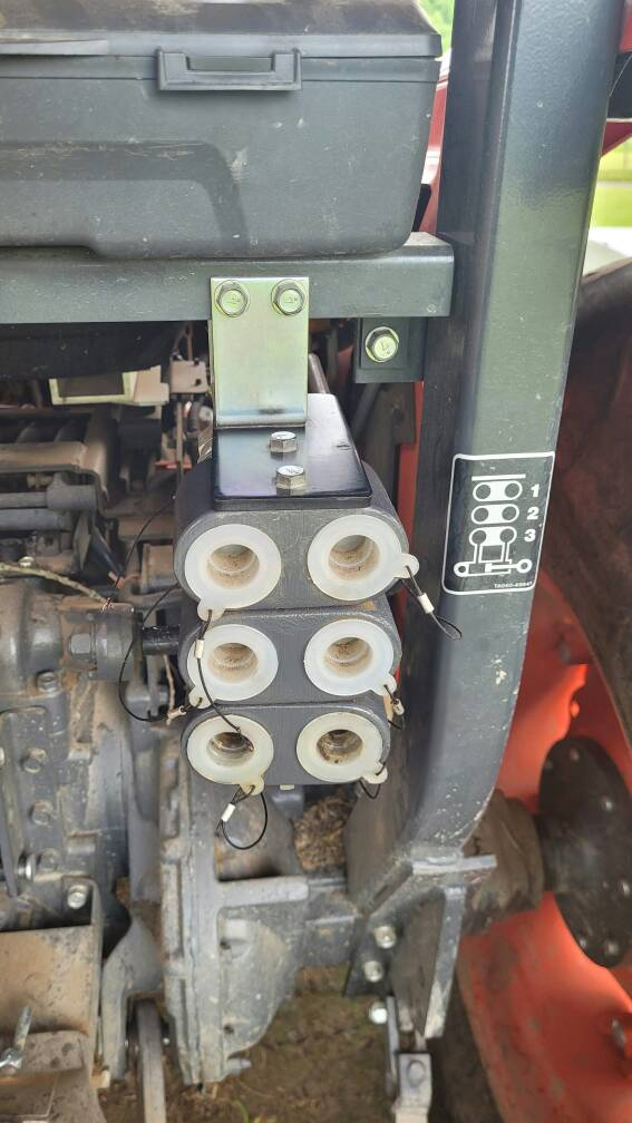

Additional Modification for the TnT Install...
As background, the Top and Tilt cylinders built by Brian at FitRite for the MX6000 provide a large amount of movement, with the Top Link having about 12 inches of adjustment and the Tilt having about 8 inches of adjustment.
Combined, they provide a substantially increased range of motion, further extending the range already existing in the 3pt hitch.
The MX also has a Land Pride 1.5 Quick Hitch (QH), which seems to work reasonably well with most of my implements.
The additional movement introduced by the TnT resulted in the Quick Hitch easily coming in contact with the hydraulic Quick Connects plugged into the Rear Remotes when raising the 3pt hitch. It was something I had to watch pretty closely.
To help reduce the risk...
I ended up cutting off about 1.25 inches of the Kubota provided silver mounting bracket used to attach the Rear Remotes to the tractor, just under the tool box. I had to redrill the (2) bolt holes on each side. (Before and after pictures are provided with my finger pointing to the silver bracket).
This effectively raised the Rear Remotes by about 1.25 inches from original.
Kubota also provided a black plate just below the silver bracket (as seen in the below photos) which the Rear Remotes are physically bolted to.
I drilled (2) new holes in that black plate for the mounting bolts which attach it to the silver bracket, which moved it inward, towards the front of the tractor.
This effectively moved the Rear Remotes further under the mounting rail (further away from the Quick Hitch) by maybe 3/4 of an inch.
Combined, the two mods provide enough clearance to remove most (but not all) of the conflict between the Quick Hitch frame and the Rear Remotes.
...The operator still needs to be aware to not raise the 3pt hitch up to the highest level if the Top Link or Tilt rams are retracted to the max...damage can still be done!
But the risk is worth it!
Before and After pictures are attached below.
Hope this helps somebody in the future...
