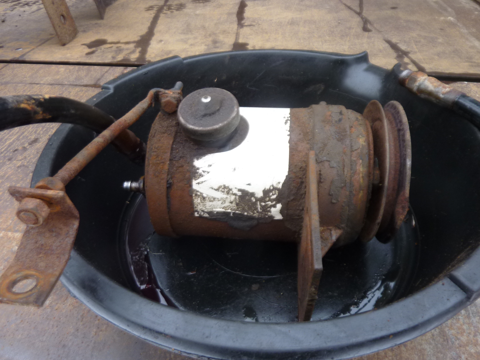

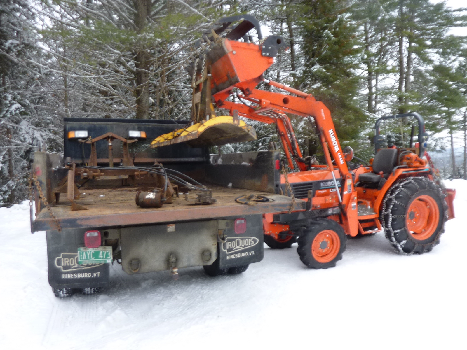

I have acquired a 1990 vintage Fisher Under the Hood plow system. I was after the blade and A frame but the guy wanted it all removed so I took the push plate, pump/tank, valve, and mechanical joy stick too. It all works, at least it did. Now I am wondering what I might be able to do with the valve and/or pump but can't find any info. Like is it open or closed center system, pump RPM vs flow characteristics and max RPM, and HP drive requirements. The old label is unreadable. There is no electric clutch on the pump. Probably someone here remembers these and can shed some light. Thank you.
I did find that the pressure is probably 1750 psi and the cross over relief is probably 4000 psi. Just common Fisher numbers so it's a guess.

Good Morning Gordon,
From what I remember they were open center hydraulic systems which made them very simple to own and operate. As old as the hoses are your going to want to replace them as the rubber inside the hoses will have deteriorated and become brittle.
The rubber can flake off and cause problems with the control valve poppets on your front end loader.
