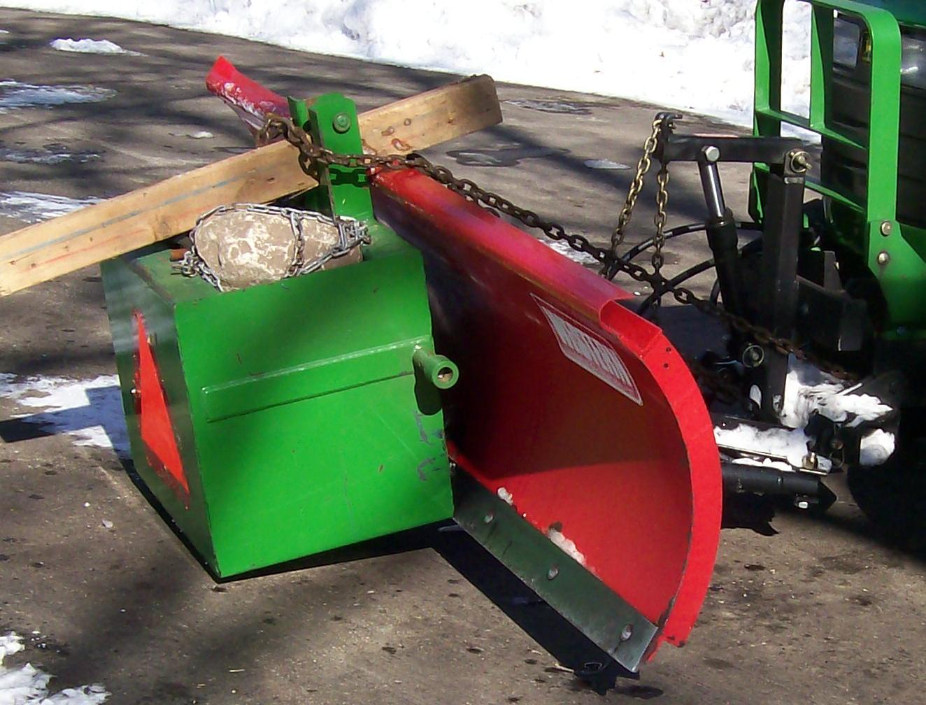

Not sure that this answers your question or applies to the fisher, but suspect may be similar lift hydraulics to help.
I needed ballast on the front end, and didn't want to remove the Western plow. So just picked up my ballast box with the plow blade and moved slow. Slipped a 2x4 in to catch the top, and a chain to hold it to the blade (and keep the blade from tilting forward). Worked like a charm. Wasn't sure the hyd ram would take it, but seemed to have no problem and I moved the wood around on the 3 ph forks with ease.
