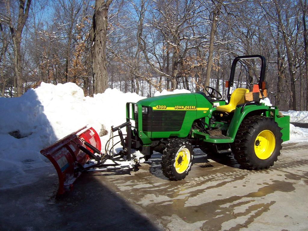

I found this photo on another site of this JD with an adapter made for the front end loader to mount a Fisher snow plow. Does anyone happen know if this item is still being made and by whom?
Al

Probably is custom made. Looks like a good fabrication too.
I put my plow directly to the frame to keep it closer. Easy to change back to the FEL if/when needed (15 min job at most).
Also, just this past winter added a custom made wing plow which adds greatly to the snow plowing "fun".

Yup, as BT wrote, that is a custom job. FEL plows have may drawbacks to them, what machine do you have? Plenty of threads also if you search.

There's a place in Maine that manufactures and sells adapter for Fisher plows. Darned if I know the name of the company, but there are two or three videos posted on YouTube. In fact, I think that picture is from one of those videos.
Might be a way to contact them there. Just go to YouTube and search for Deere Snow Plowing.

Kenny's got a good point about damaging the loader frame. Make sure your blade can "trip" and you use common sense.

I'm glad to know I'm not the only one who does this. A good way to bend a FEL is to use it to push snow & accidently strike a curb, sidewalk, etc.
   / Fisher Snow Plow to Loader #10
Earl
I agree, and after pushing snow with a tractor and front blade for 40+ winters, I know that the forces I've put on the blade would put some serious twisted stress and side loads on a FEL frame.
But those forces haven't caused any of the many FEL mounted blade users to admit to any serious harm. So, I'll take it that the FEL's can take the punishment that the blades dish out.
