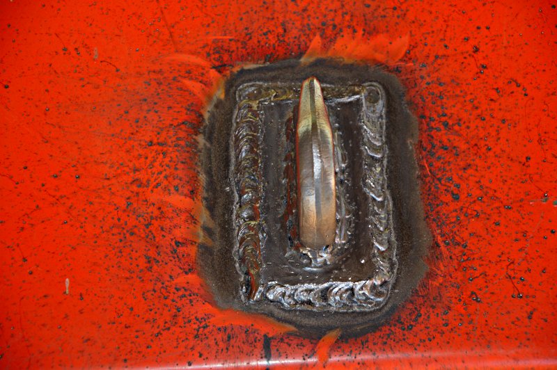

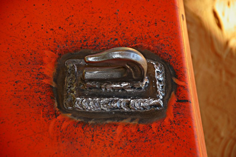

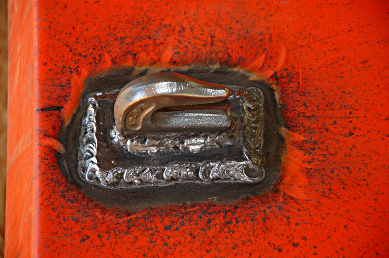

Well, I took the plunge and welded a grab hook onto the heel of my bucket today. (Kubota MX5100 tractor, LA844 loader, L2235 bucket.)
I just started welding this past spring, and thanks primarily to the good folks here at TBN, I've gotten some excellent tips and information.
No one will confuse my work with that of a good welder -- I am, after all, a computer scientist. :) Despite that handicap, however, I bare my soul and offer some close-up shots of the affair.

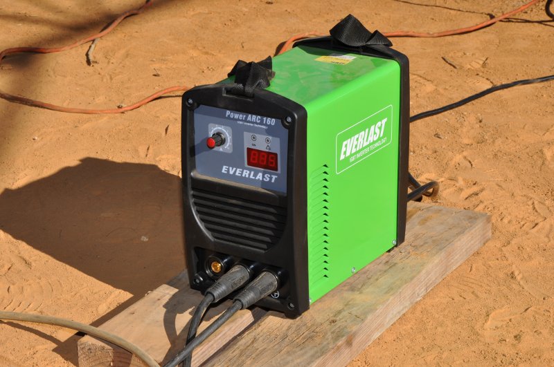

3/32" 6011 rod, 75 amps on the Everlast PA160 dial.
Critiques highly sought.

The beads look a little cold to me, more heat would help flow out. What does it look like from the underside, an indication of penetration? How thick is the base sheet?

Thanks for the comment, Transit.
The base plate for the hook is 1/4", and the bucket is 3/16".
The underside showed an outline of vaporized paint and major heat discoloration of the metal. I'd post a picture, but I've already primed it.

Yeah, 90 amps would have looked a little better maybe, but I bet a dollar it does not come off! I love your welder, I have one just like it:) a good value for the money if you ask me. Congrats for having the guts to publish a photo of your project.

Any particular reason you went with 6011 over 7018 for that? was the fit up poor? Also I agree with running at about 90 however it is machine dependent. Between my Ranger and My TIG with a stick on it I have about a 15 Amp difference burning 1/8 7018.
   / First weld-on grab hook #10
Very true,,knobs are just knobs,,you turn one of those knobs where you think is about right than you adjust from there.
