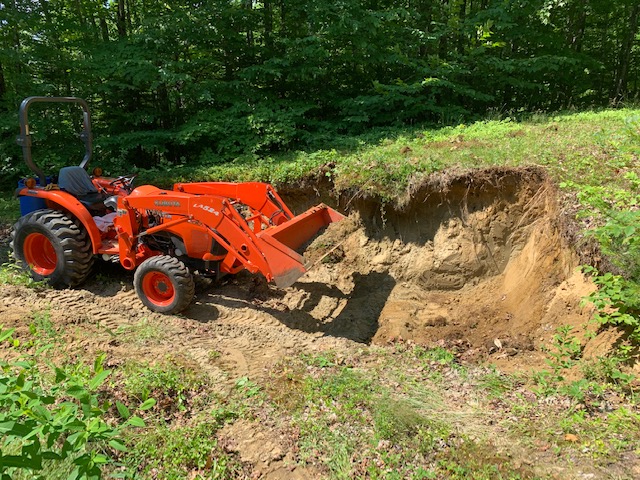

Thanks all for the advice, I ended up going with a used Kubota L3200! IMG_2274.jpg

Congrats on the new(ish) tractor- have fun and may it last you many years.
