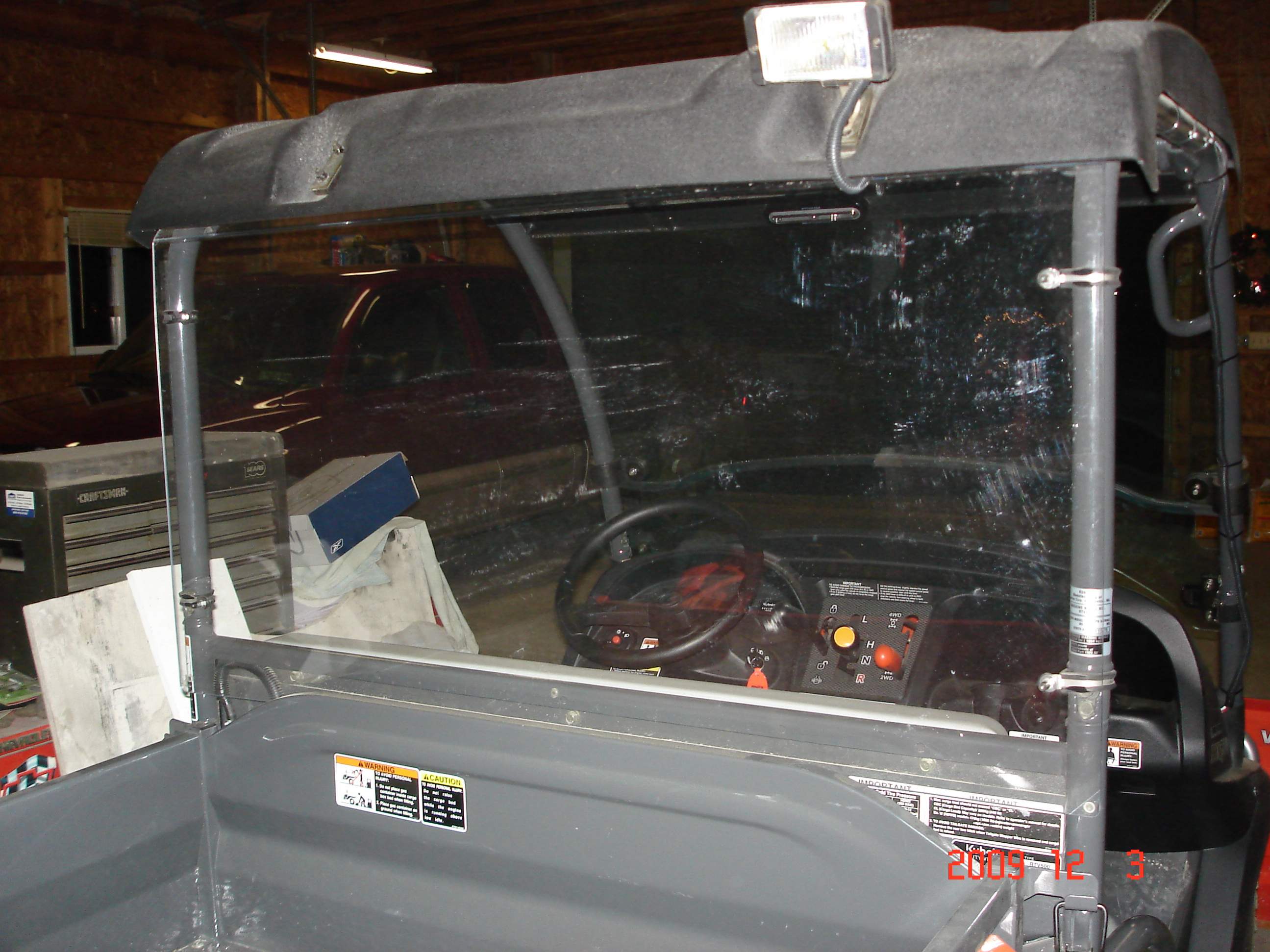

Go with glass if you can..The plasic ones scratch just by looking at them. can't even wash them off without getting hairline scratches. My back window is plastic. Aside from washing it, it never gets touched and it's a mess.

Slightly different perspective. If the w/screen is made of Lexan or hard plastic then as long as you care for it properly, it will last quite a while, Not as long as glass but typically get good service from it. My Harley has a wind screen which is subject to some nasty flying insects at road speed. Hasher environment then you refer to. It is 4 years old and just as clear today as new. I tour 5k miles/year that include trips down to the Outerbanks and the sand has yet to damage the w/screen.
Now here's the trick - proper care. When it's new, wax it! That's right use a good carnauba paste wax using only a clean micro fiber cloth. Apply w/vertical stokes only. Remove the dried and harden wax using the same method. This will prevent swirls and horizontal lines which highlight imperfections in the surface.
For fine scratches, I suggest using NOVUS #2, Fine Scratch Remover. A little elbow grease goes a long way.
At the end of the day, if it's about the cost, I believe you can buy 2 Lexan or Plastic w/screens to 1 glass.
