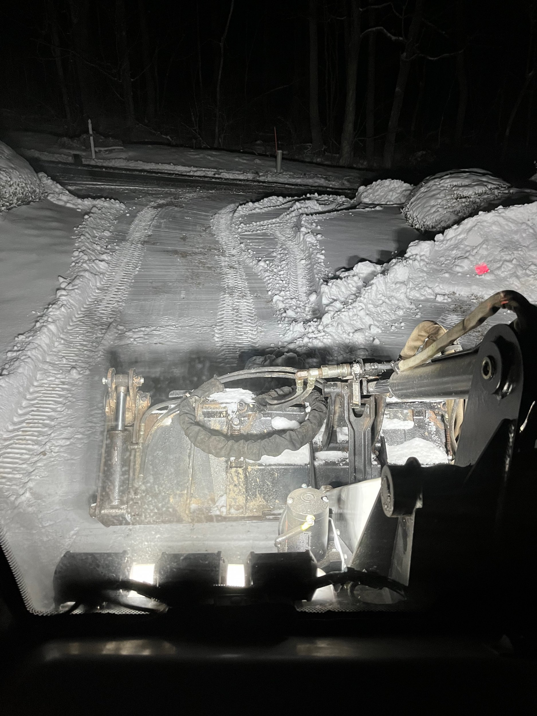

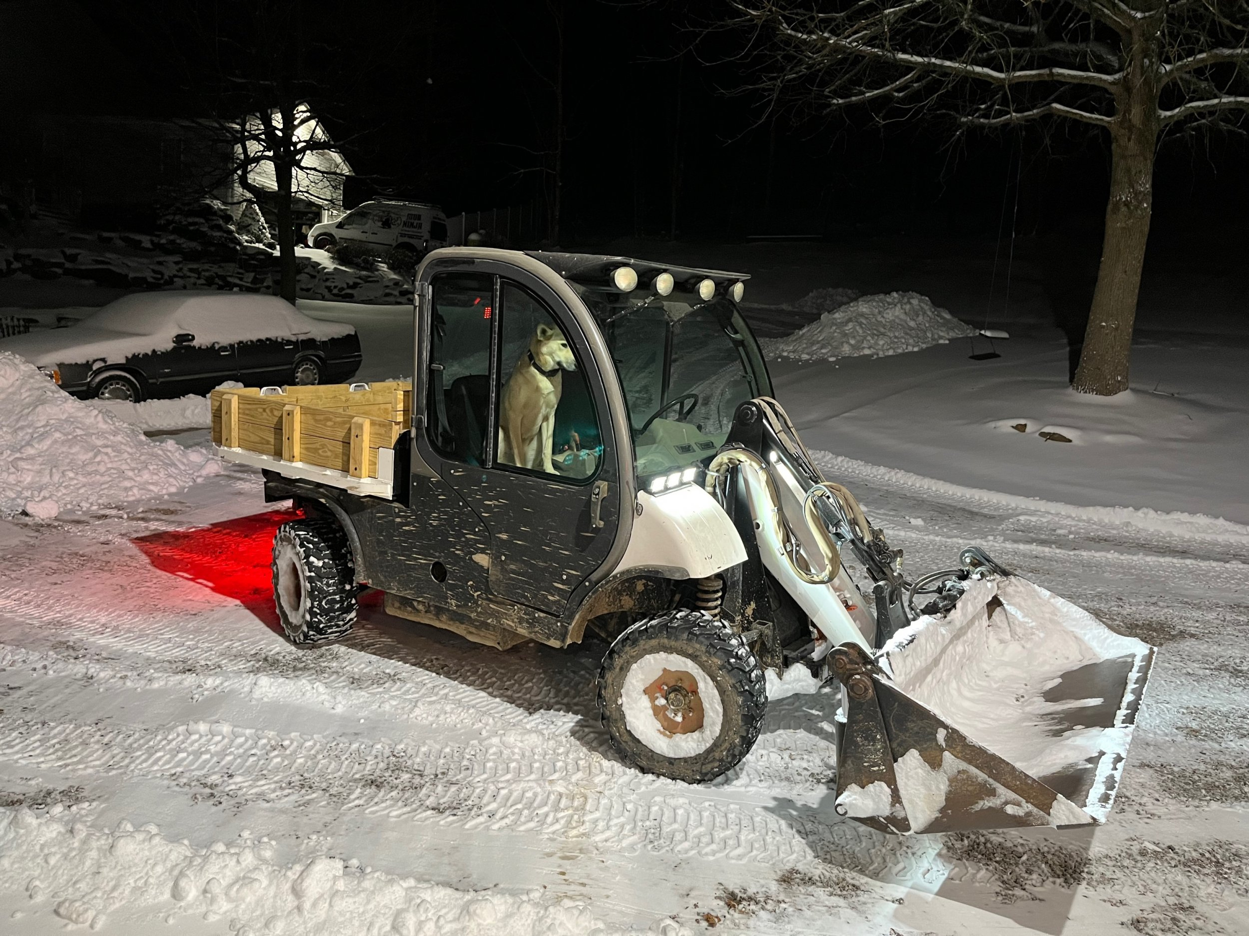

We got our first snow of the year (strange, it normally starts in November). Only 6" but had a chance to use the Toolcat for the first time in the snow. We don't get a lot of snow, but enough that if I don't plow it, no one can get in and out of my drive. We live on the side of a hill and you have to plow up, down, and sideways on it. The machine performed exceptionally well. No traction issues as well. Drive is gravel. Heat in the cab was a first for me. Always done it with an ATV, UTV or even skid steer with no heat. Only thing I need to work on is that rear tail swing when in 4WS. Toolcat 1, mailbox 0.

looks good, re heater, I have to crack the window a bit or its too hot, as for tail swing you get use to it, around vehicles or tight areas I use the 2 wheel steer, took out some fencing one time here
