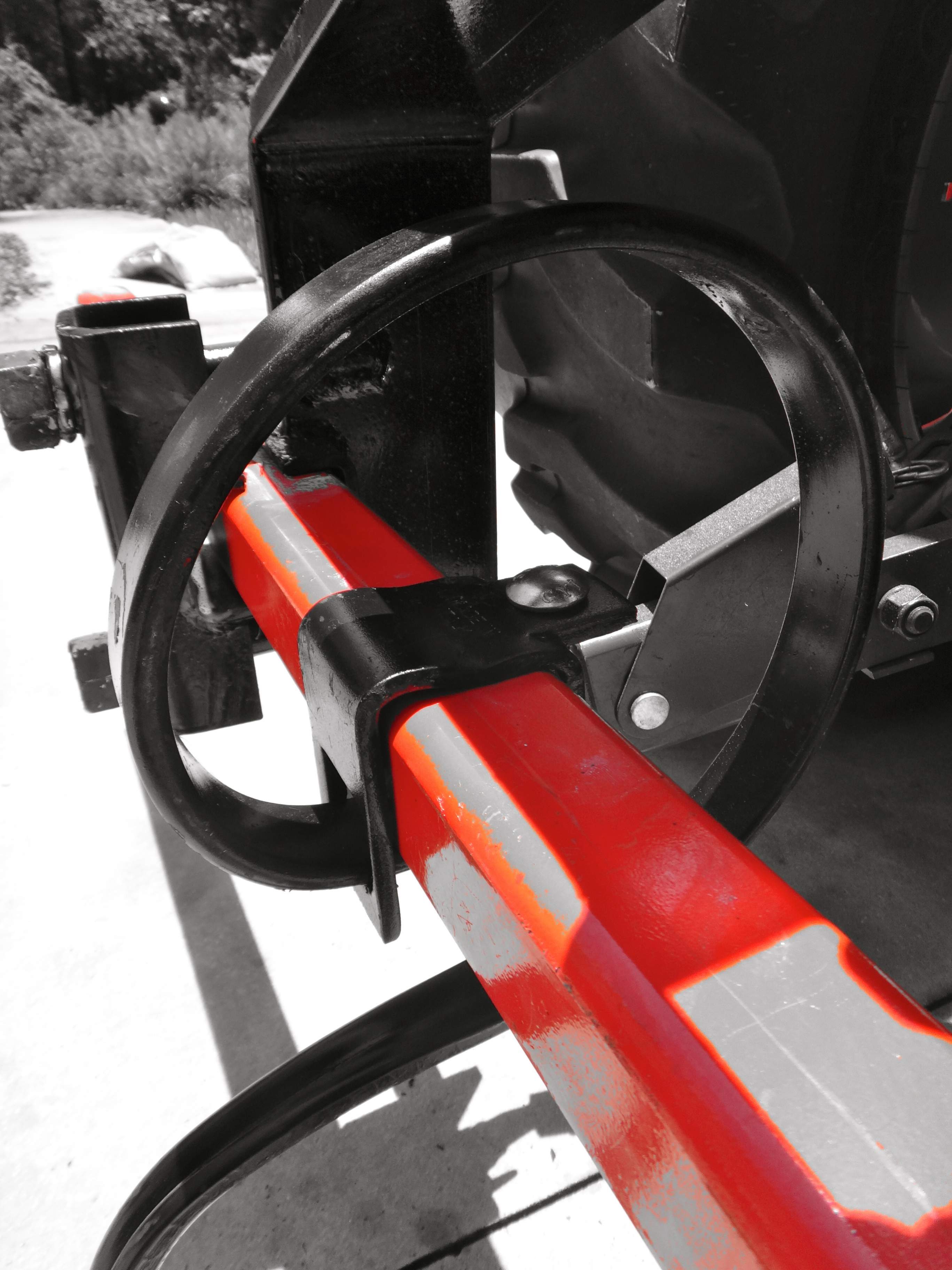

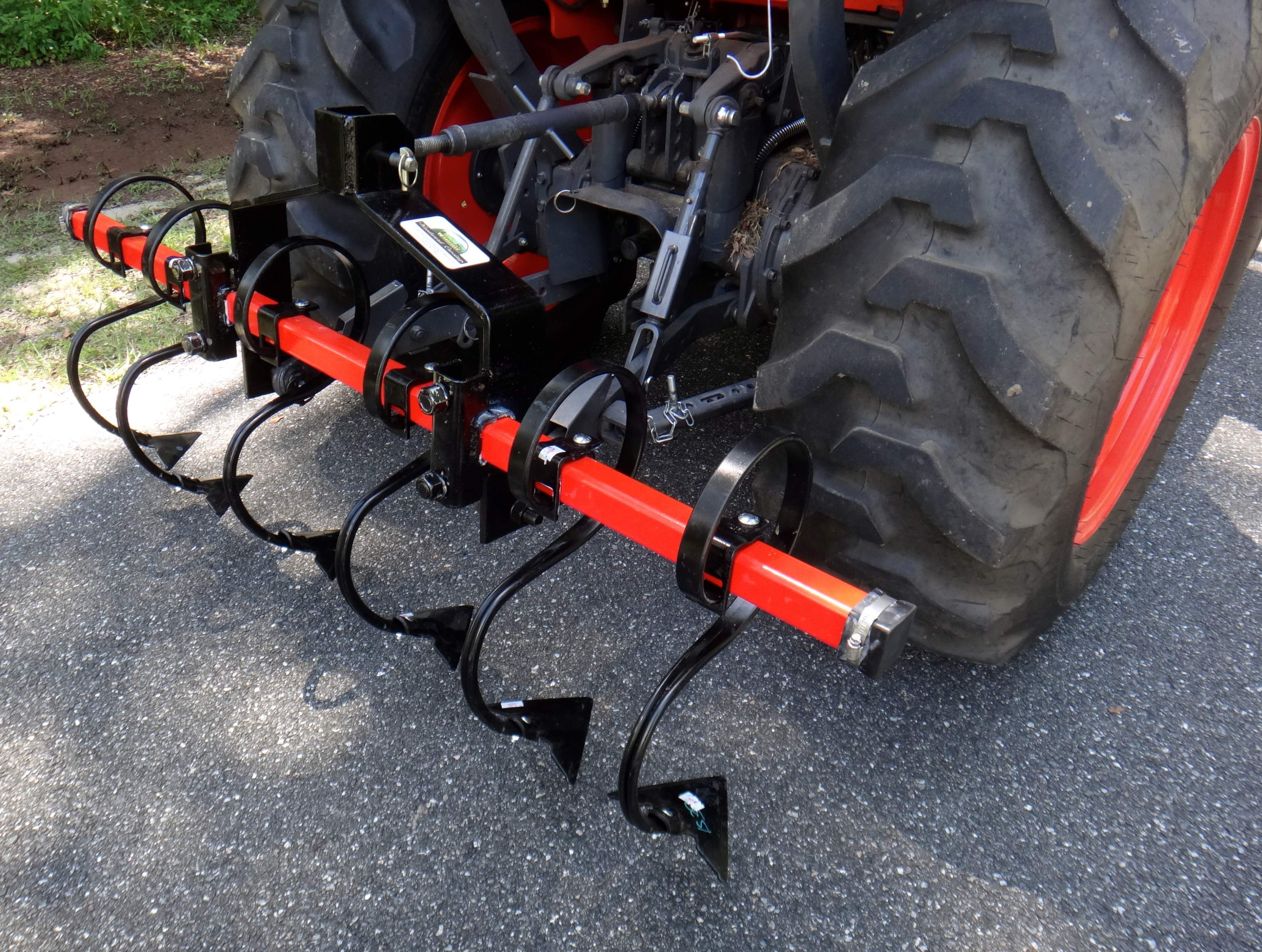

Photos: Expect you will desire a Three Point Hitch mounted Cultivator.
