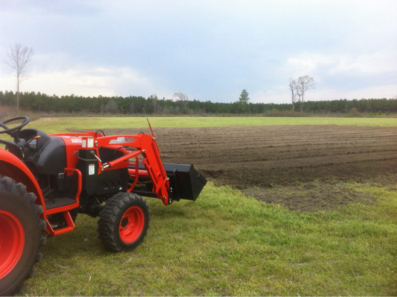

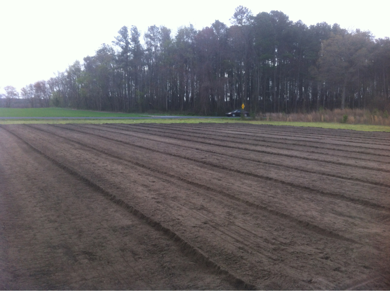

Well the season has officially started with the first ground breaking. Tilled about an acre today took a couple hours to work it up real good. 3 total passes to get what you see in the second pic. First pic is after second pass. Planting to begin week after Easter as long as the weather doesn't get all crazy (like the 70 degree days and frost warning the same night like the past few days)

Almost forgot, used a standard rotation woods 74 inch tiller. The kioti far surpassed my expectations and had tons of torque and I hardly knew the tiller was back there. First two passes were in low and the third was in mid. Used almost a half tank of fuel in the process. The auto-pto was awesome as I finished each pass to just lift, have the pto shut down as I turned and reengage as I entered the next pass. 3pt was smooth up and down all afternoon long. Not bashing the kubota L3800 I was looking at but I think I'm gonna be much happier with my kioti.

Pretty work!! Nothing works the ground better than a rotatiller.
   / First till with DK35 and 74" woods (pics) #4
Looks great, nice job.:thumbsup:
What do you intend to plant?
This plot will be sweet ice sweet corn (72-74 days) and should be ready for market near the week of 4th of July.
