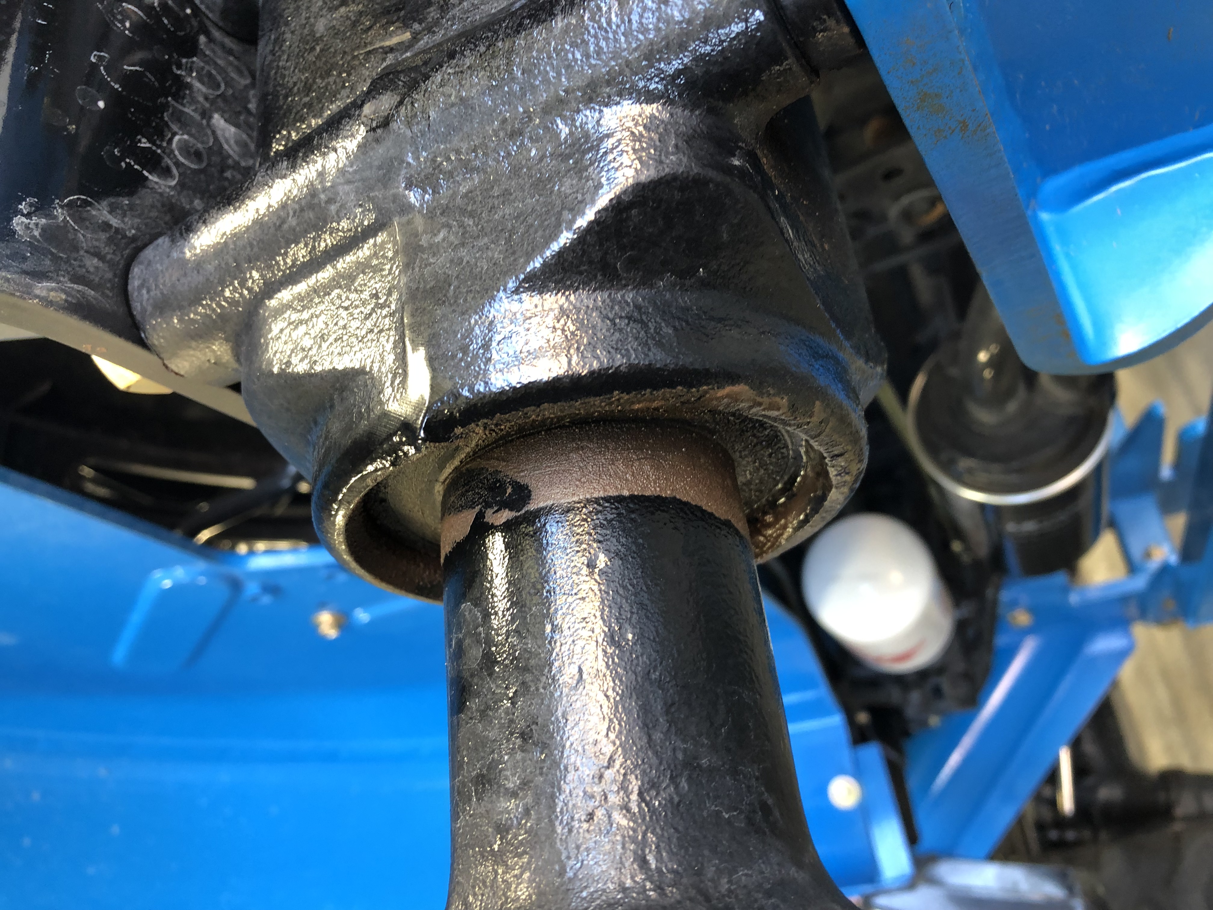

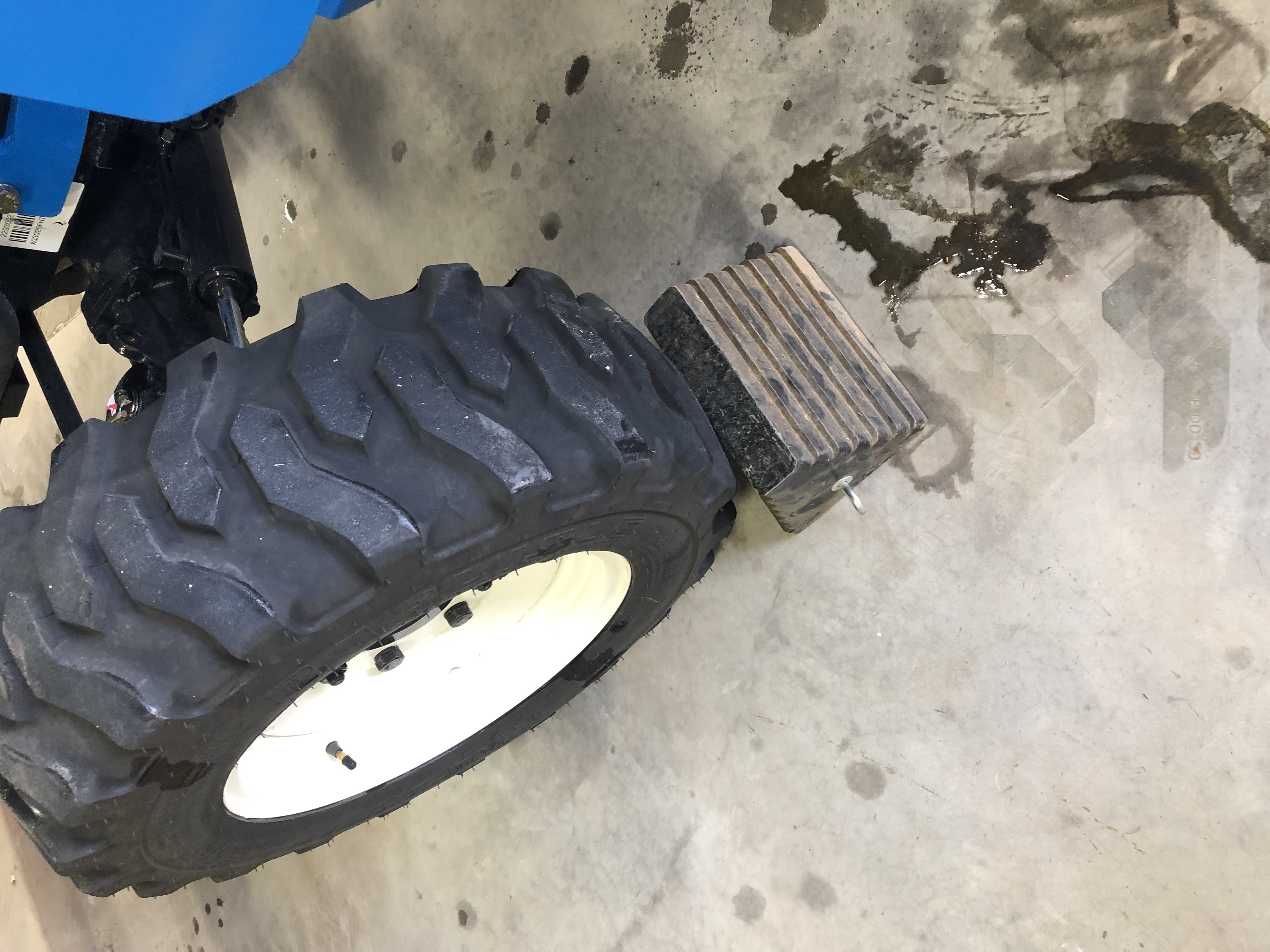

I completed the service and noticed I was a couple quarts low when I checked the fluid. I do switch out the back hoe at least a couple times a week but this should not account for that much fluid loss. So I started to ponder actually having a leak. Low and behold with my amazing luck, I found a leak!:mad::( My rear left axle seal is leaking and causing fluid to drip on the tire and you wouldn't really notice it if I was parked in dirt for a while.)

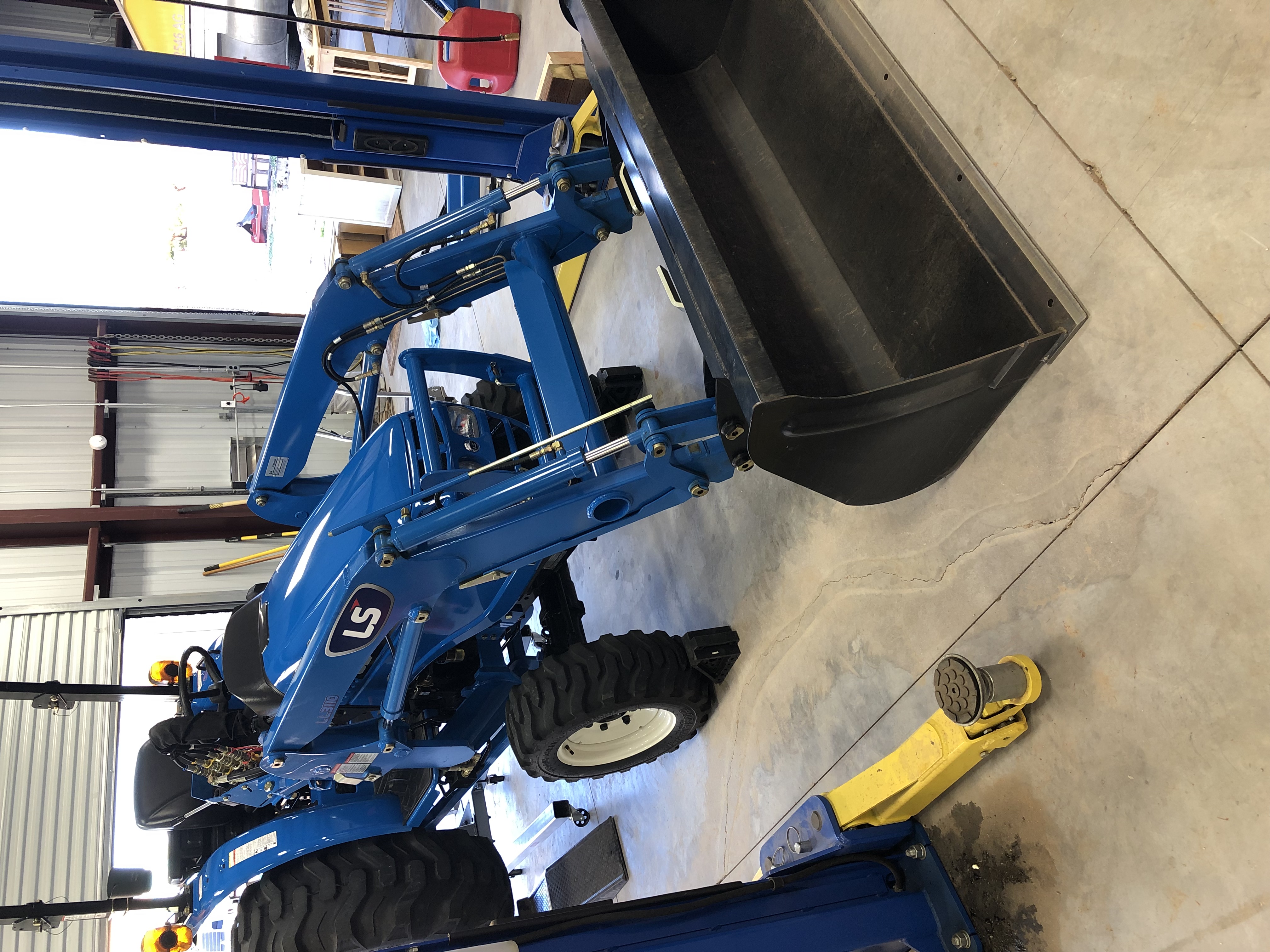

First day being able to get started on the repair and all ready came up with a snag. So I could use some suggestions before I tackle it in the morning.
The first thing that had to be done was a good wash to make sure there was no dirt or globs of mud since I need to reuse the new hydraulic fluid that is currently in the tractor.
After that was done, I chocked the front wheels and raised the FEL so the back of the tractor can be jacked up without the FEL dragging or causing shifting problems.

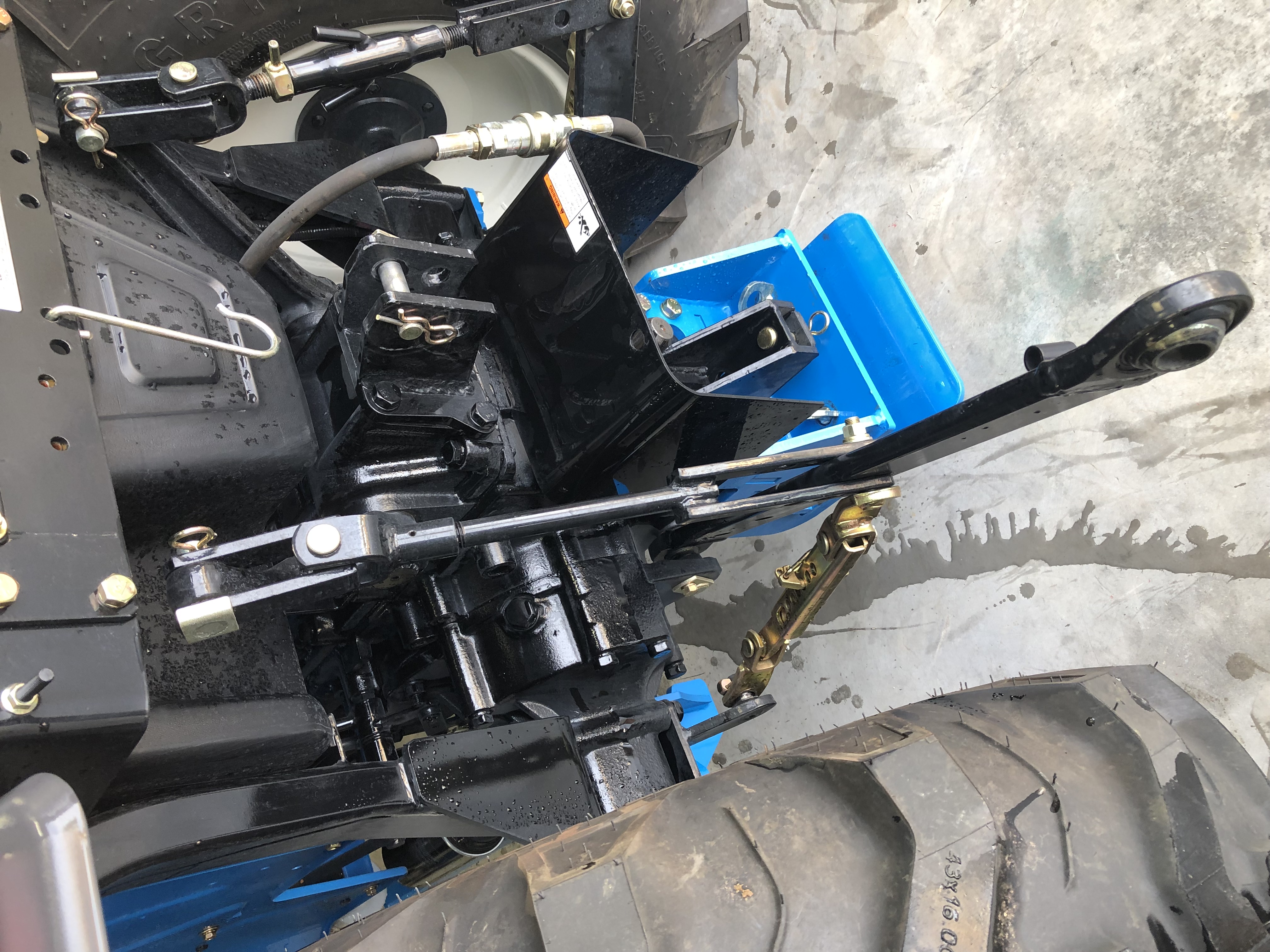

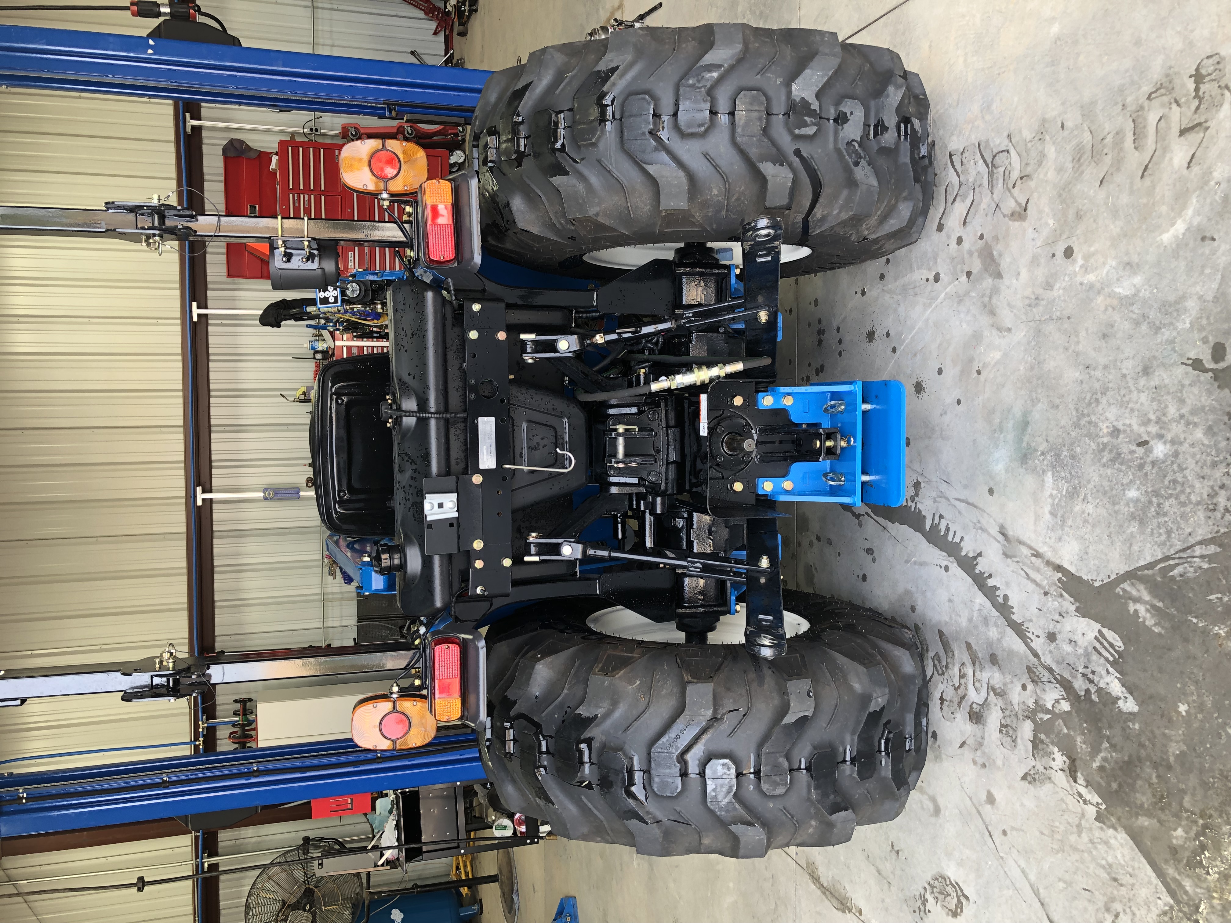

Once that was done I than proceeded to take off the two 3 point hitch arms.
And with the arms removed, we can now proceed to jack up the rear of the tractor.

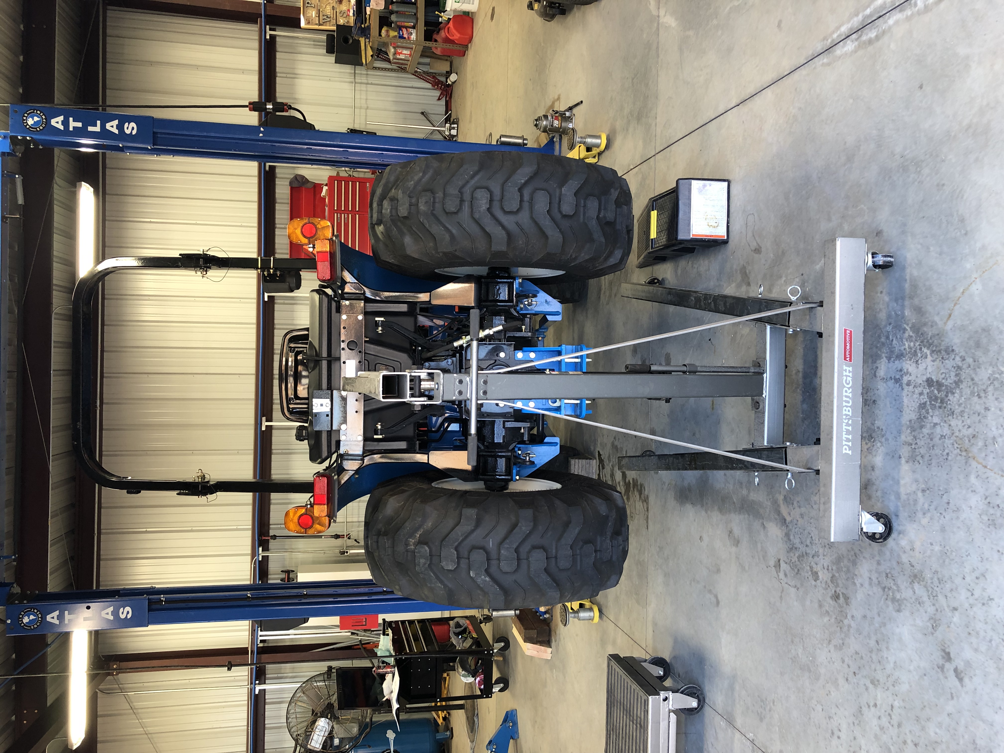

Now for the problem. Since I have the Back Hoe for my tractor, I have the sub frame mounted to the frame of the tractor which attaches right below the FEL and at the back right under the rear axle/tranny. I have to drop the sub frame in the back so I can take off the left rear case final drive assembly as well as unbolt the fender from the top side of the case final drive. The issue is finding a spot to use the jack stands under. You would typically place the jacks under the axle shafts or even the sub frame. However, I have to drop the sub frame AND I have to take off the left rear tire and axle shaft which is attached to the case final drive of course. Since the tractors front end is a center pin style, when I jack up the rear of the tractor from the Back Hoe sub assembly at the rear of the tractor which is blue. The tractor can easily tee totter from either side. I need to find a way to put a jack on the left side in which I am taking the tire off so I can start disassembly. I forgot to take pics of it jacked up, but I do have a ramp under the right rear tire, but I need the tractor jacked up another 8" or so, this way I can place my platform table jack to get the massive tire off without killing myself.
The only thing I could think of was to some how tie down the right rear tire anchored to the deck. This would keep the tractor from wanting to teeter to the left side in repair. The only question is "HOW"?
Some more news as well. I ordered the two rear remotes for rear implements in which I did not have installed from the dealer due to time constraints and my dealer has never installed them. So I will be doing that install at the same time as this since I will have better access. I will do another write up of that installation. I sure cannot wait for that major upgrade. I am still tossing which new implement to purchase that best suits my needs to help for grading work.
   / First repair that needs to be completed on my new LS3025H

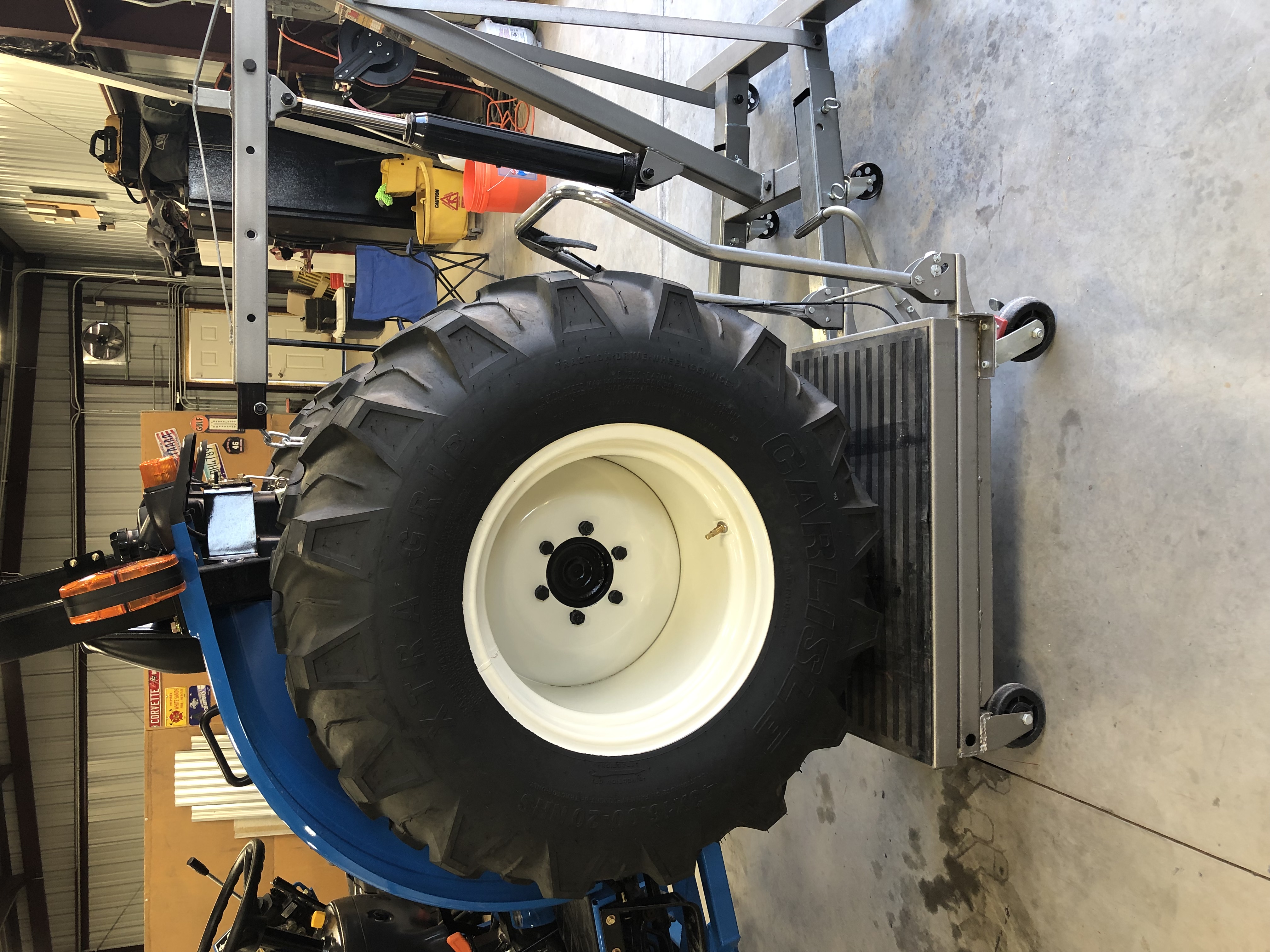

Got a lot done today on the repair. Had to call my Tractor Dealer to go over another hiccup in which we will discuss a little later. For starters, After writing up on needing advice on how to jack up the tractor. In the tractor manual that comes when you purchase new. It discusses jack up points and also states IF you are unable or need to service the drive axles to jack up using the three point top link. So I used my engine hoist to jack up the tractor with no problem. I also used my platform jack for the massive tire.
Since we still had the issue with the tractor wanting to tip to either side. The simple solution is to lower the FEL onto the deck. Have to be careful in this situation. You want to make sure you move the joy stick in all directions to release pressure from the lines.

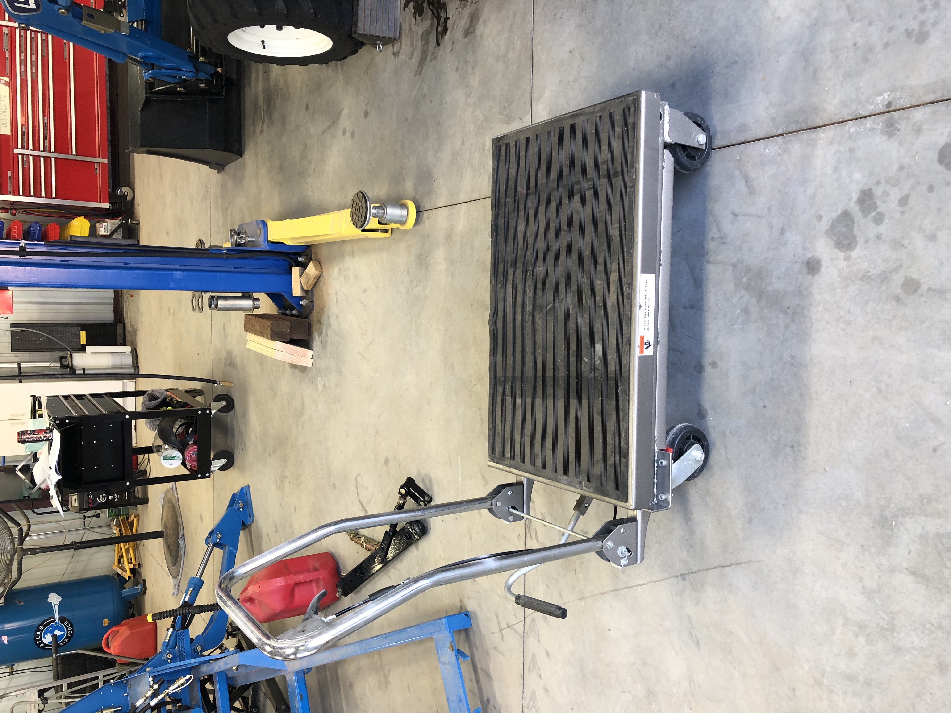

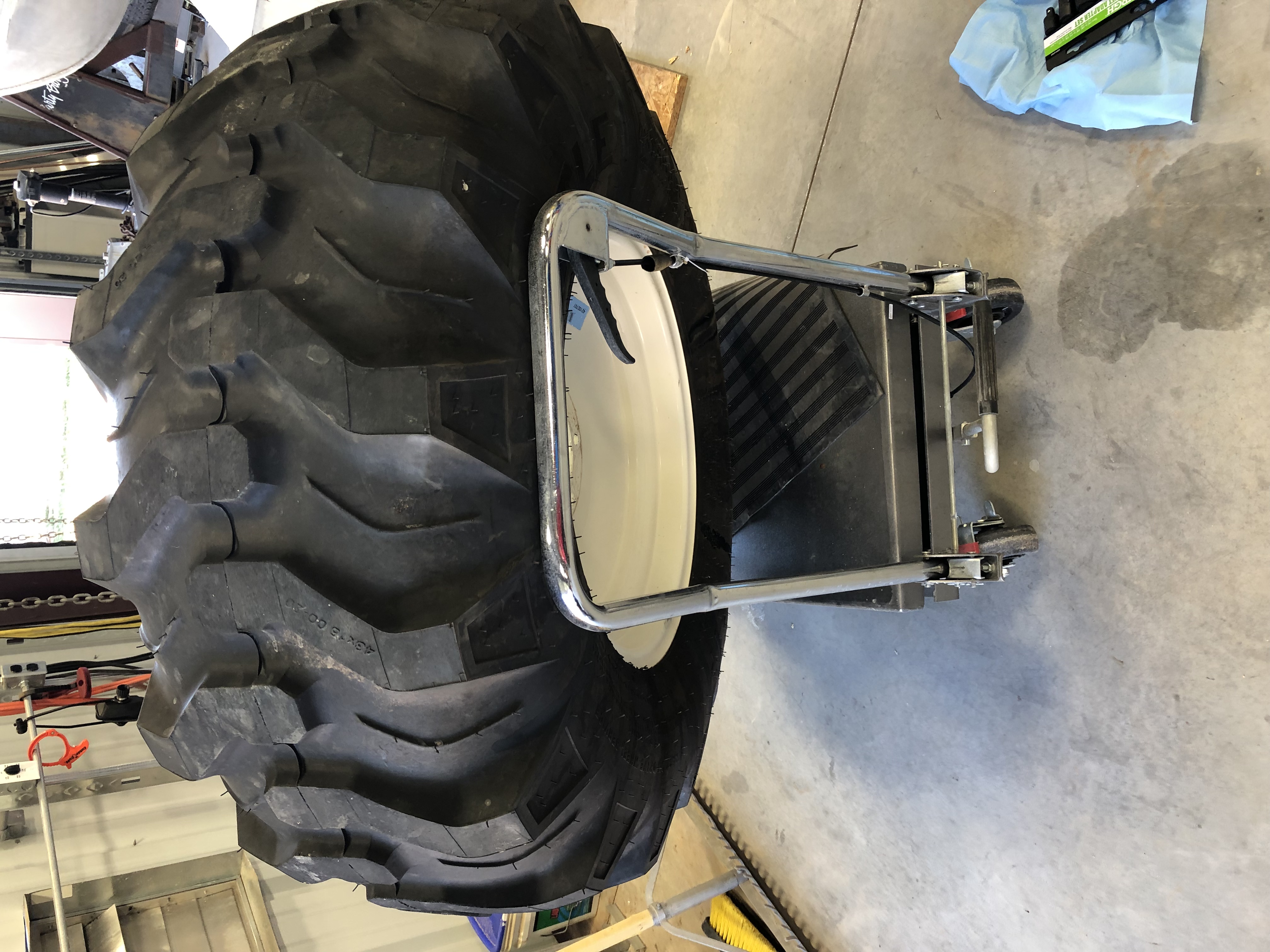

Here is the Platform jack taking the tire off.

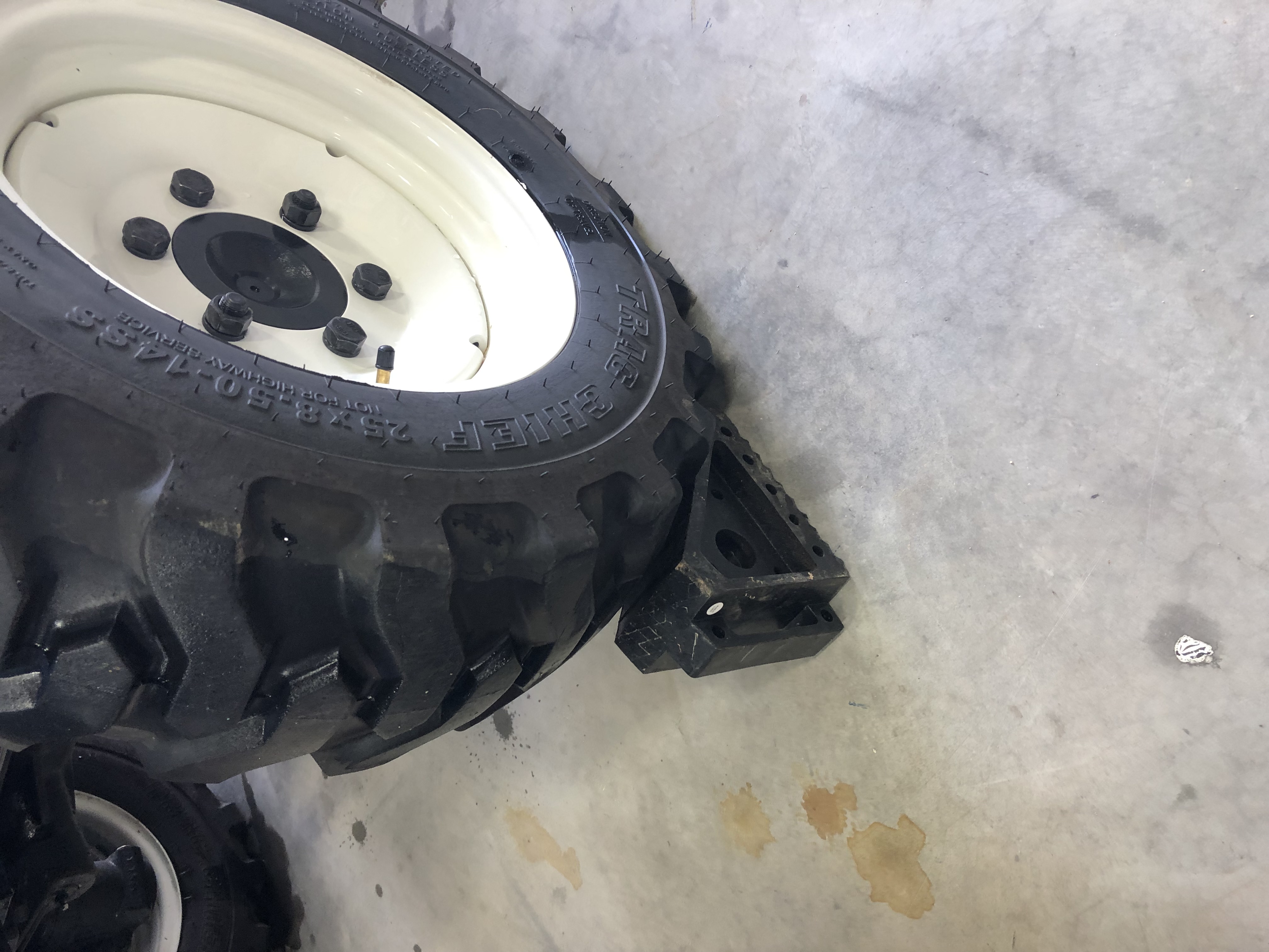

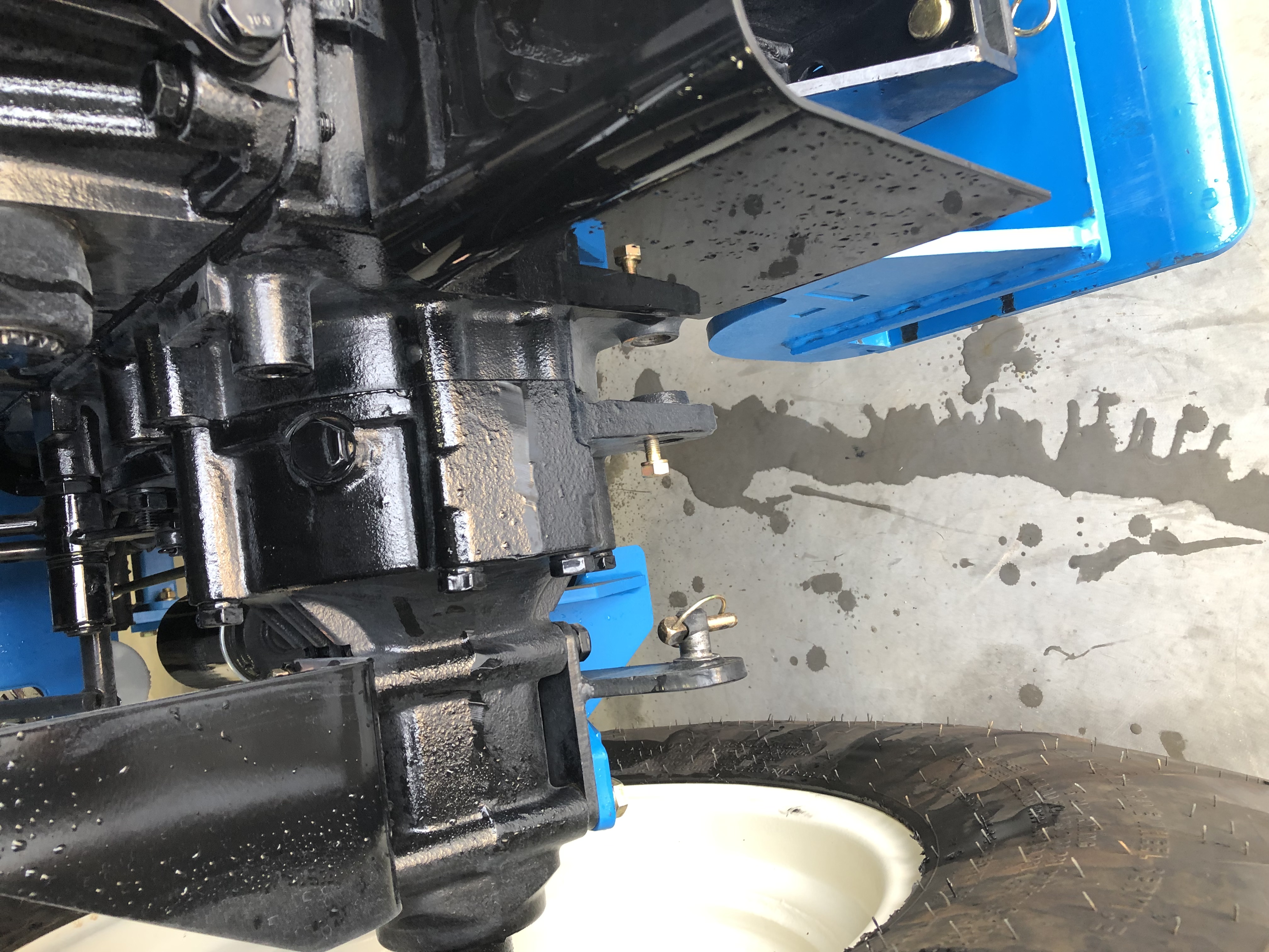

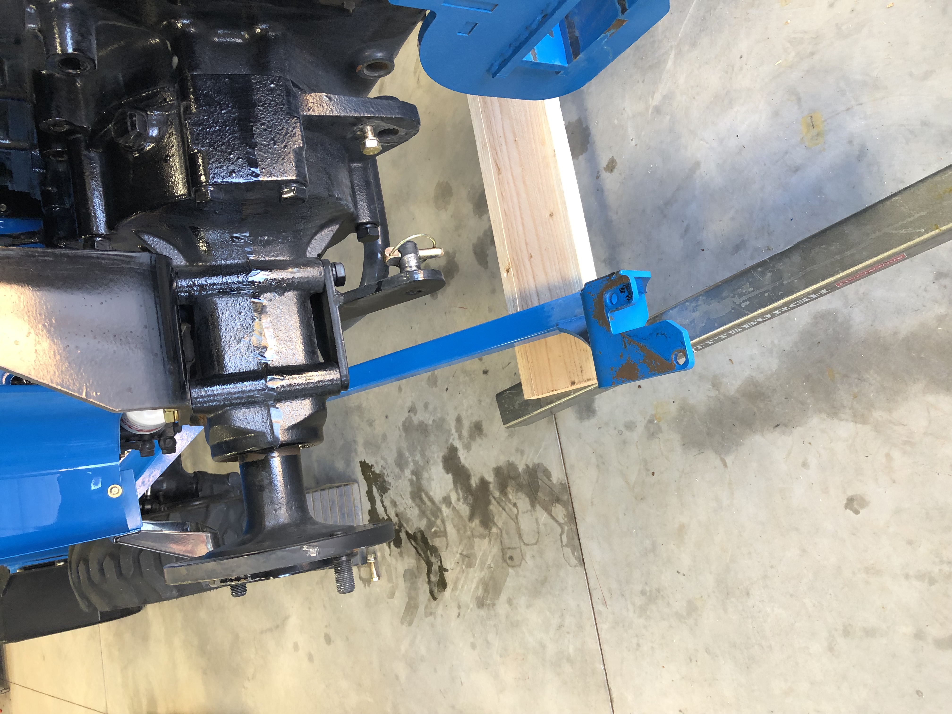

Now with the Tire out of the way, we can clearly see the bad or defective driveshaft seal.

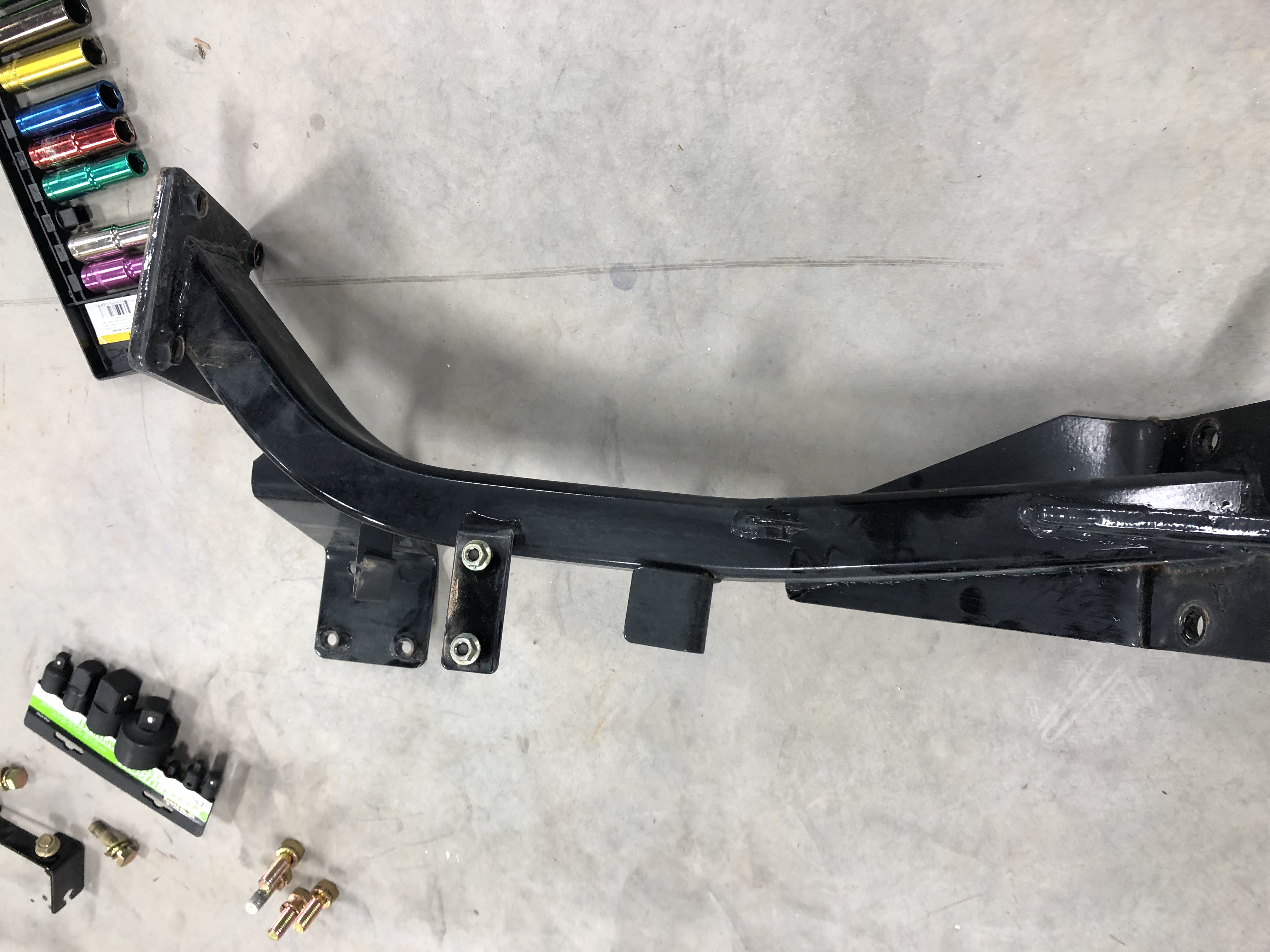

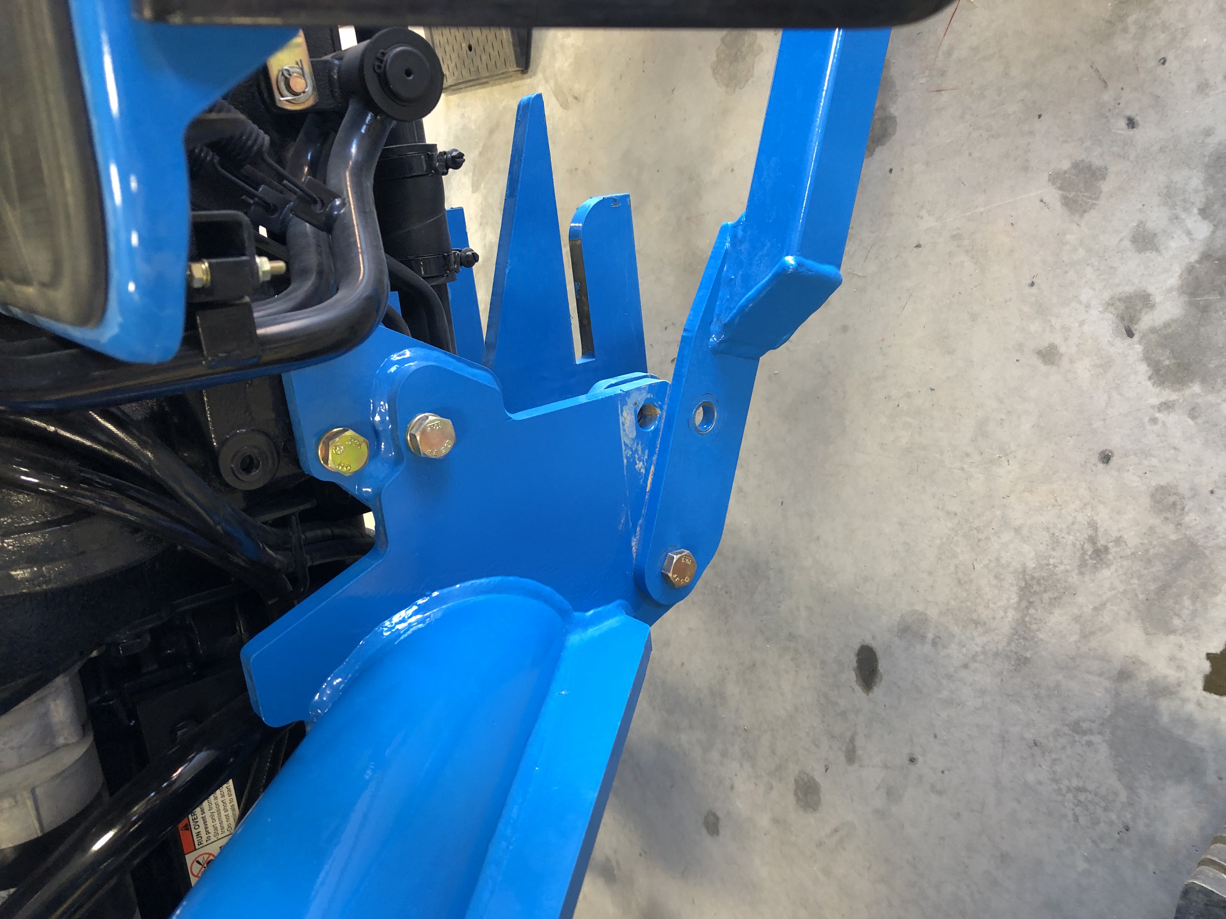

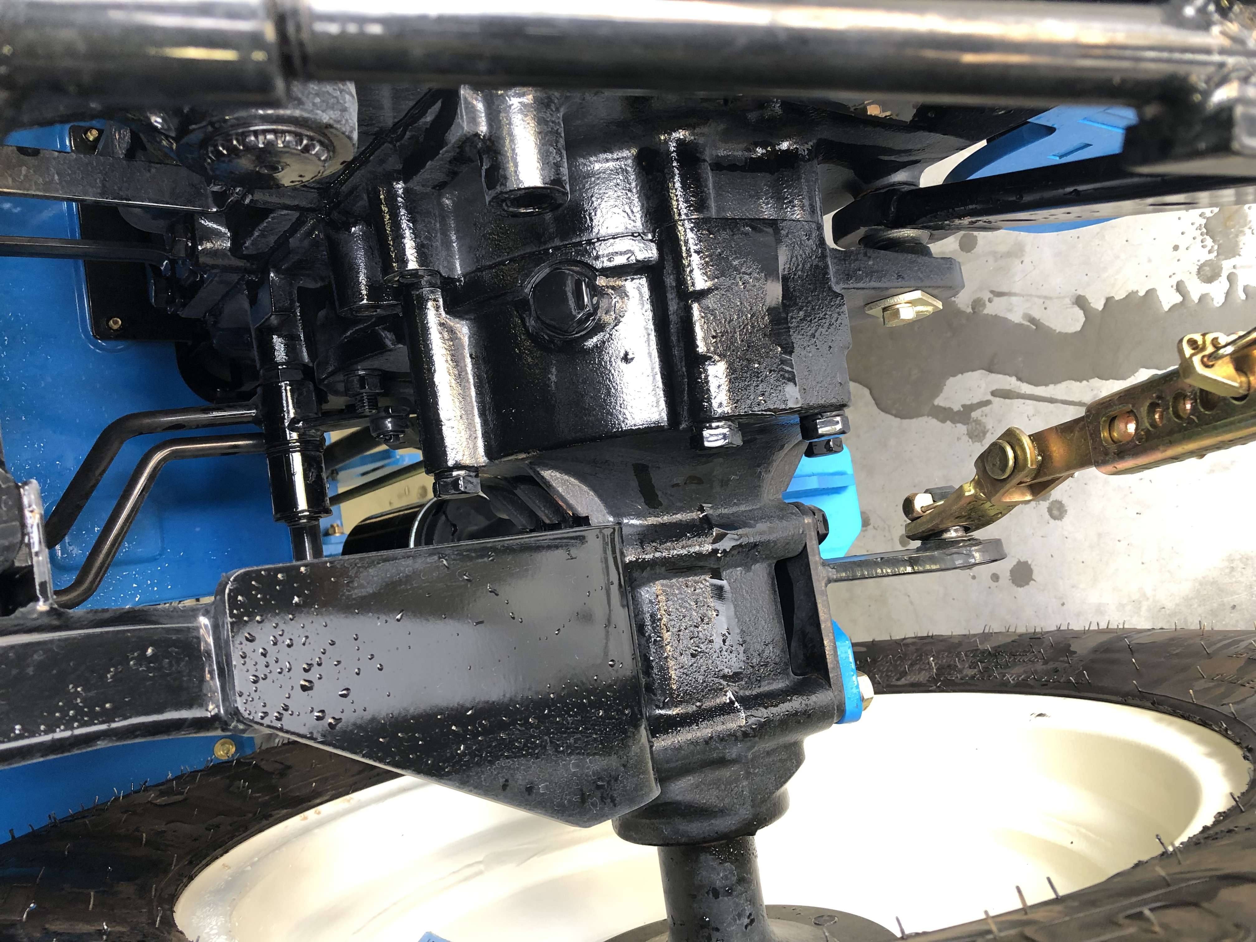

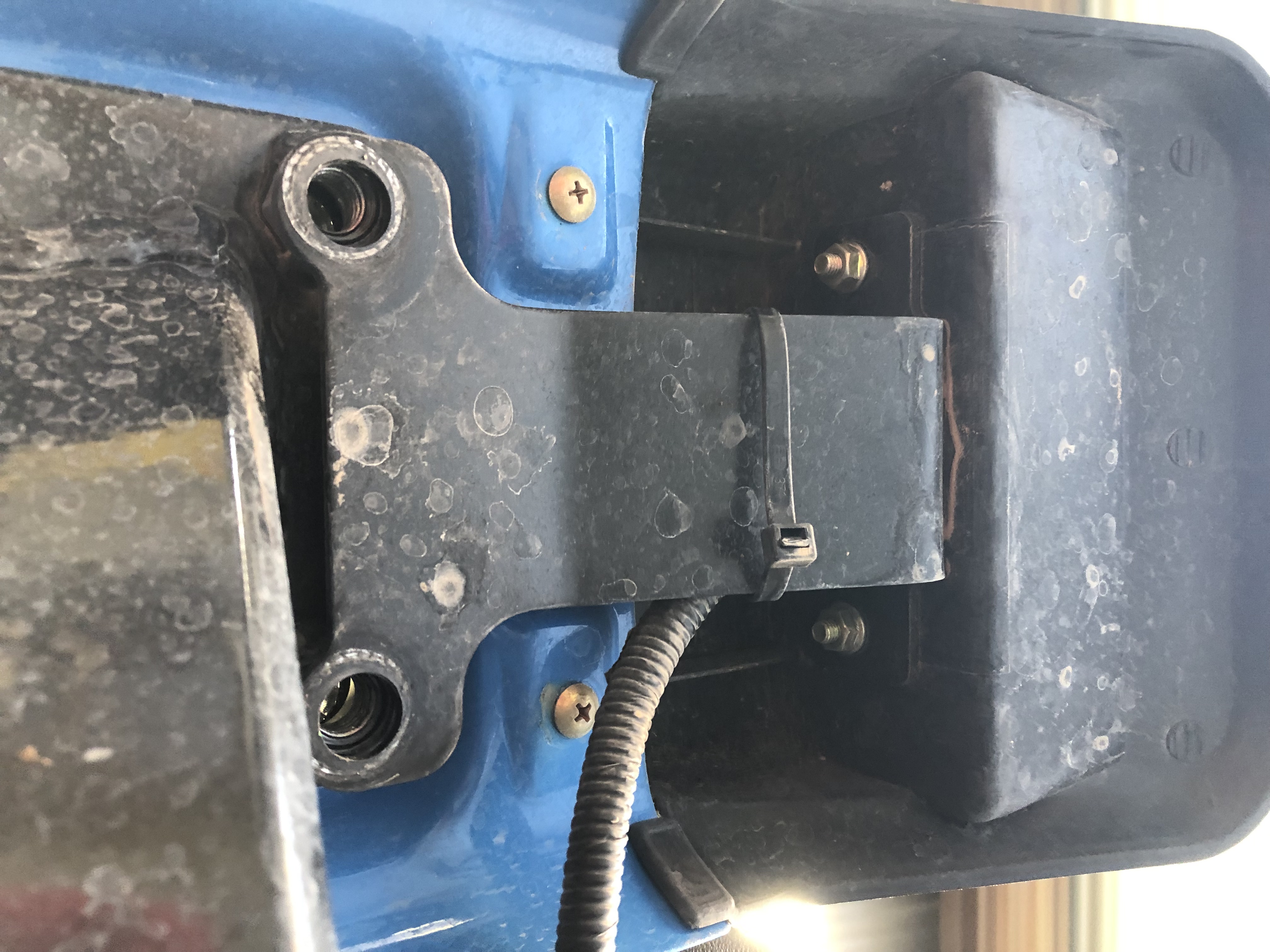

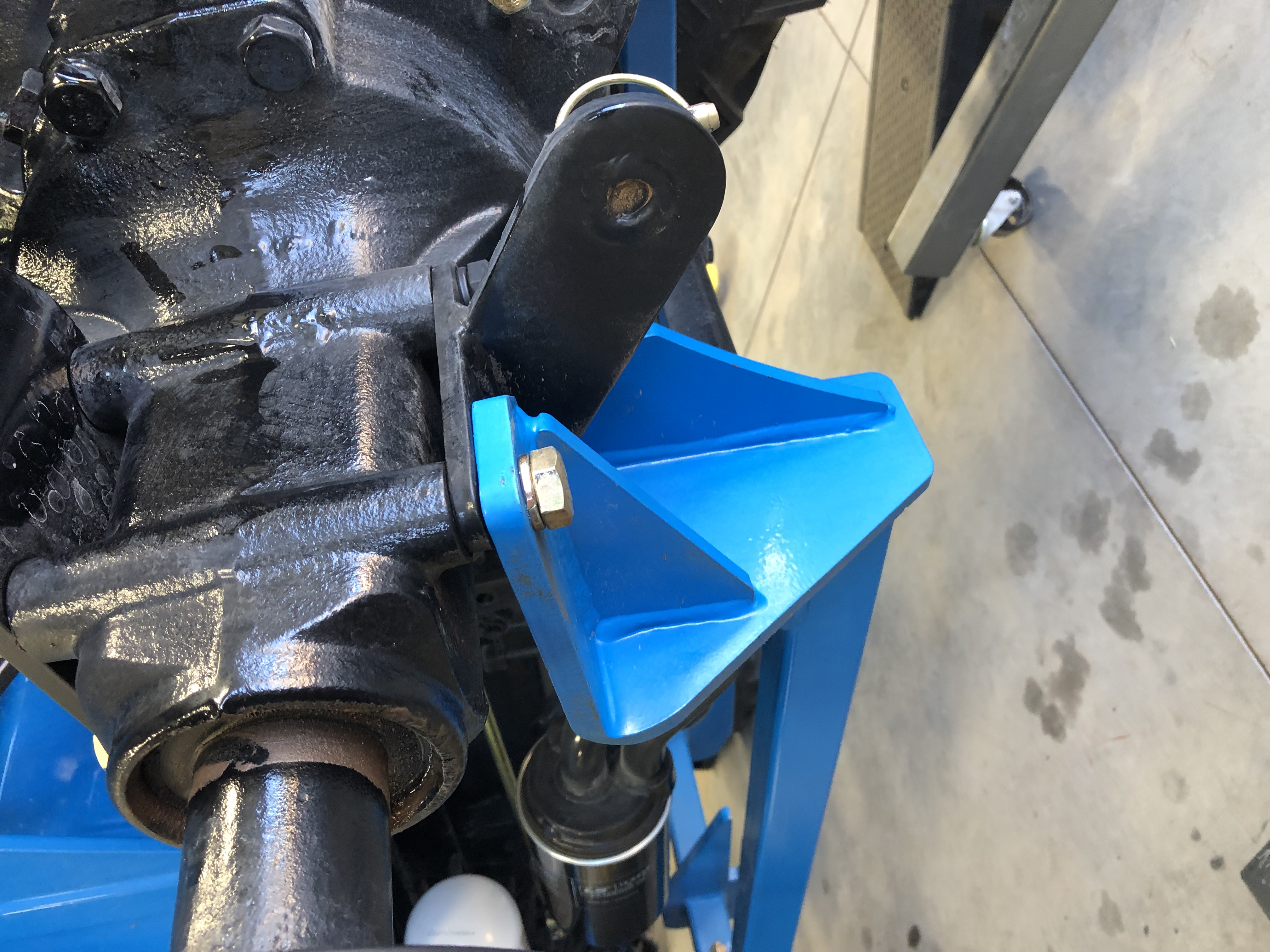

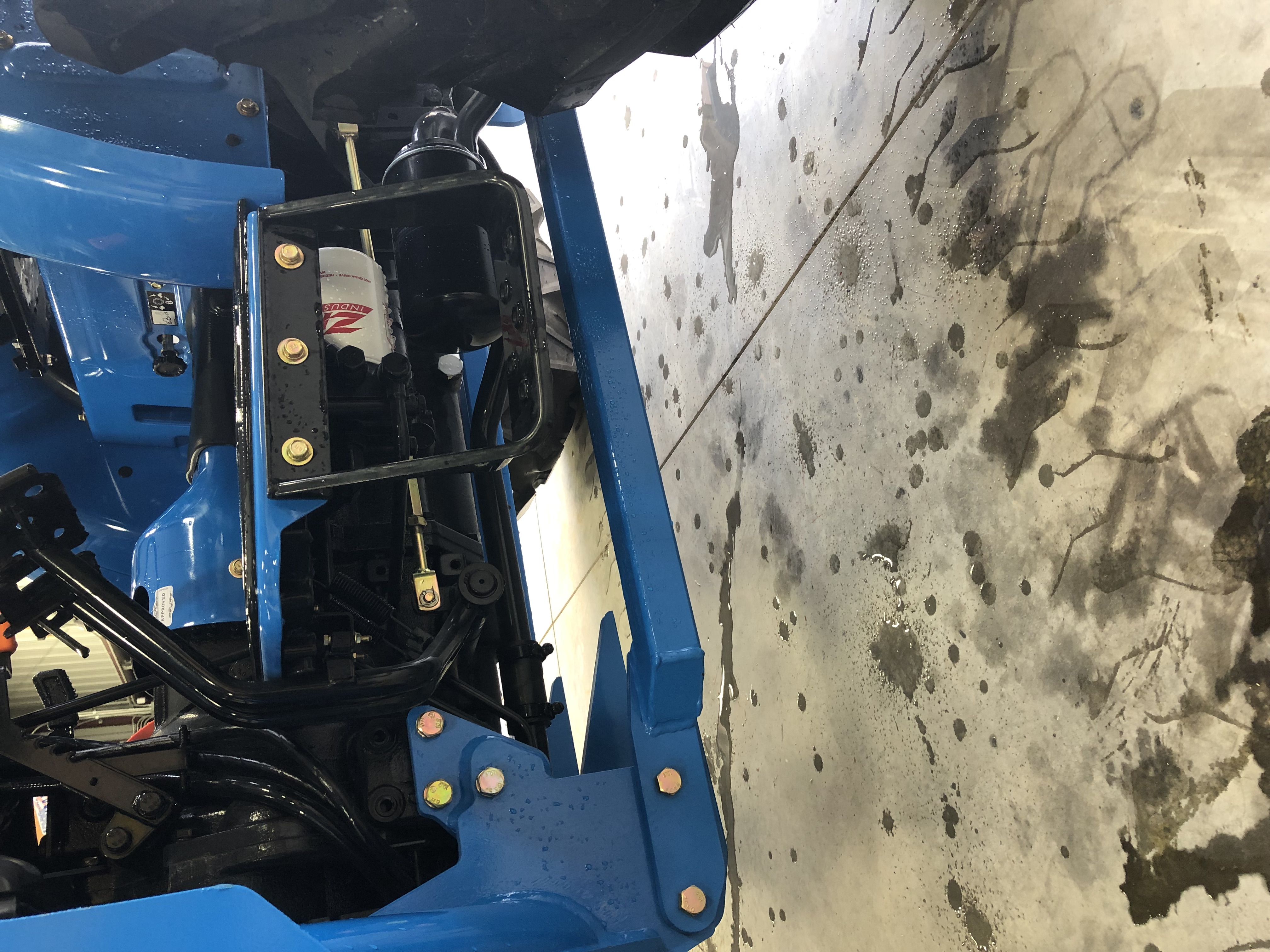

Next steps is to take off everything in the way of getting the final drive assembly off. The first is the left side lower sub frame mount for the Back Hoe.

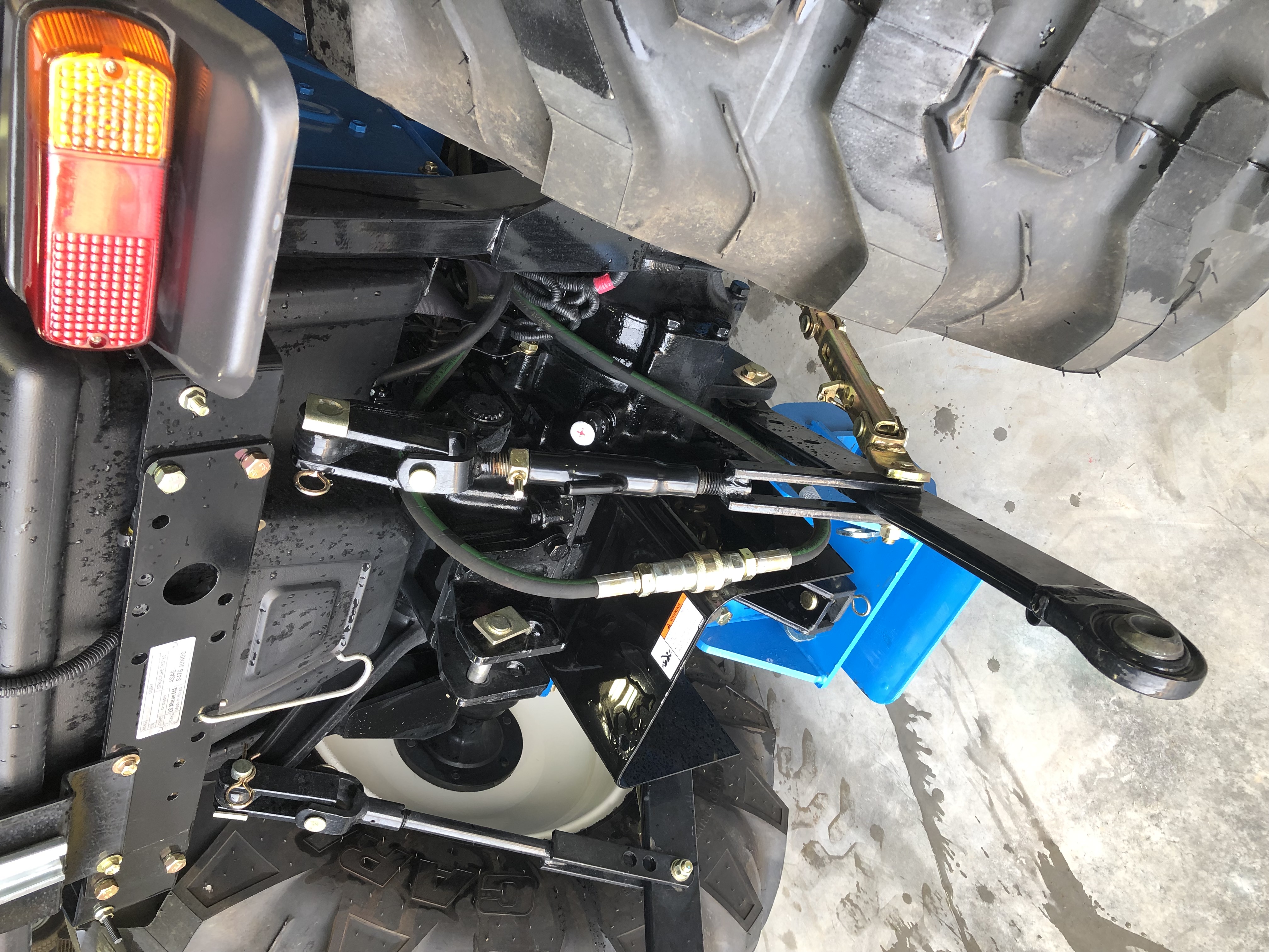

After you take off that sub frame, you will than take off the lower plate for the 3 point hitch rail.

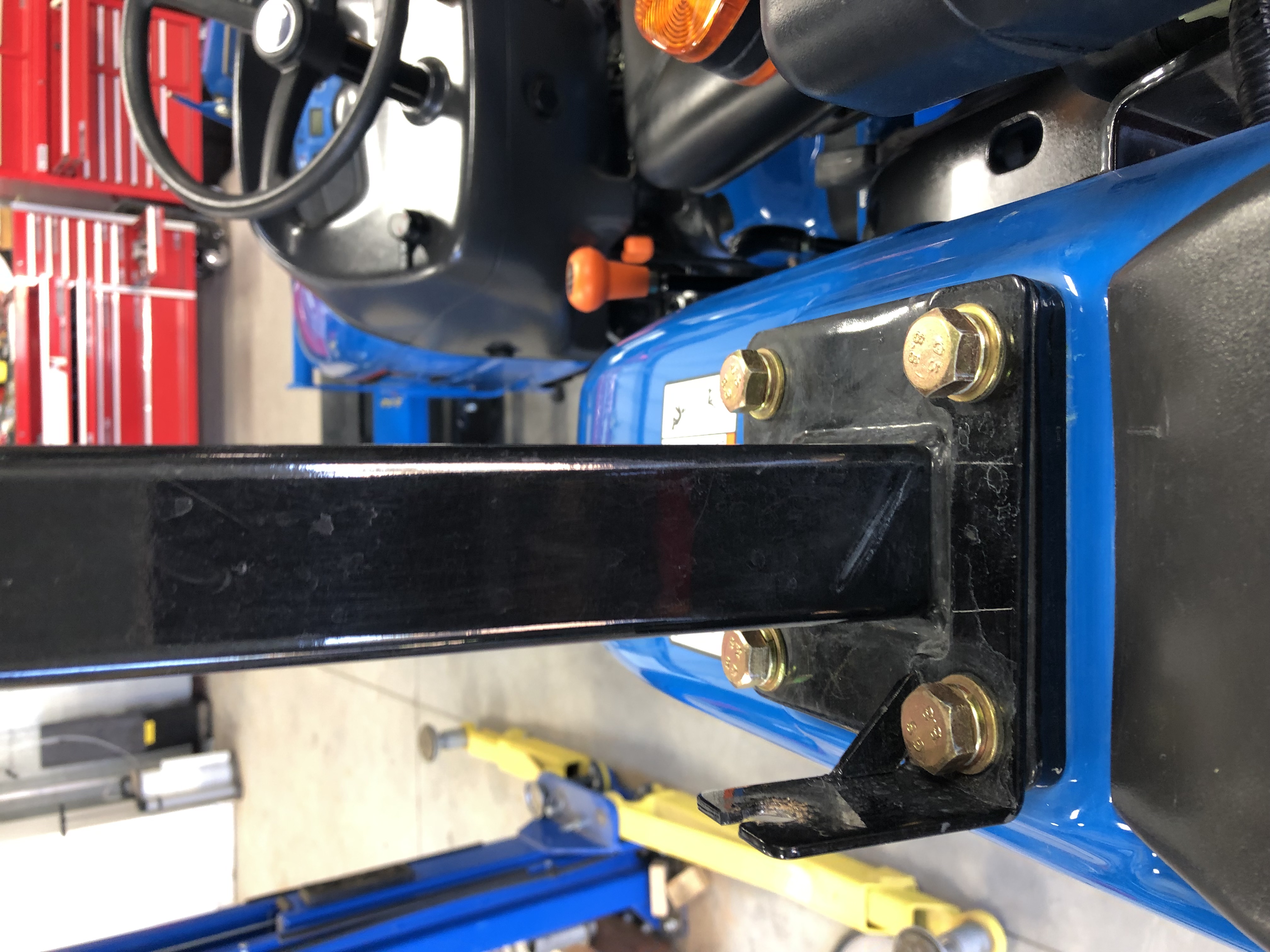

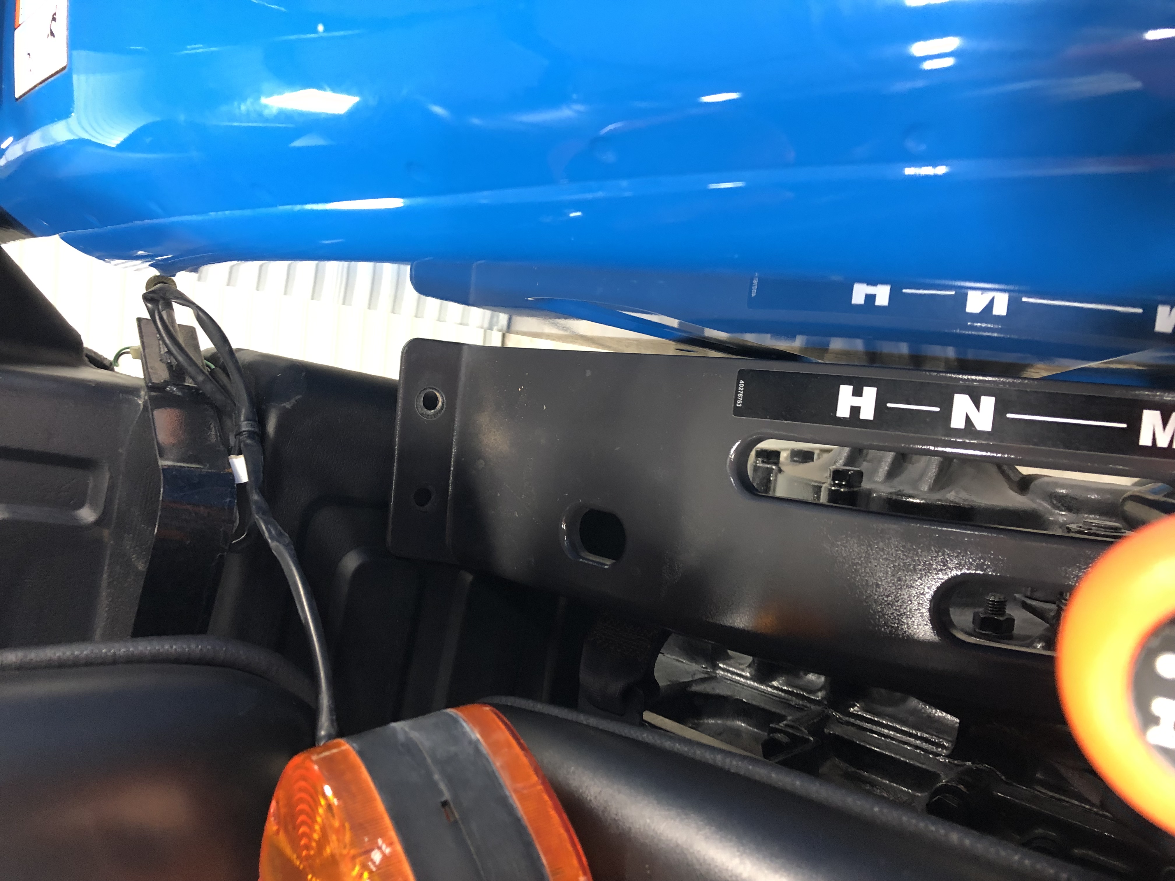

Next on the list were the blinker assembly and the rear tail light assembly. These have to come off so you can take the ROPS support member out. Make sure you take out the two star screws from the tail light assembly before trying to take it off.

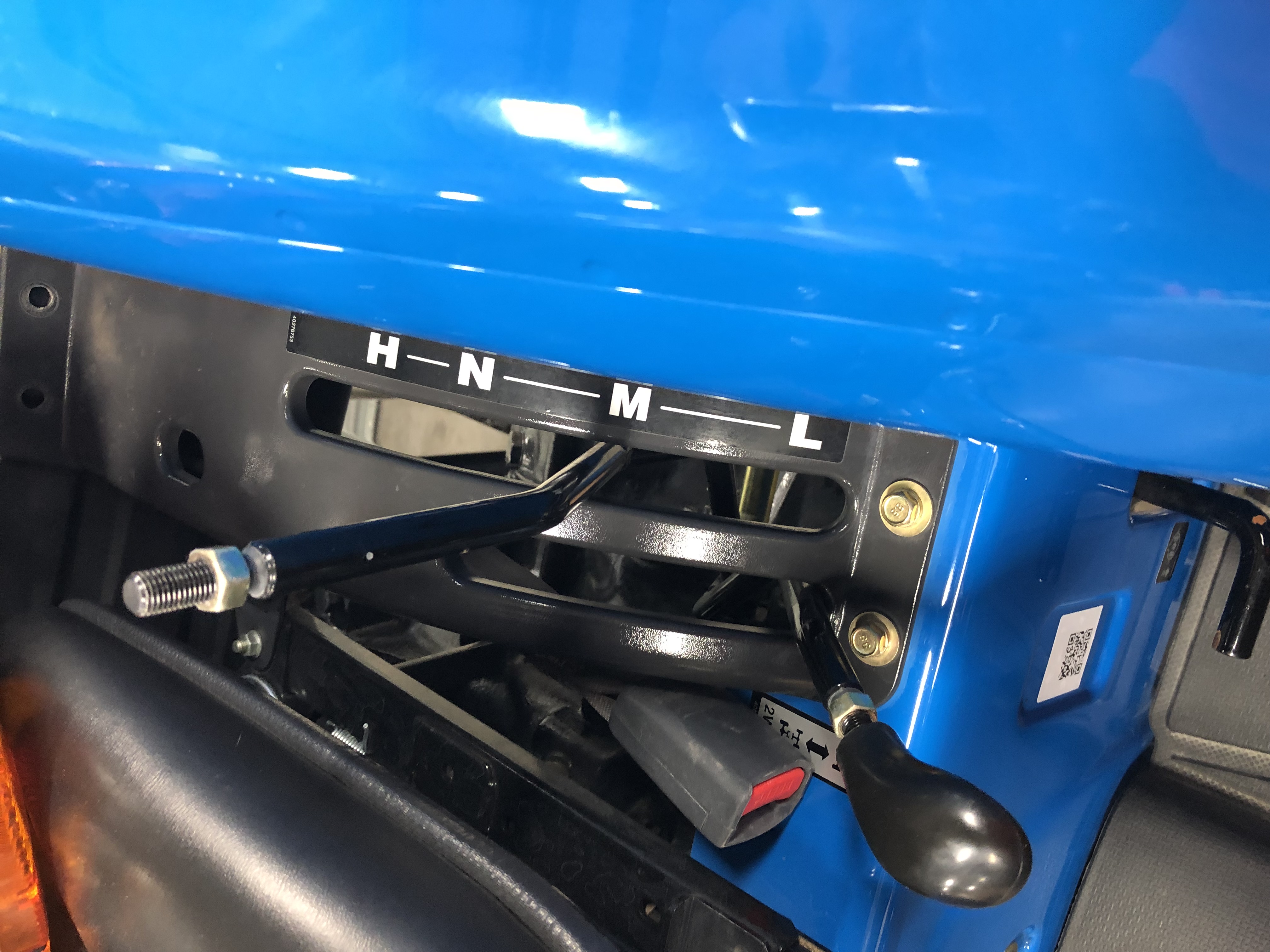

Next on the list was to remove the handles for the range selector and the 2wd-4wd lever. After that was done, you can take off the plastic bezel. This bezel is attached to the ROPS frame support. Make sure you get the two back bolts.

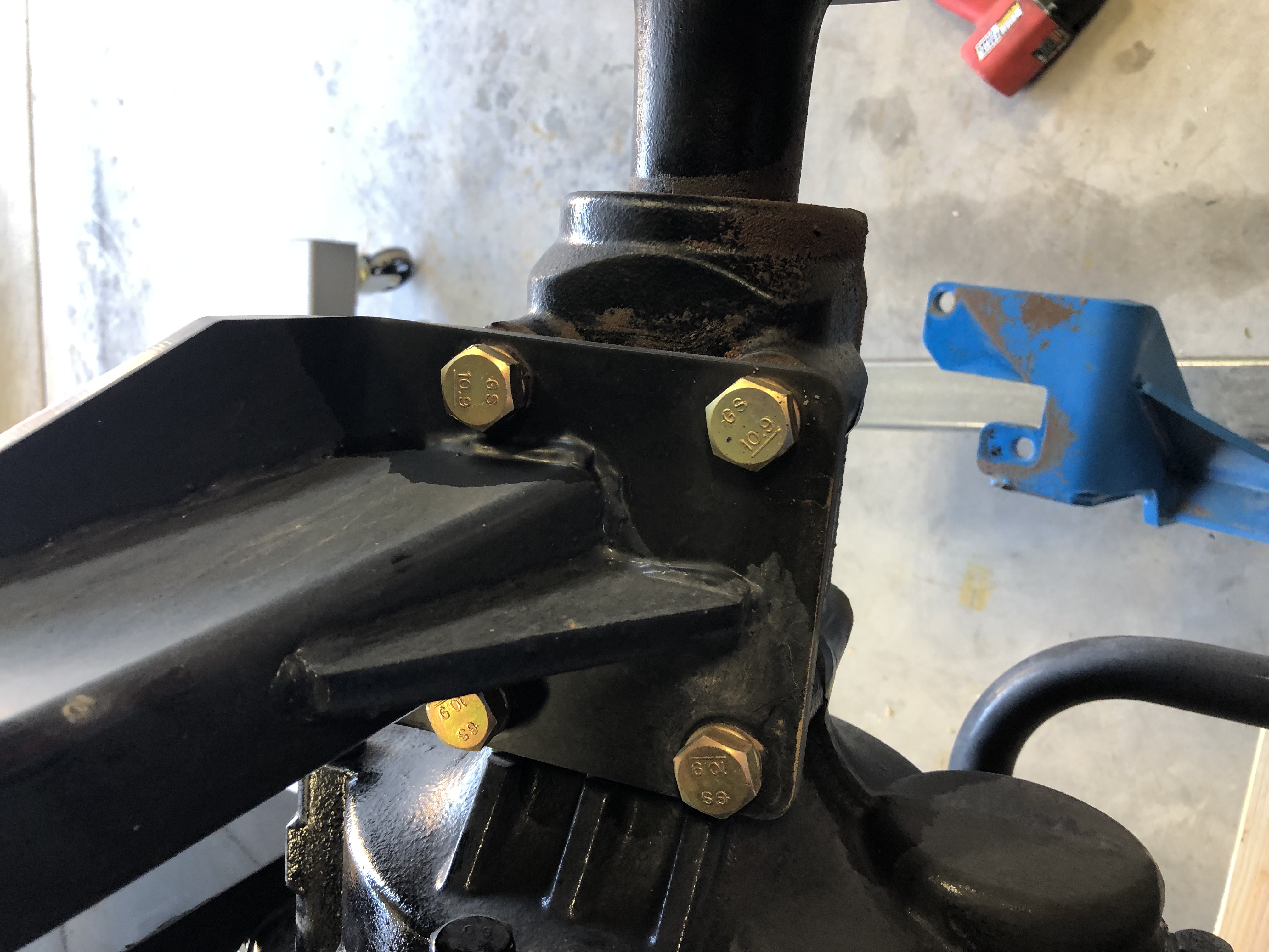

After that was all completed, I than finished taking the 4 bolts out of the ROPS frame supporting rail system on top as well as the 4 bolted to the rear final drive casing.

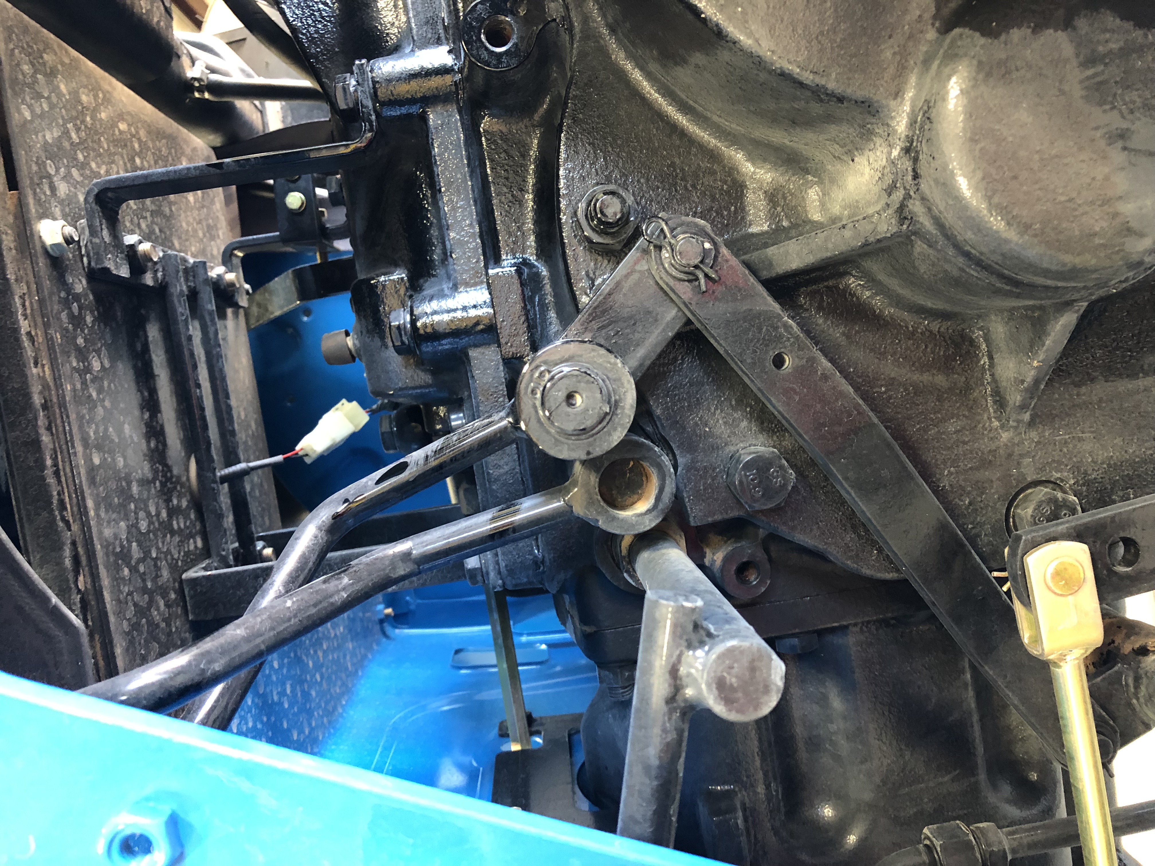

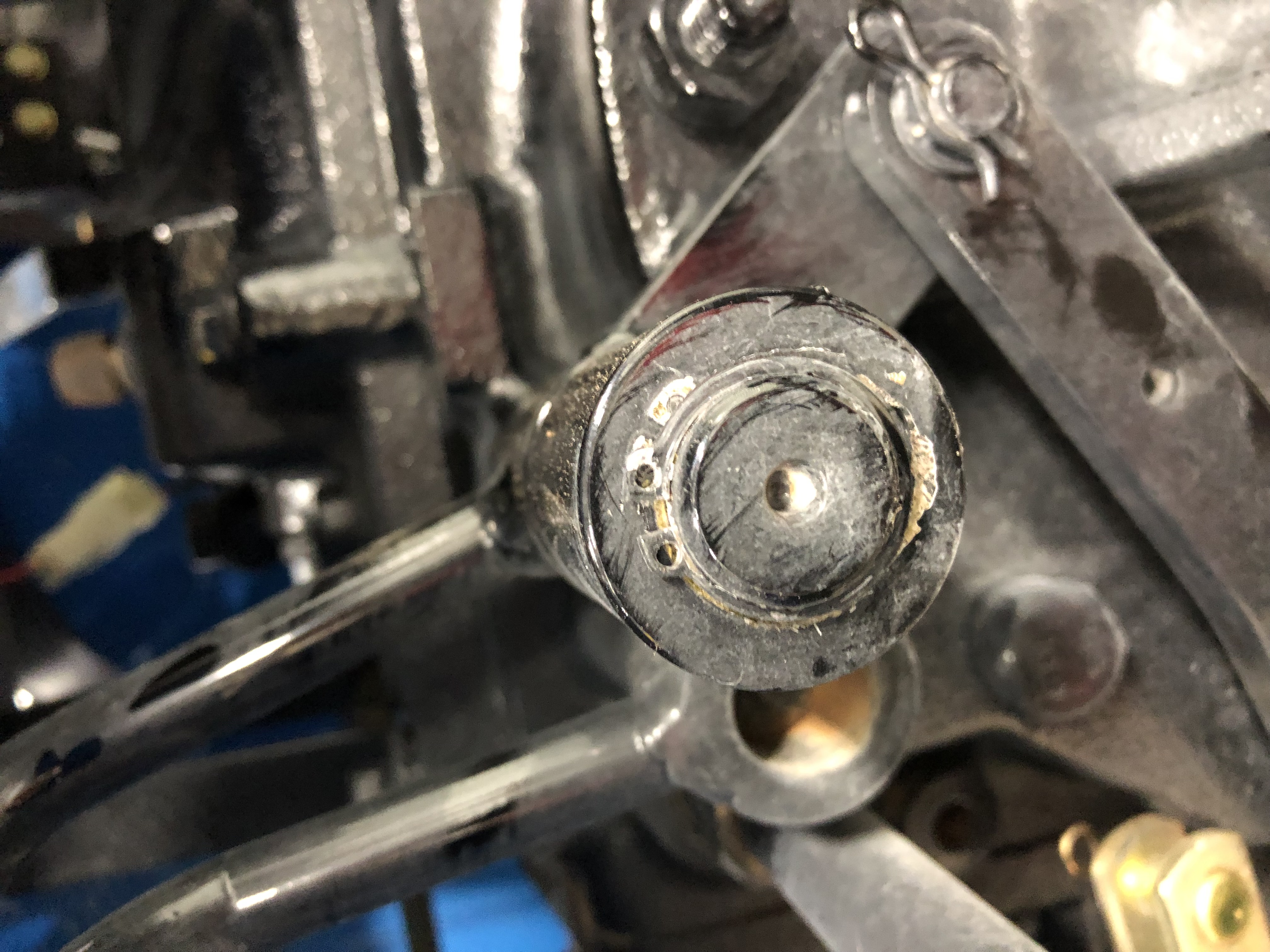

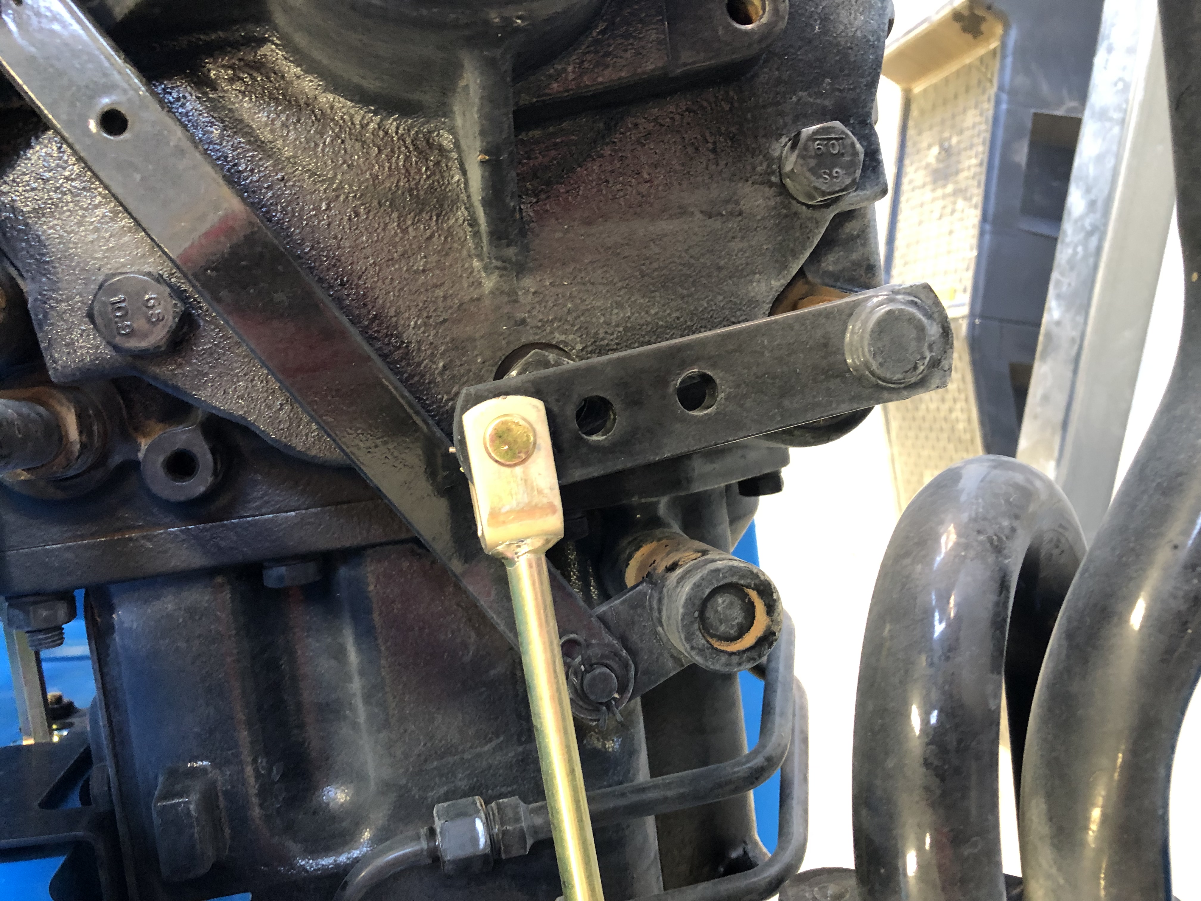

Once that was complete it was now time to take the linkages off for the range selectors, and the brake assembly.

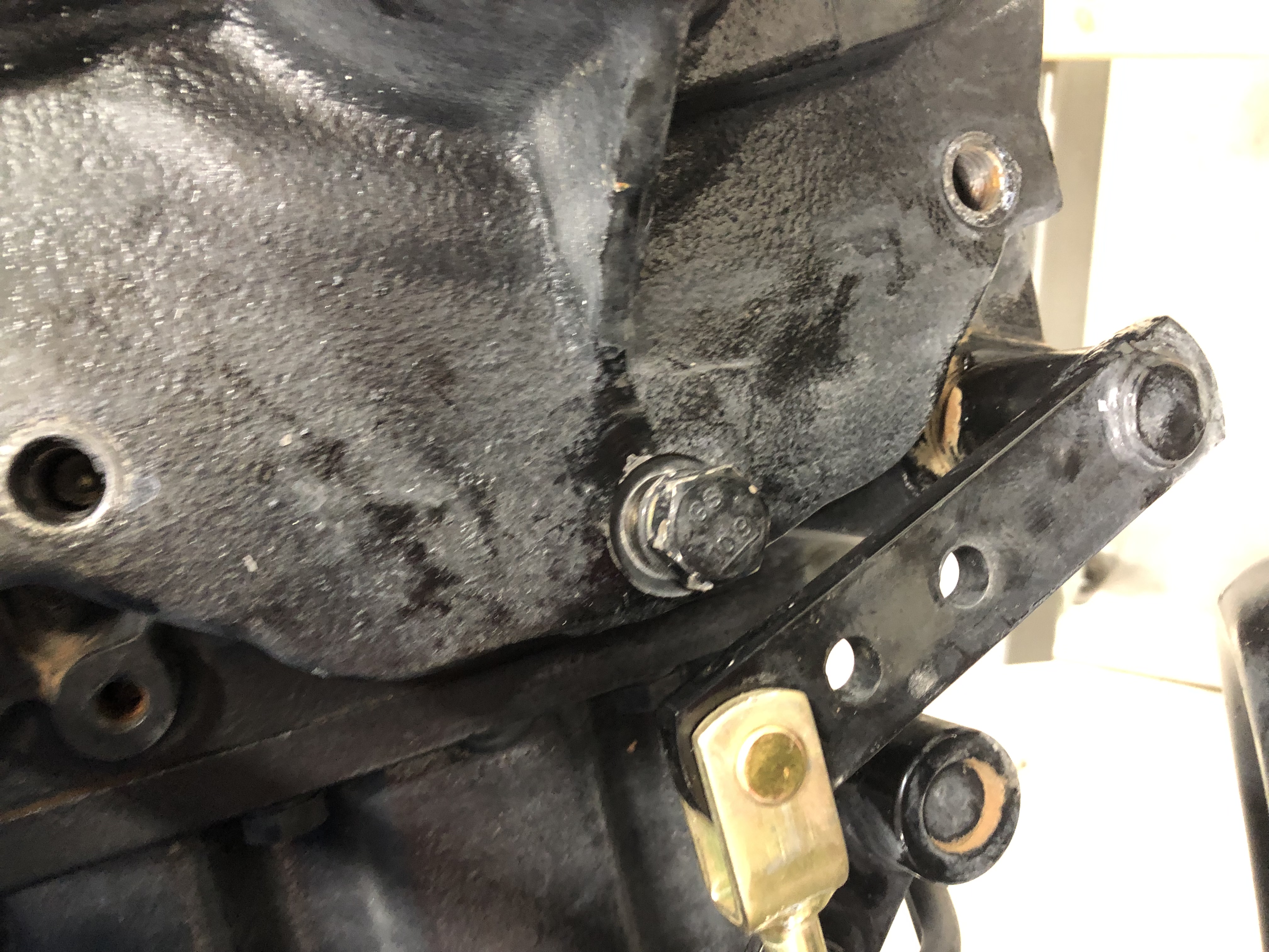

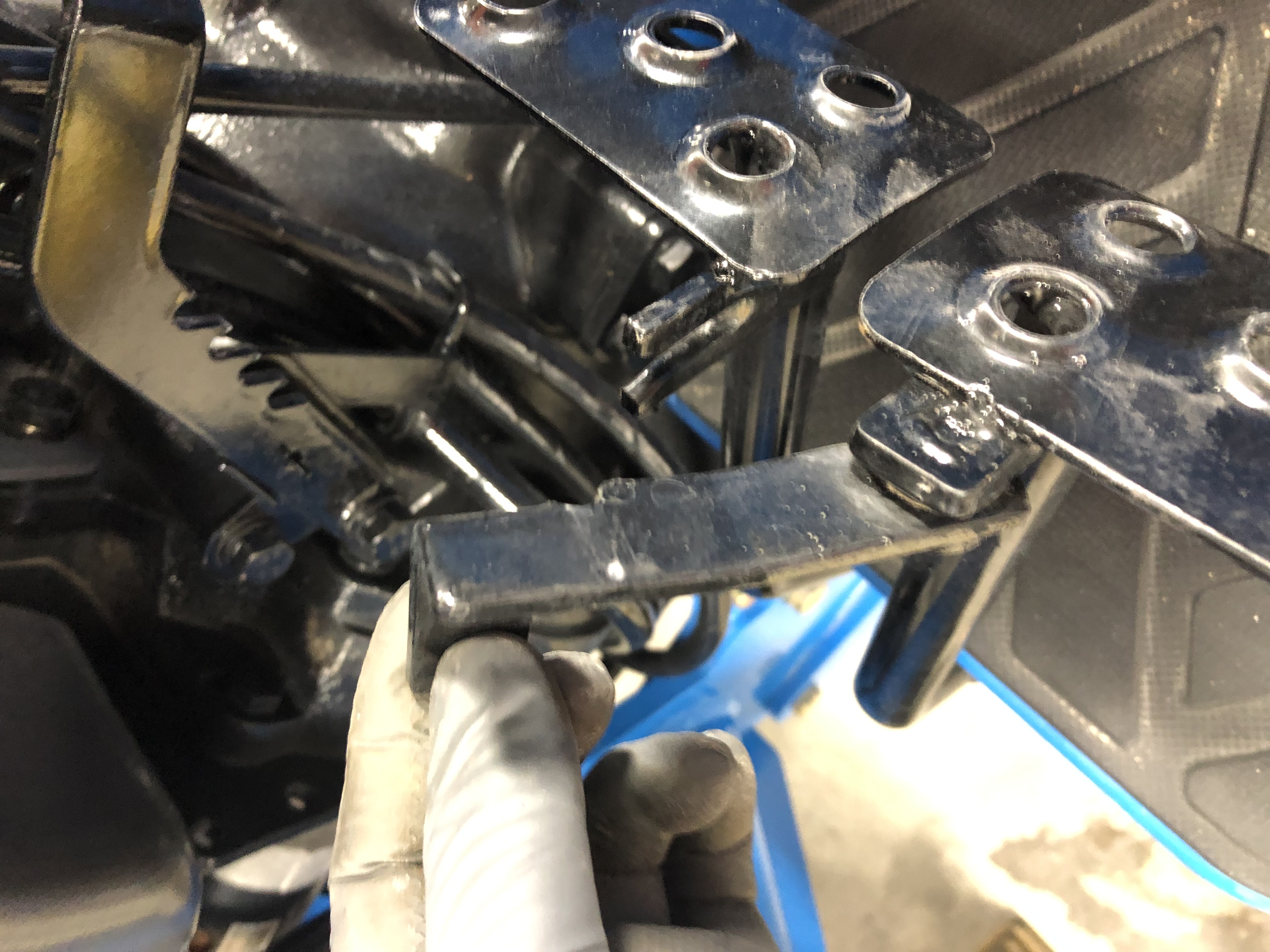

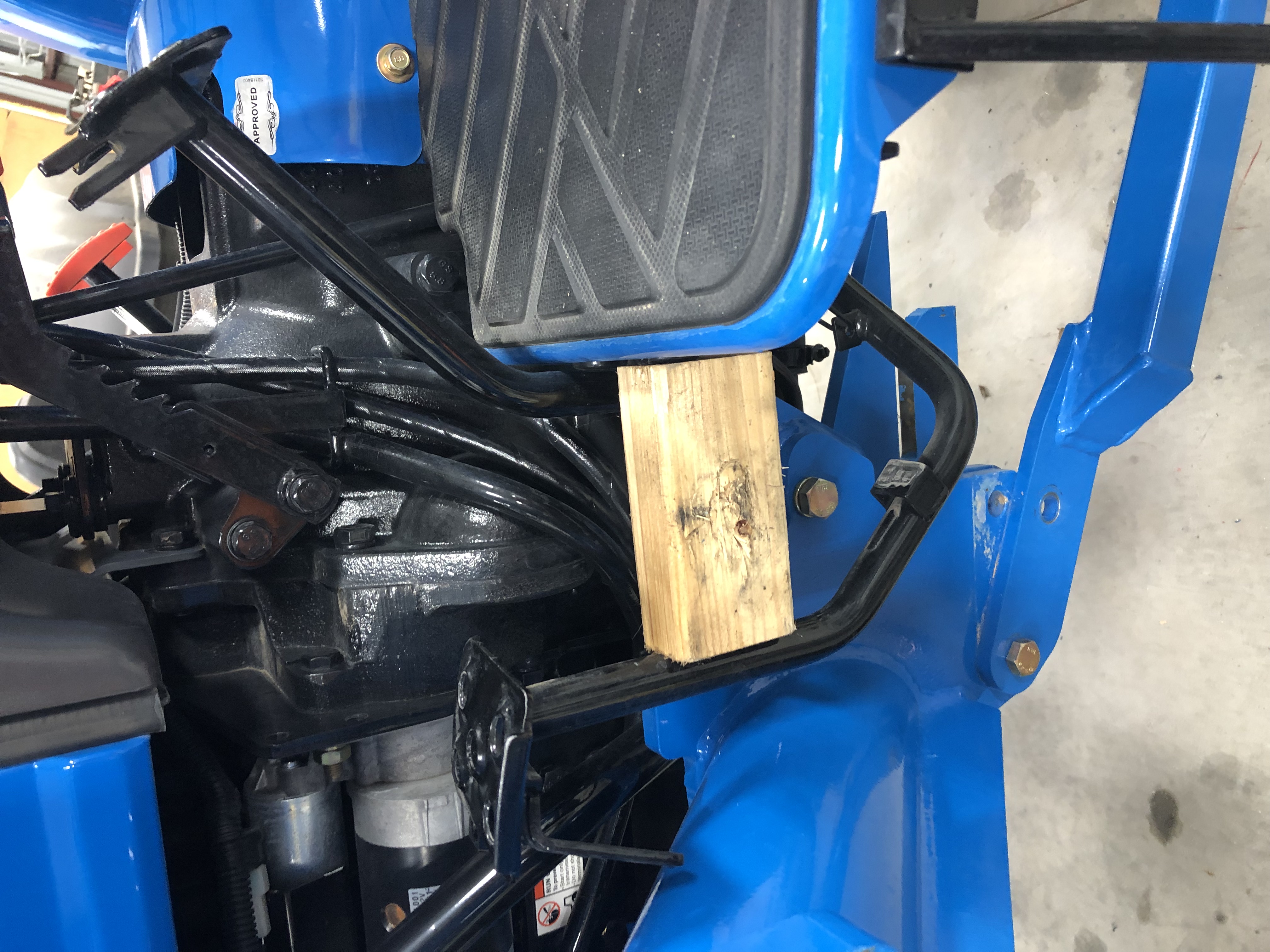

This part is "CRITICAL" in order to take one of the bolts out of the final drive hub, you will have the brake actuating lever in the way. You "cannot take this out for this procedure!" If you attempt to take this lever out, you will cause harm and the braking assembly will come lose in the transmission. In order to get the brake actuating lever out of the way. The first thing you will do is disconnect the pedals acting as one.
After you disconnect the two pedals, you will now either need a second hand, or in my case I used a piece of wood to wedge the pedal down so this would move the brake actuator lever away from the bolt.
