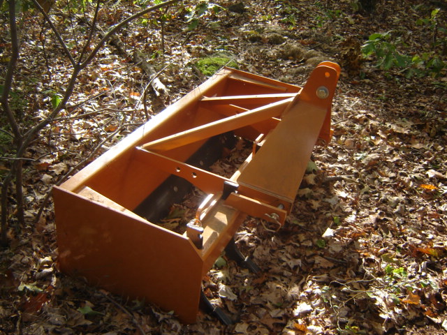

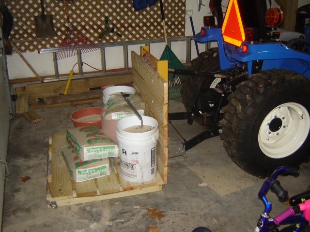

And finally some photos's - sorry no action shots. Tractor and attachments.

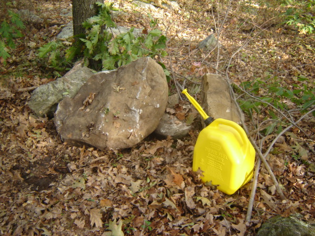

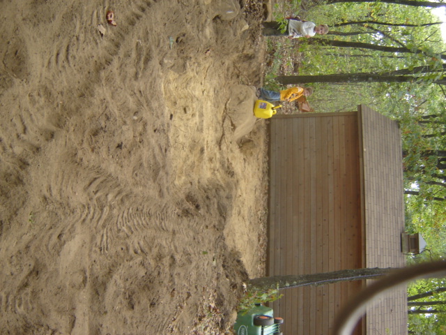

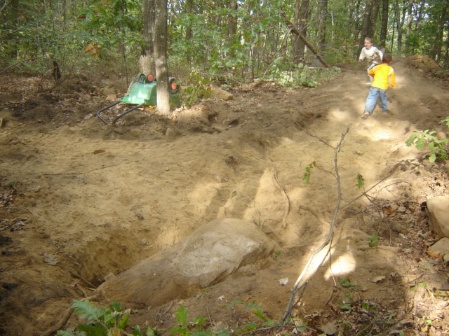

And some photo's of current digging out for slab footing on shed enlargement. One picture is of rocks that I could move, and one is of a rock that I couldn't (you decide). The 5 gallon can is there for perspective. And the kids are there ..well just cuse they are :D

Is that soil really as rock free and sandy as it looks. If so with that easy digging just dig a deep hole next to where you need the foundation push the rock into it.
