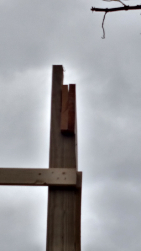

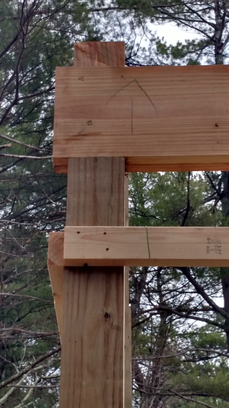

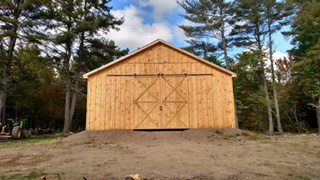

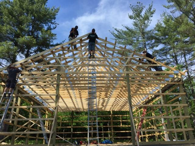

I just built a similar sized pole barn last year (32x40) and your required to notch the top of the 6x6 to accept the 2x12 header for the trusses or stick frame roof and joists. I would have no issues with using hangers for that small of a span. The 2x10 joists are plenty for a standard live load over a 12' span. Here are some pics of mine if it helps at all. Good luck and keep us posted. Pics are a must
