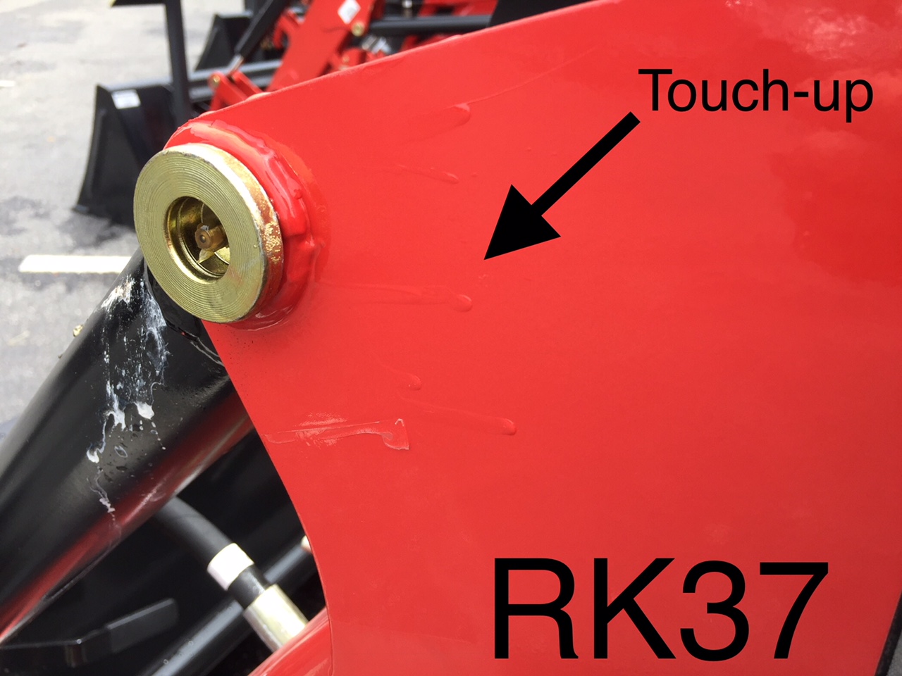

Both models appear to be made of quality components with a good layer of paint on the hood and side panels. I saw very little rust spots on those sitting in my local RK parking lot. However, one of the RK37s clearly had touch-up paint applied around one of the loader's pivot points. It was the only tractor that exhibited this condition among the three RK37s on the lot (and exhibited it on both sides of the loader). Touch-up concerns me on a brand new machine. What went wrong with that component that required touch-up? A bad weld around that boss that had to be redone? Who knows. Anyway, as shown in the pics below, the touch-up appears to have been completed by someone with an itchy trigger finger on the spray gun. There's also what I think to be adhesive residue (glue/tape?) in this same area, maybe from taping off the touch-up spot. Personally, I would not purchase a tractor that exhibited this trait. I just can't see paying that amount of $$ for shoddy paint work, much less what the touch-up implies about the specific history of that tractor. It wouldn't deter me from getting an RK37, just not this particular one.

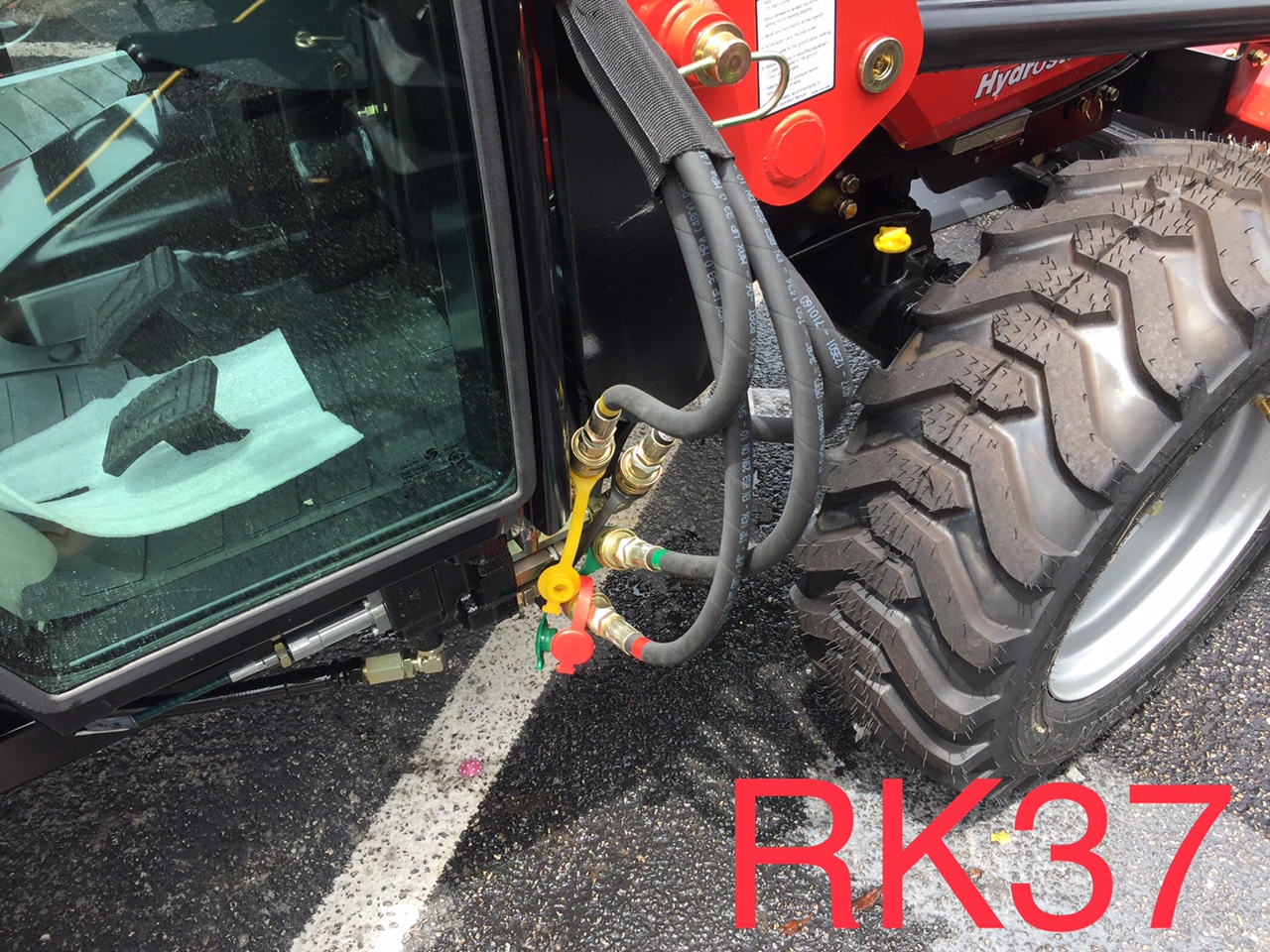

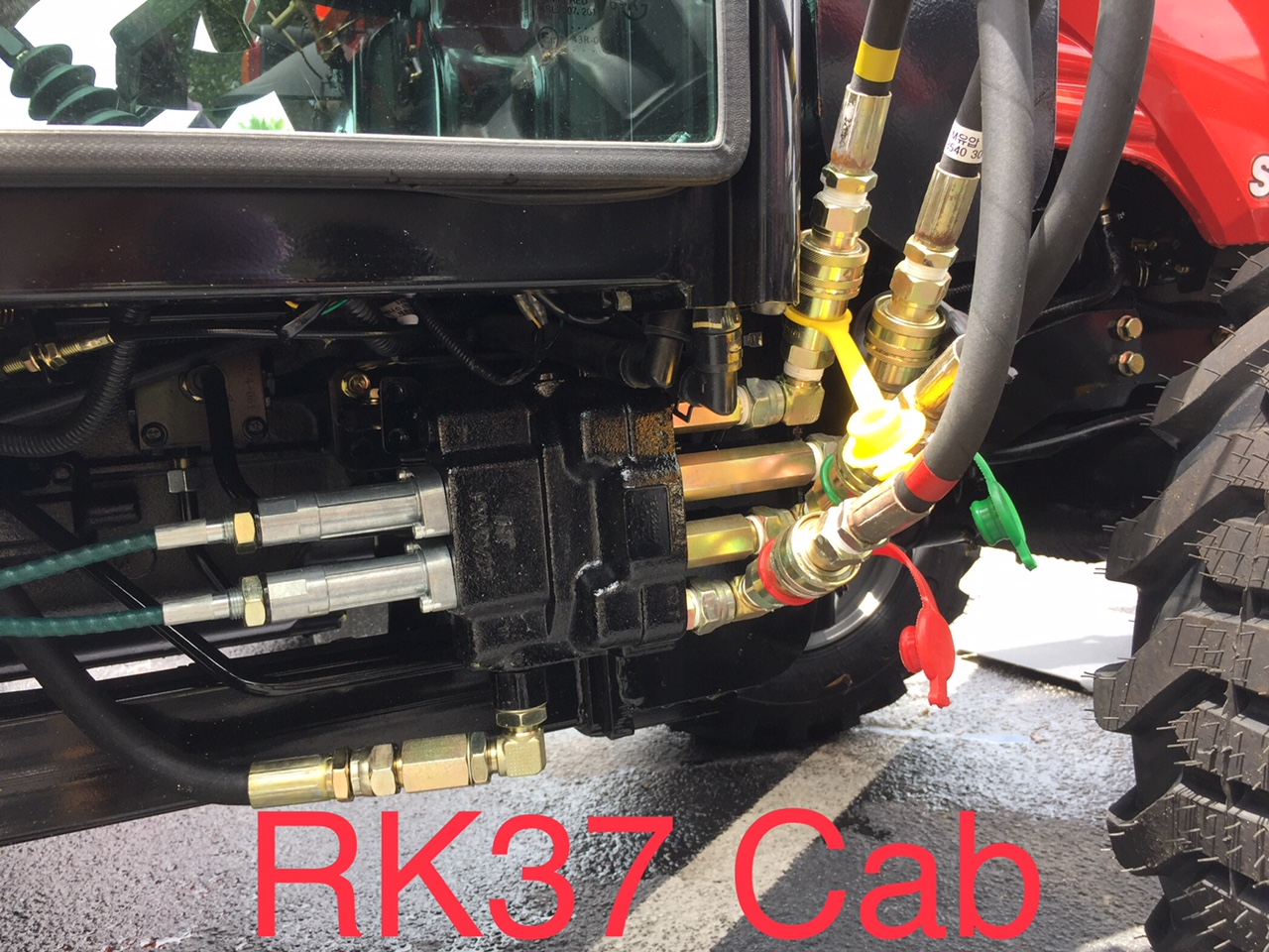

  1. Hydraulic Routing - The hydraulic hose routing on the RK37 is just poor design in my opinion. The hoses jut out 90 degrees from the tractor and make for a nice big target for anything the front tires may throw up (large branches and such). The RK55 keeps the hoses parallel to the tractor body like my Massey, which I wholeheartedly prefer. If you're going to be operating on ground with little to no debris, this may never be an issue for you on the RK37, and may not even be an issue in debris laden areas. I'm not that lucky, and this kind of hydraulic routing is a real concern for me on the RK37. Pics provided below for reference.

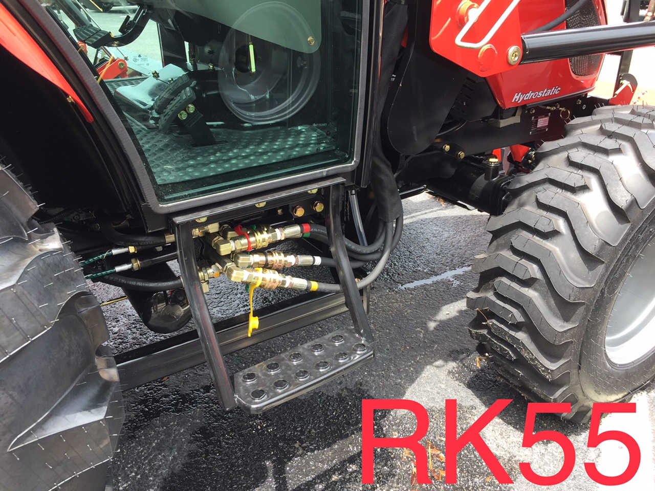

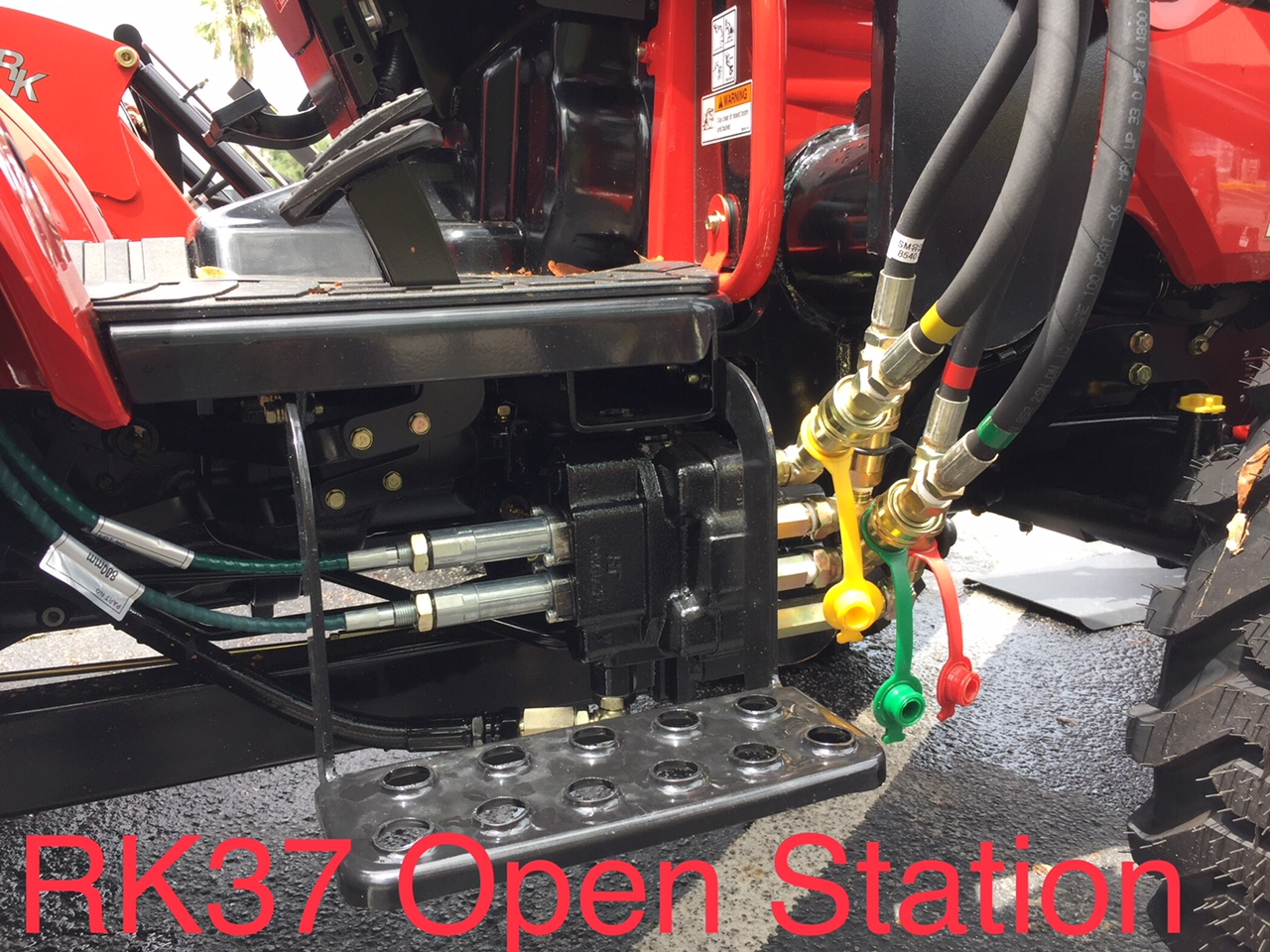

  2. Cab Steps - The RK55 has steps on both sides of the cab, the RK37 only on the left side. Interestingly, the RK37 open models have steps on both sides. There is a slight change to the mounting area on the cab models that does not permit the installation of the step on the right hand side. Even more interesting, the open station RK37 models use different lengths for the loader hydraulic hose fitting extensions than the cab models. Actually, they may be the same lengths, just used in a different order. See below. The red hose uses the longest extension on the open station model, allowing it to be turned vertically and tucked behind the other hoses. On the Cab model, the red hose uses the shortest extension, requiring it to be turned out almost 90 degrees from the tractor body and being the basis for my gripe above. I assume this is simply because adding an extension to the red hose on the cab model long enough to enable it be turned vertically would likely place a lot of stress on the fitting and could lead to leaks. To sum it up, the hydraulic routing on the RK55 is fine, on the open station RK37 marginal, and on the cab RK37 poor (IMHO).

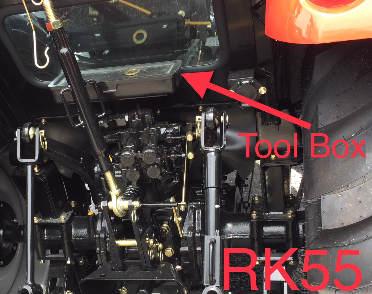

  4. Tool Box - The RK55 comes with a small "utility" box mounted on the back, while the RK37 has a similar box mounted under the left step. I would have to replace this on either tractor because it's just a cheap plastic unit similar to something you'd keep fishing lures in. I need something with a latching top to hold tools. I wouldn't trust this one to stay closed on my rough land.

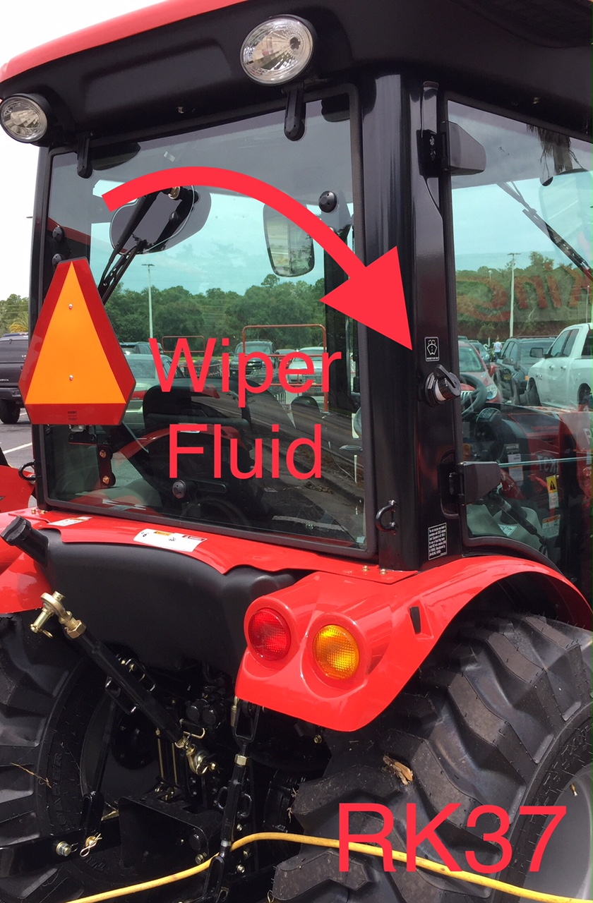

  5. Windshield Wiper Tank - I love the clean design of the RK37 cab that hides the washer fluid in the rear right cab pillar. The RK55 slaps the washer container on the back in what appears to be an afterthought in my opinion. Not a big deal, just looks kinda funny hanging off the back when compared to the RK37.

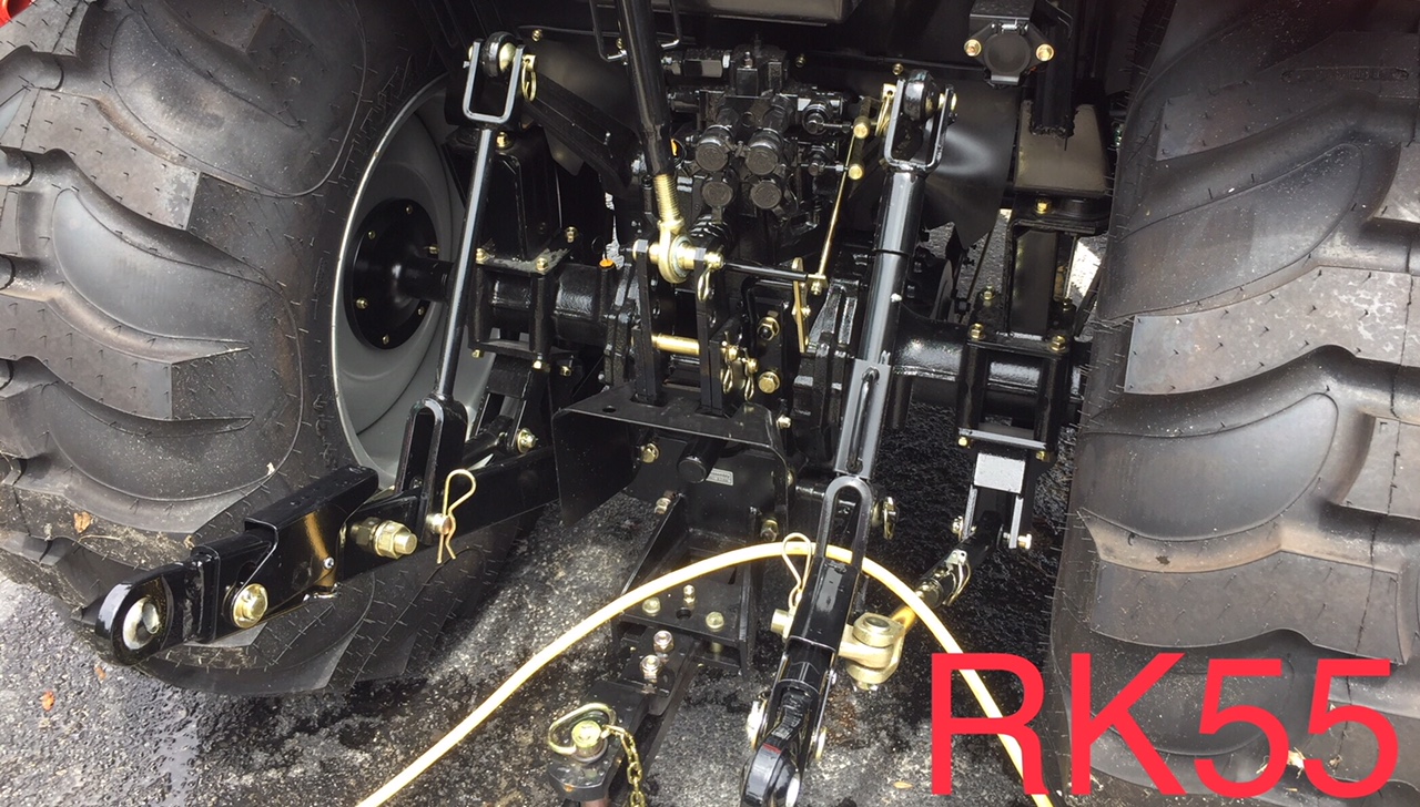

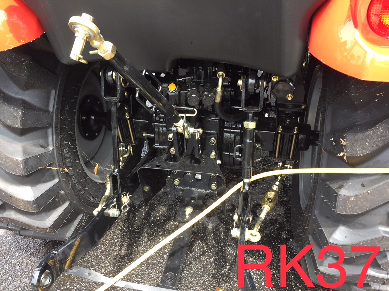

  6. 3-Point Hitch - The RK55 has a really beefy 3pt with telescoping arms and quick sets on the sway links like my Massey where you just move a pin to a new hole when you need to adjust the left/right sway. The RK37s sway links are threaded rods you have to screw in/out. I'm not sure what the benefit is of the telescoping arms on the RK55 so someone will have to school me on that, but if you change rear implements regularly, I can see the threaded bars on the RK37 becoming a pain. On the other hand, they do provide infinite adjustment so some may prefer that over the pin/hole setup on the RK55. I typically use a mower year round that stays on the tractor, so this isn't a huge decision factor for me.

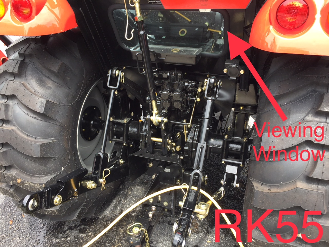

  8. Cabs - The RK55 has a rear lower window that allows you to get a better view of the inside of your rear tires. I find this to be helpful to check that your sway is dialed in correctly and the sway links aren't biting into your tire lugs during sharp turns. Granted, I haven't sat in the seat so I'm not sure how easy it is to look through once you're in the cab. If you can look out of it while driving - that's a great addition.

Currently, I seem to be stuck on what I perceive to be the poor hydraulic routing of the RK37. With the creative use of a combination of fittings and extensions, I may be able to alleviate that concern. If not, is it worth an extra $5k to me to upgrade to the RK55? When you factor in some of the additional options you get with the RK55 (that I may never use), maybe. I'm sure there's other things I'll note when I get a little seat time in one of these tractors. As of now, these opinions are based upon a brief walk around of the units. If anyone who owns an HST RK55 or RK37 has any comments to make regarding my likes/dislikes, I'm all ears.

g8erh8er, this is a nice write up. The only thing I saw was the mention of no tool box on the RK37. Mine has one mounted under the step but it's cheap plastic as is the one on the 55. That is one crappy paint job on the loader. The way the paint runs though makes me think that it might be from the manufacturer and the unit dipped instead of sprayed. I would think if that was from a spray can the paint would be running down, not sideways. Either way, it's still crappy......Don
   / First Impressions
Thx for the clarification on the RK37 toolbox Don. Good to know it has a spot for one.
As for the paint, the pics may not show it well, but it was a slightly different shade and texture than the rest of the loader paint, hence my assumption that these are touch-up areas.
My guess is that these were touched up while the loader was not installed on the tractor, but likely hanging from a gantry in an orientation that caused the drips to travel that direction.

I thought the RK tractors had all metal bodywork? Looks like they sprayed with the piece hanging up on the loader end with the way the paint ran. Entire chain is only as strong as its weakest point - got someone who doesn't give a crap about how something looks.

Nice review! I agree with you on the paint. Anyone on the line can have a bad day, but someone should be checking them over before they leave the plant and sending them back to do it right!

As for point #6, I really like the telescoping arms on the RK55. It's really nice when I'm not quite squared up to whatever implement I'm hooking up to. just get within a couple of inches and a little lower than the pins and you can easily lift and extend the arms to hook up. Back up a bit after you're hooked and they lock back in place. I also like the pins on the anti sway bars. I used an old JD years ago that had the screw kind and, even though I only used a brush cutter, it would loosen up after a while and I'd have to tighten them back up to keep it from swaying back and forth especially when going from forward to backing up. The pins help keep it nice and tight and the implement swings right where you expect it to. Also, I believe, in Sept or Oct?, the RK37 and RK24 are supposed to be getting the same kind of arms.

Thank you RTBee and Turbys for clarifying the telescoping arms. My Massey does not have them so I did not know what I have been missing. Currently my 39 year old back is capable of muscling an implement around to get things lined up, but I do not expect that to last forever! I also did not consider the threaded sway links loosening over time - that would be a huge PITA to me. Duly noted.
