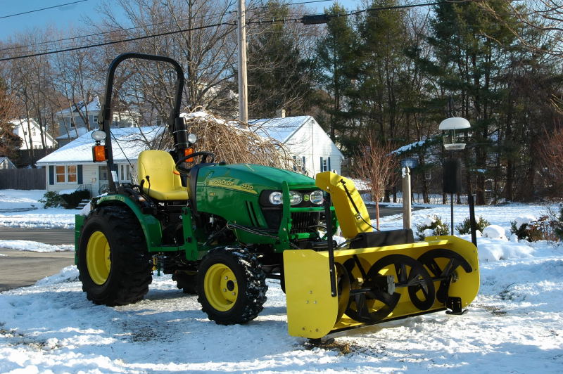

Hi Dale,
I'm sitting here in Portland half-way between my family in Maryland with 20" of snow from last week and my wife's family in Presque Isle with 8 new inches from this week, and I got nothing but frozen slush!
The day it fell the blower cruised through 4" of slushy mush without skipping a beat. Later I adjusted the shoes to lower the blade for a cleaner surface.
I can attest that 3/8"-3/4" gravel as well as big dog poops are ingested and exgested with no trouble or damage to the blower at all.
There doesn't seem to be any vibration in the drive system, I could find no quirky behaviour at any engine speed or blower height above ground.
That's all I've got for now. After we get some real snow and I have an opportunity to run it for more than a few minutes I'll send you an updated report.

The 54" works really well, it seems to run quieter then the 47" and the starting load on the clutch seems lighter (perhaps due to the lighter weight of the plastic impeller). The extra width is very noticeable and really reduces the snow packed down by the tire overlap. The plastic impeller does not have the "hooks" on the the blades like the steel impeller, I don't think it throws dry snow quite as far but very wet snow seems to throw better.
I give it a "thumbs up"
