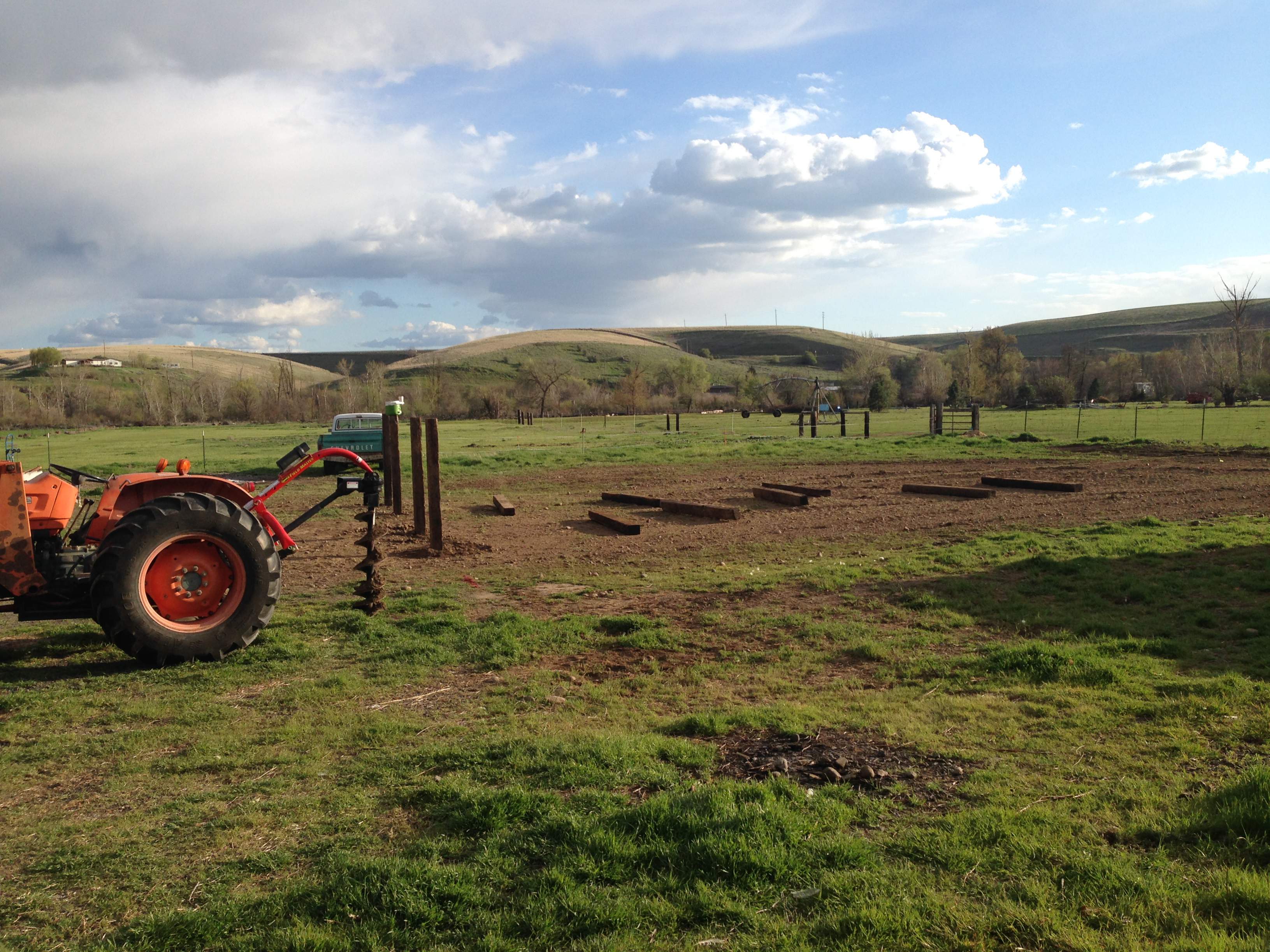

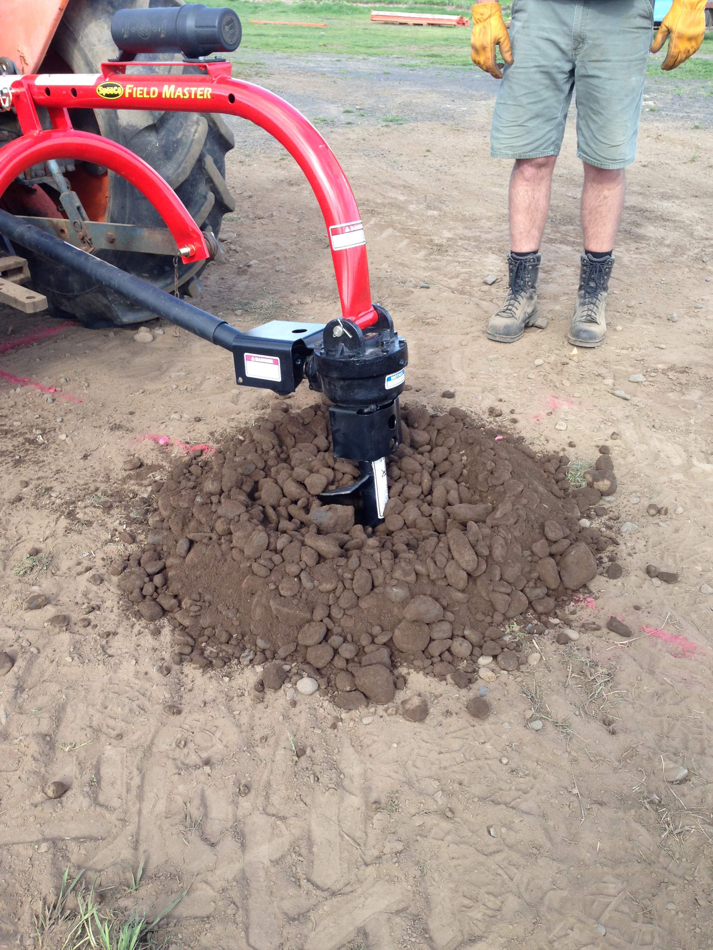

Putting in a Pig Pen for our Hereford Pigs. Lots of raking and post hole digging.

Awesome first pic ! Love that sky, thanks for shareing. Play safe with that PHD.

That first picture stands to be a time piece for sure, good you waited for a cloud to cover the machine, made the exposure nice.
Have fun on the new tractor.

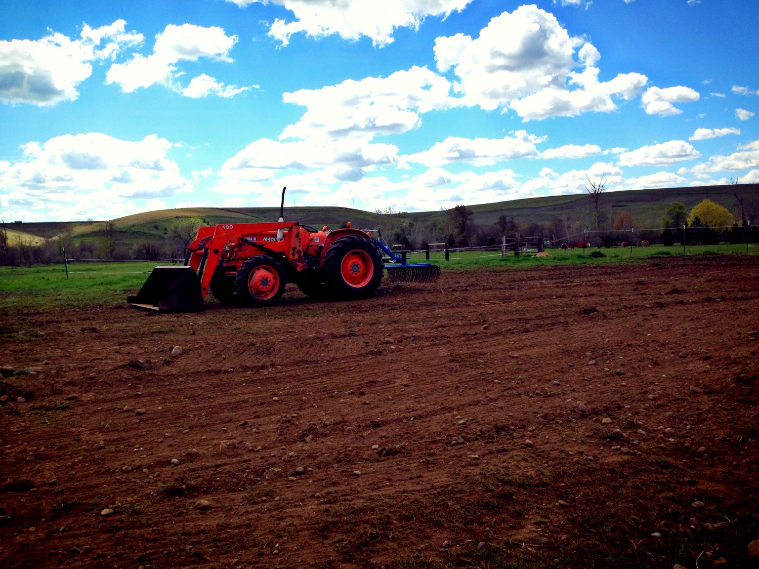

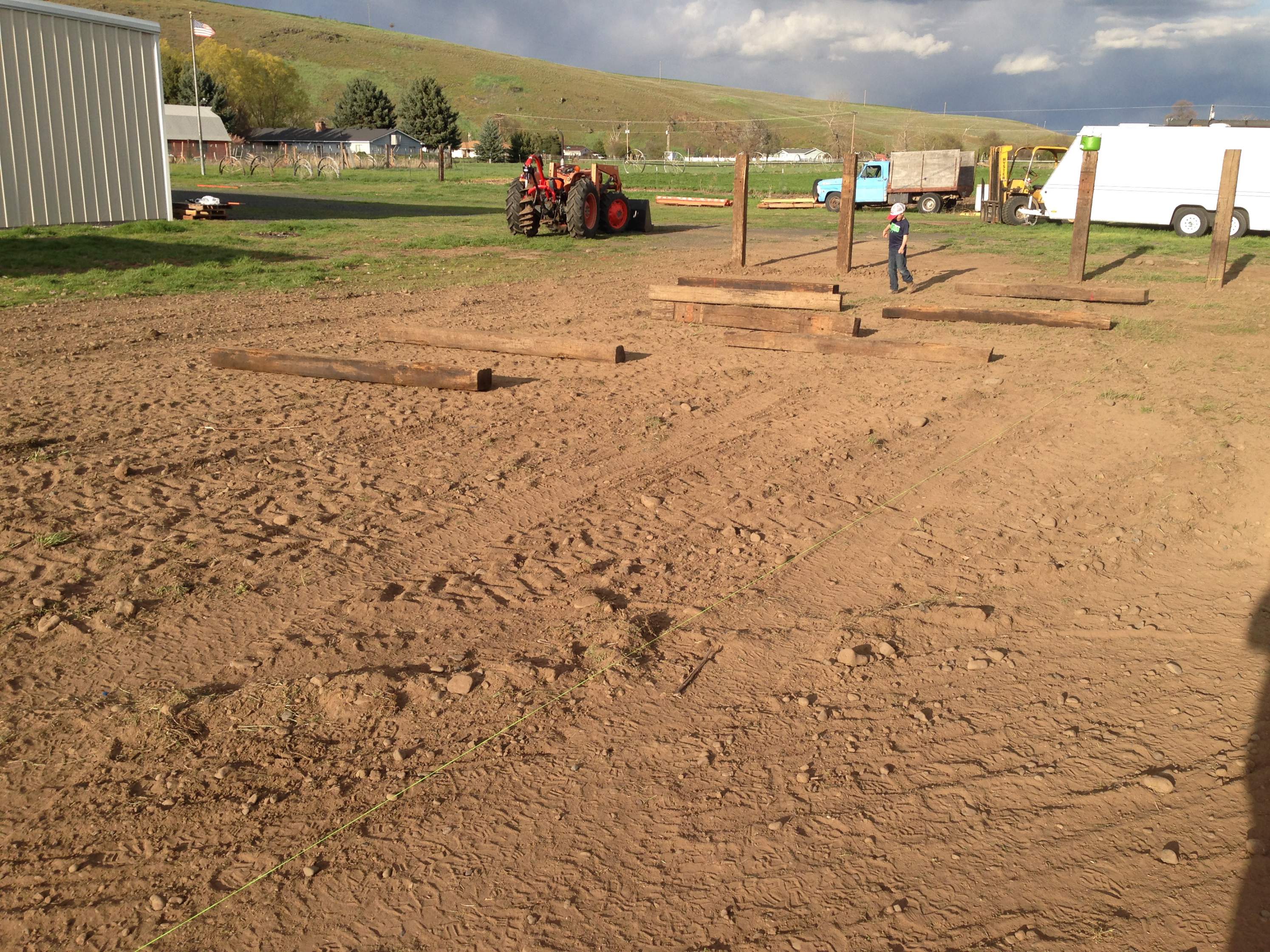

Thanks! It is a 1981 M4500DT. It has already been a huge asset. We also learned a few tricks using a PHD in a rocky area (Only took 6 holes).

You are correct. Every once in a while we get nice dark loamy dirt, but it is about 4 to 1 on each hole we dig.
The trick is:
- auger at idle
- auger a foot down and stop auger
- remove rock and debris around auger
- start again go as far as you can down.
- pull auger up a bit remove debris
- Rinse and repeat.
Holes were taking 30 minutes to complete are now taking 10 minutes

Looks like life just got a lot easier.
Nice Chevy.
