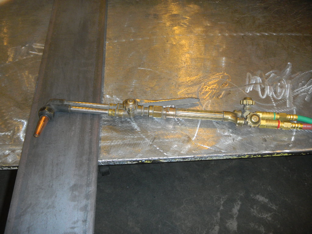

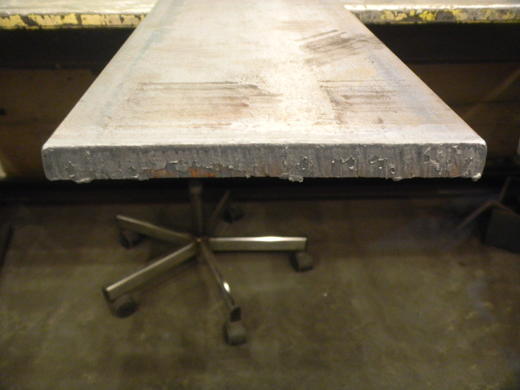

All this talk about using propane to cut / burn with. I got to thinking, I haven't burned with propane since the mid 1980s. Worked on a joint venture with another company, they were the prime, so we used most of their equipment. Anyway, 1/2-inch thick flatbar, # 2 propane tip in my Victor torch. 10-pounds of propane, 40-pounds of oxygen. Not to bad, being as I can't even remember the last time I used a torch.:eek:

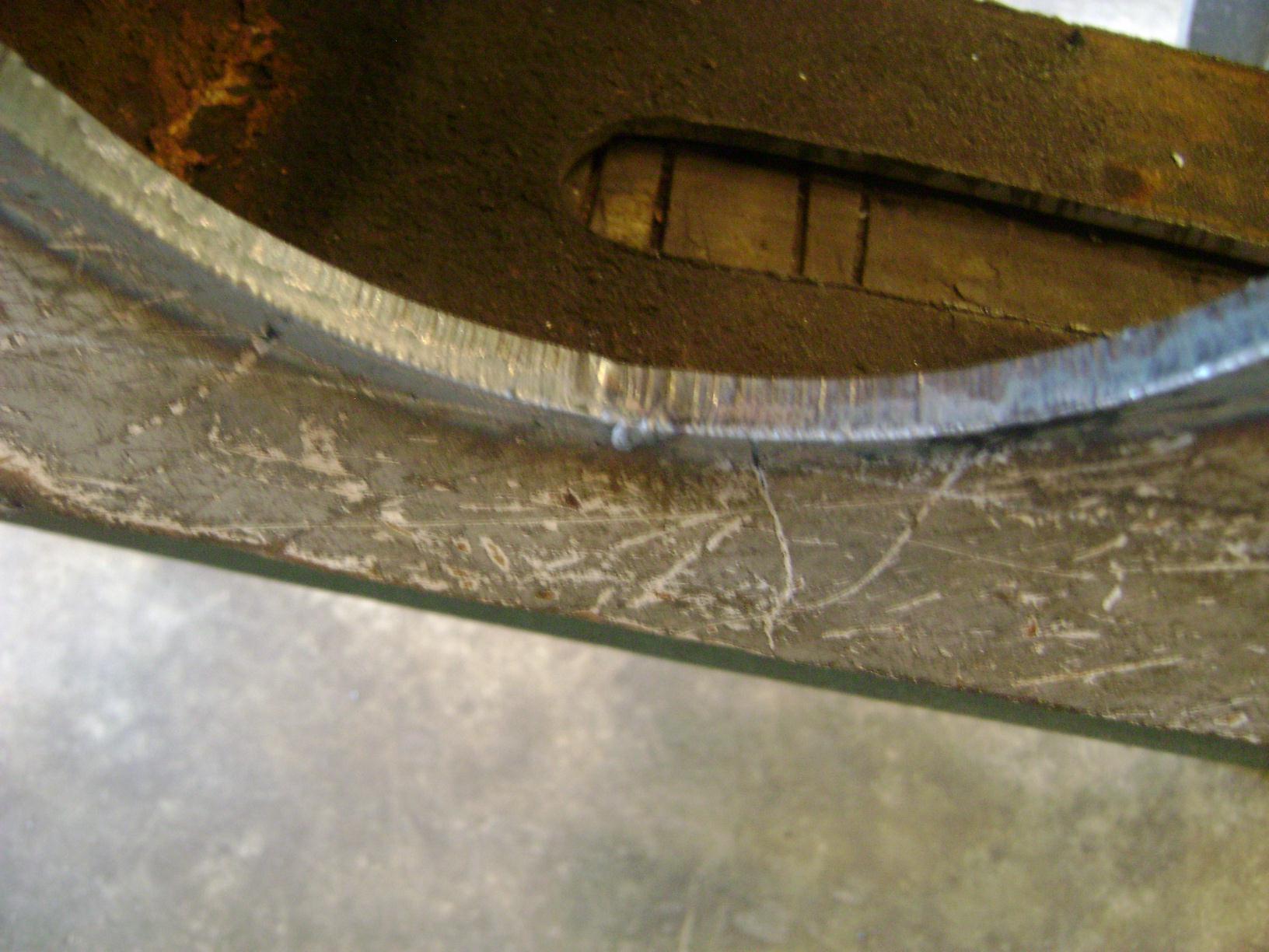

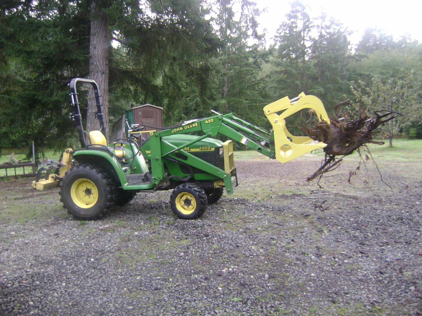

I remember now, the last time I used a torch was a couple years ago when I revamped the grapple to fit my tractor. I used the plasma to cut slots in the bottom, but used the O/A torch to cut the circles in the sides to help lighten it up.

What's your personal verdict?
   / First cut.
I'm not a real fan of propane, but maybe because I'm a creature of habit:eek:. That joint venture I was talking about, I was rigging full time, but got elected to go in on a Saturday to build a unit for a crane. So in my life time I have that Saturday, and this cut using propane! It's OK, nothing in the world wrong with it. If I had to throw any stones, I'd say it is just a touch slower than acetylene, but not by much. Well worth it for the difference in cost between propane and acetylene! :thumbsup:
