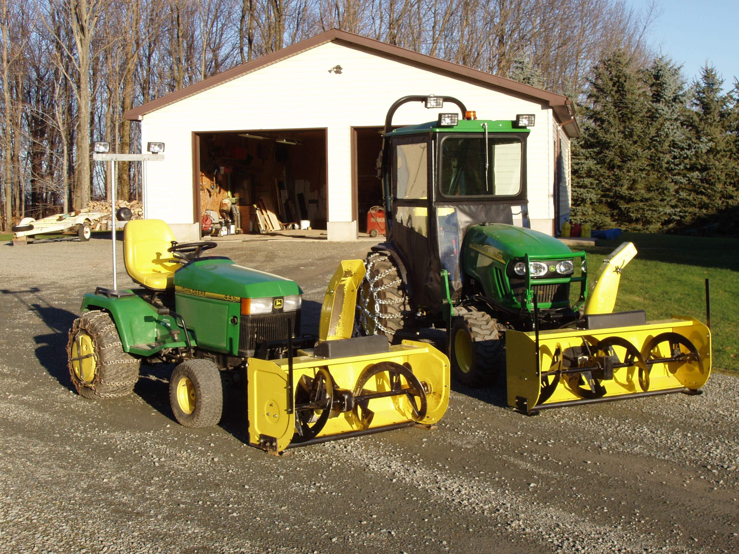

Finally got a chance to blow some snow with the new setup yesterday. Not alot but had to clear some drifts in front of the 2 garages. Sittin in the "original cab" on the new 2520 is sooo nice compared to out in the open on the 445. I had removed the scraper blades on both blowers and replaced them with 1 1/4" schedule 40 steel pipe with welded on tabs to bolt on using the holes for the scraper blades. It rolled over the gravel and grass really nice. So far I am very pleased with this mod.

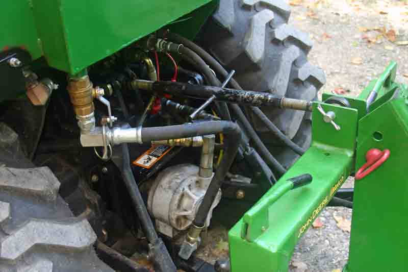

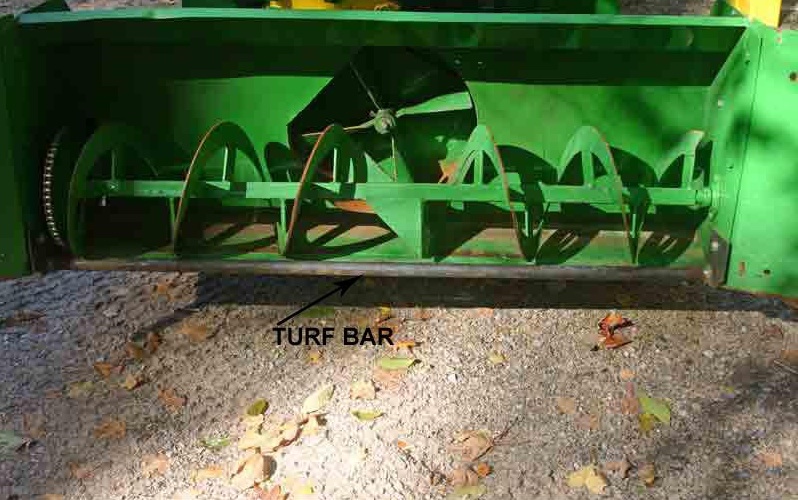

Built mine with 1.5 inch pipe also and a full length slot to fit over the scraper edge held on with tabs at each end So far has worked very well on my unfrozen gravel drive way much easier to set and maintain angle of "attach" Got idea from pickup snow plows that use them early on in the season to prevent tearing up unfrozen gravel and lawns 4 foot Erskine with total of 12 inches of wings pushed with JD 4300 Remove bucket from FEL and replace with blower Blower driven by external PTO hydraulic pump
