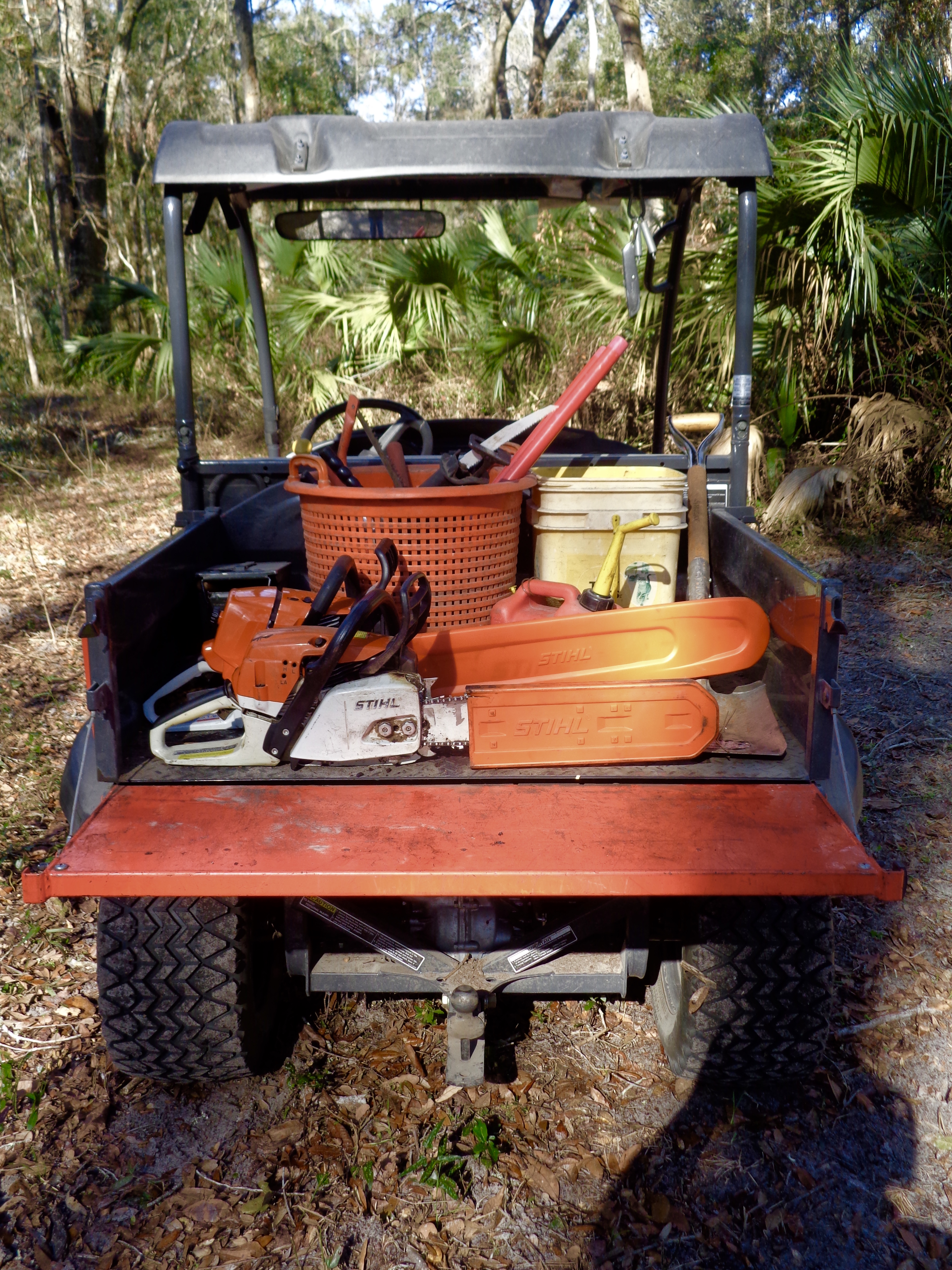

I do considerable chainsaw work, alone, in the woods. Have been sawing this way without incident for 35 years or more.
I keep several 8 X 10" "wound dressings" and velcro straps, in addition to a standard first aid kit, on my utility vehicle, which carries my saws.
Wound dressing are available at most large drug stores.
