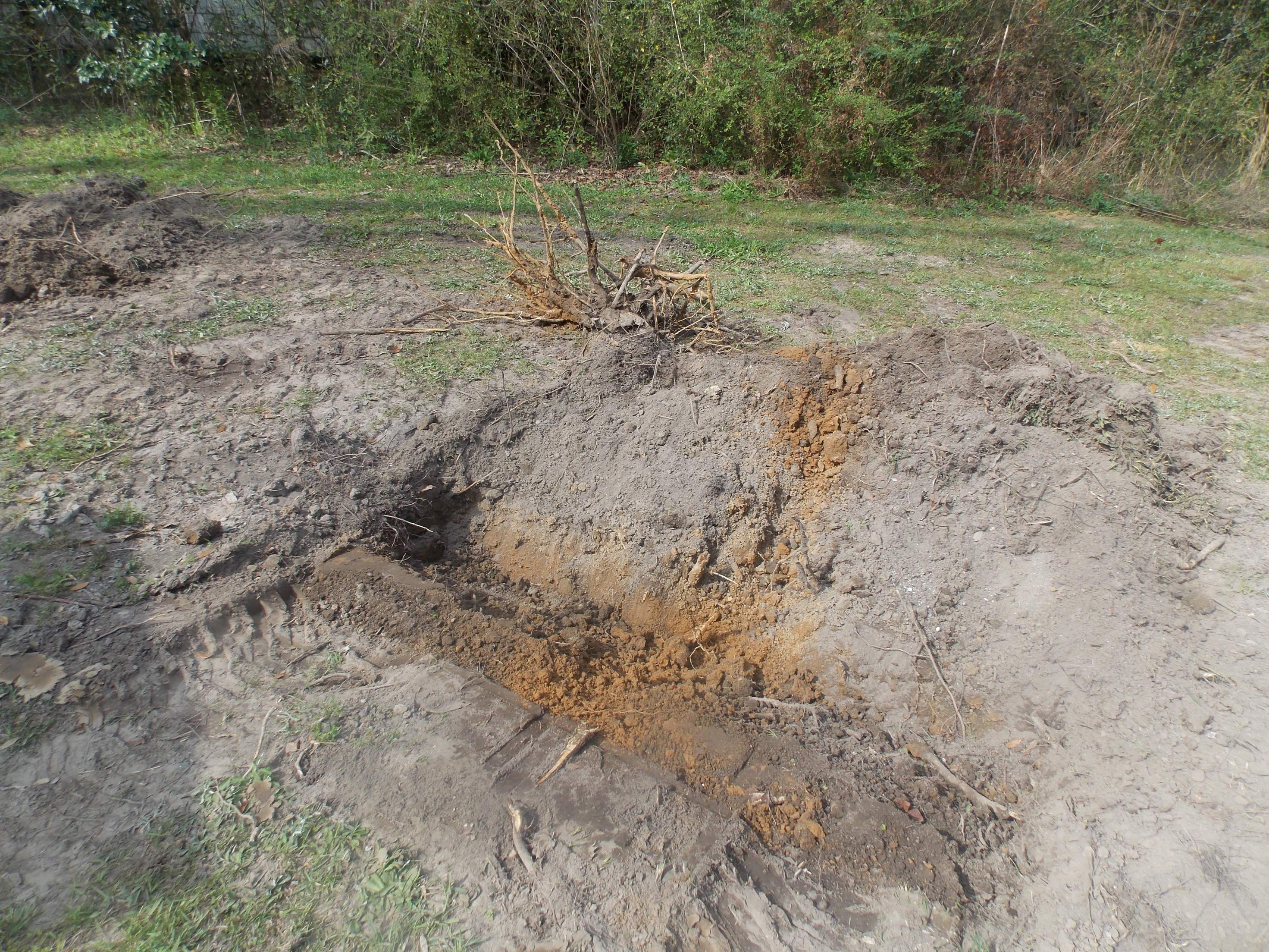

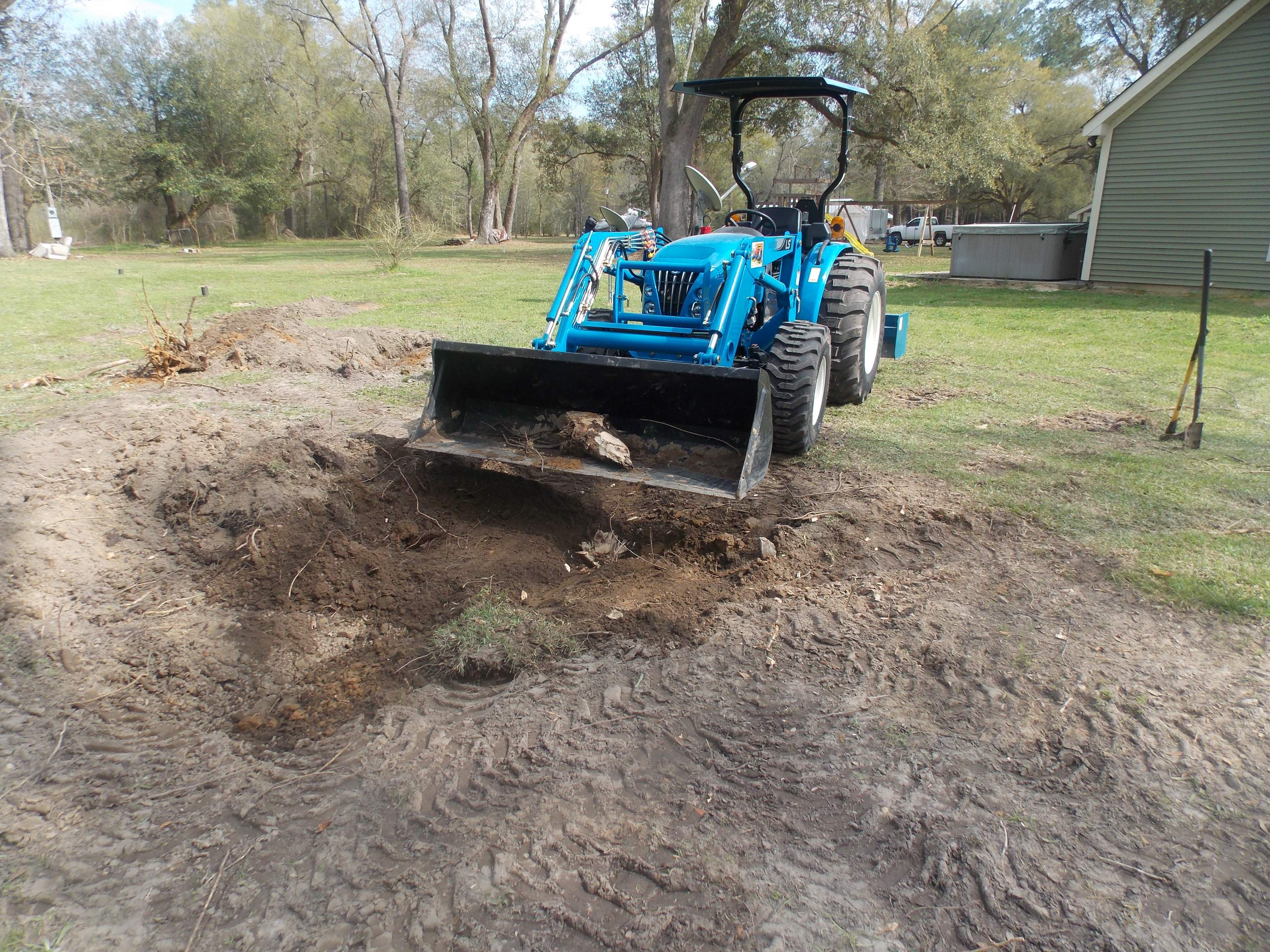

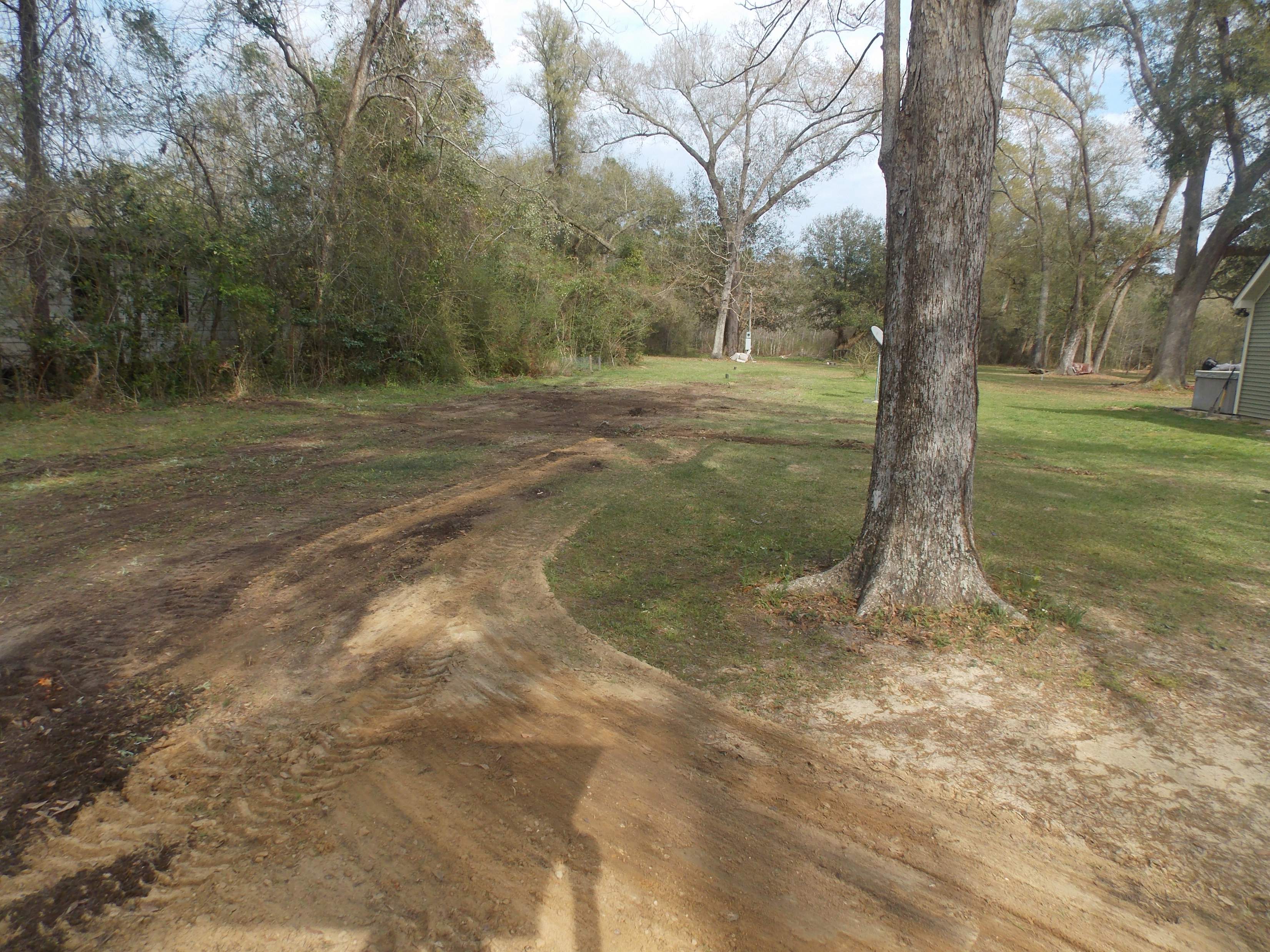

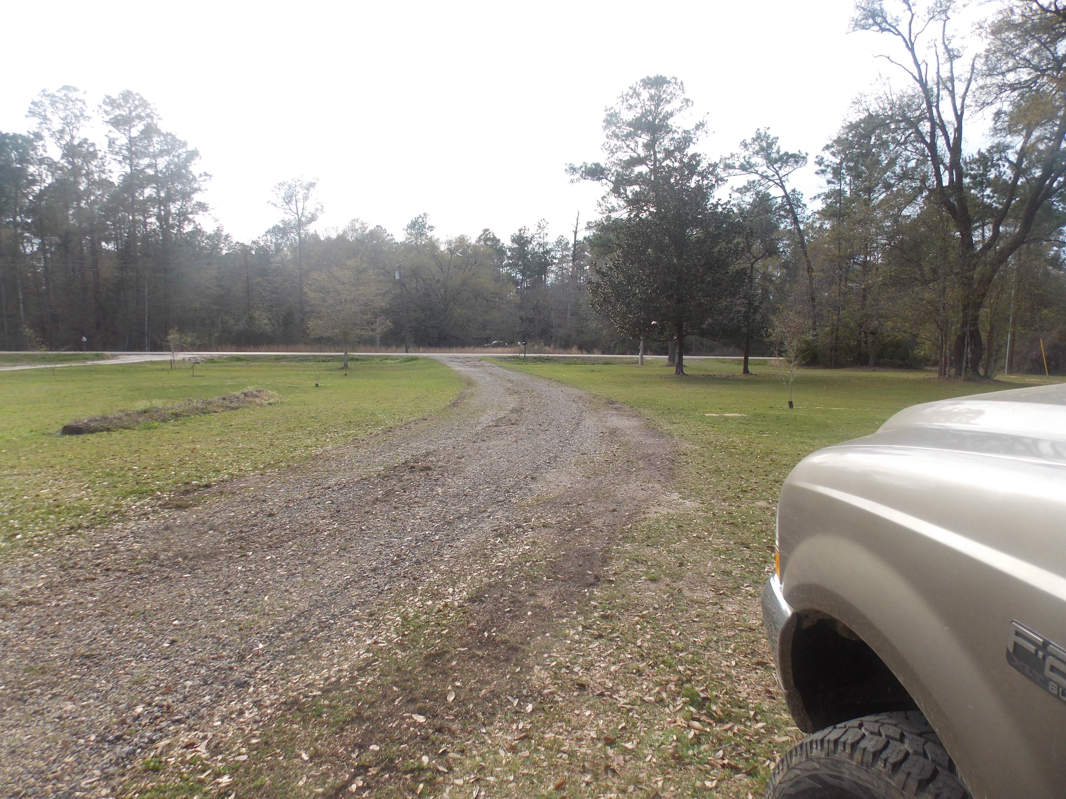

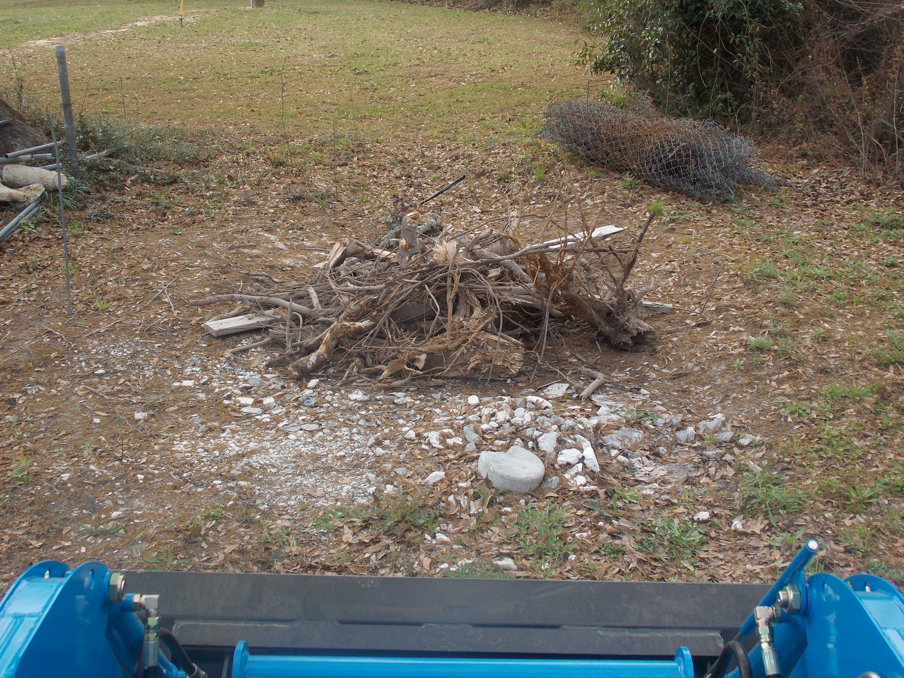

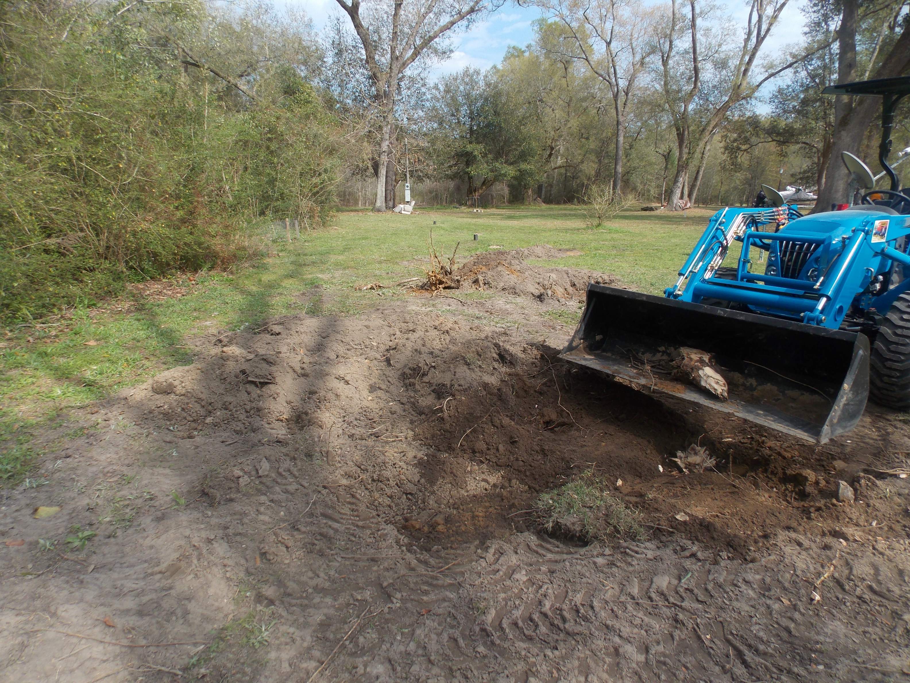

This is my first tractor and first time ever using one.Finished up the stumps I started on delivery day.Did some box blade work.Box blade on the driveway.Knocked down and dug up a few more trees.Only stopped because shes low on fuel and I haven't picked any up yet.First question is looking at the holes and size of stumps could I be working the new tractor to hard?I did chop the last bit of the larger stump with an axe to get it up but it lifted the back wheels many times and would go on to one front wheel a few times before I could let the loader down.Next question is when using the box I lowered it to the ground then lifted it about 1/4" is this correct? Also I've been keeping the rpm's around 1500 or so because its new then I read in the book to start the tractor at half throttle.Should i just run it like I stole it or keep a low rpm for a while? Oh yeah so far I love it(7hrs)and the extras you get as opposed to the 3038 I think are a big plus so far.But what do i know I've never used a tractor before.

If you are working or lugging the tractor give it more throttle. Doing what you describe I would be at about 2200 rpms. Stumps are hard jobs to tackle. On the safety side of things you definetly need more ballast weight. If you are lifting the tires up you can create a very dangerous situation very quick.

Be very, very, very (did I say very?) careful pushing trees over with a tractor. If it's bigger than 8-10" at the base, it's probably not worth messing with.
If you plan to do much digging, a tooth bar for the bucket makes a massive improvement in what you can get done. The teeth can also be used to carefully pry things up, or to tie off when lifting things that aren't super heavy.

Hopefully you were frightened when the azz end of the tractor came off of the ground from lack of ballast on the 3pt. You should be, because it is dangerous. Remember the front axle is on a pivot bolt, there is no suspension when the rears com up the tractor is free to flop one way or the other, and if you are on an angle it can turn you over quick. You will get to have a nice look at the lower half of your tractor. NOT good.
Adding ballast and loaded tires will make the tractors traction like a whole different tractor, much safer and much more push/shove/grunt. Of course with greatly increased traction now comes the possibility of tearing up the FEL, you have to use common sense. I know you want to get right in there and start using the machine, but going slow and learning as you go has some merit. Always think what will happen when you hook on to something, for instance if you hook a stump on the left front your right rear tire may raise in a heartbeat so keep you hand on the joystick and make small smooth movements.
I can certainly remember some mistakes I made through the years, and really just got lucky. I have never turned one over, but sure came close several times:eek: It looks like you have mostly flat ground, and that is a BIG plus. Good luck and happy tractoring:thumbsup:

If you lifted the back end "many times" you should slow down a bit. That's a dangerous move, and should be avoided. Get the tires loaded and add ballast before proceeding carefully.

Nice tractor and good pics. I lifted the tires up plenty of times when I had the R4041 & 4047. Like others have said, just be careful and throw some ballast on the rear.
