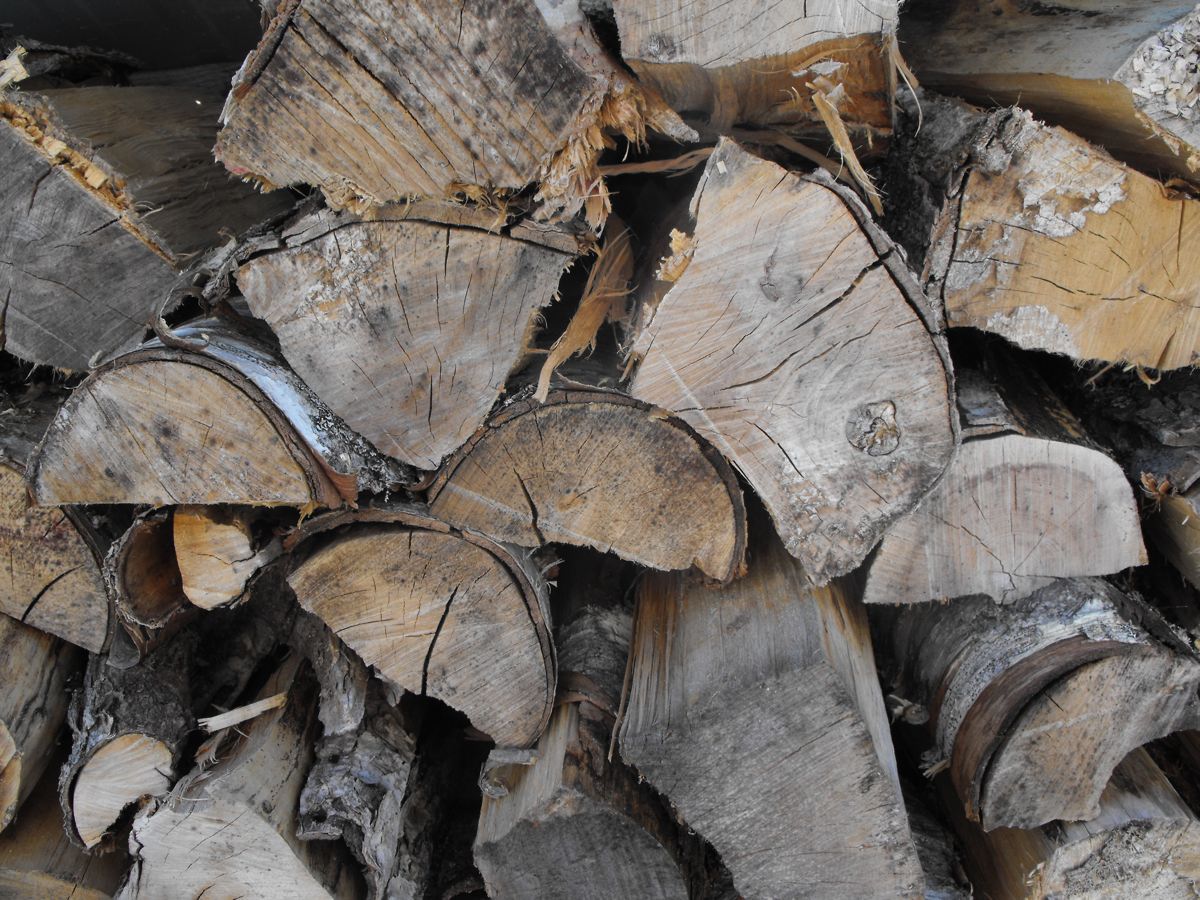

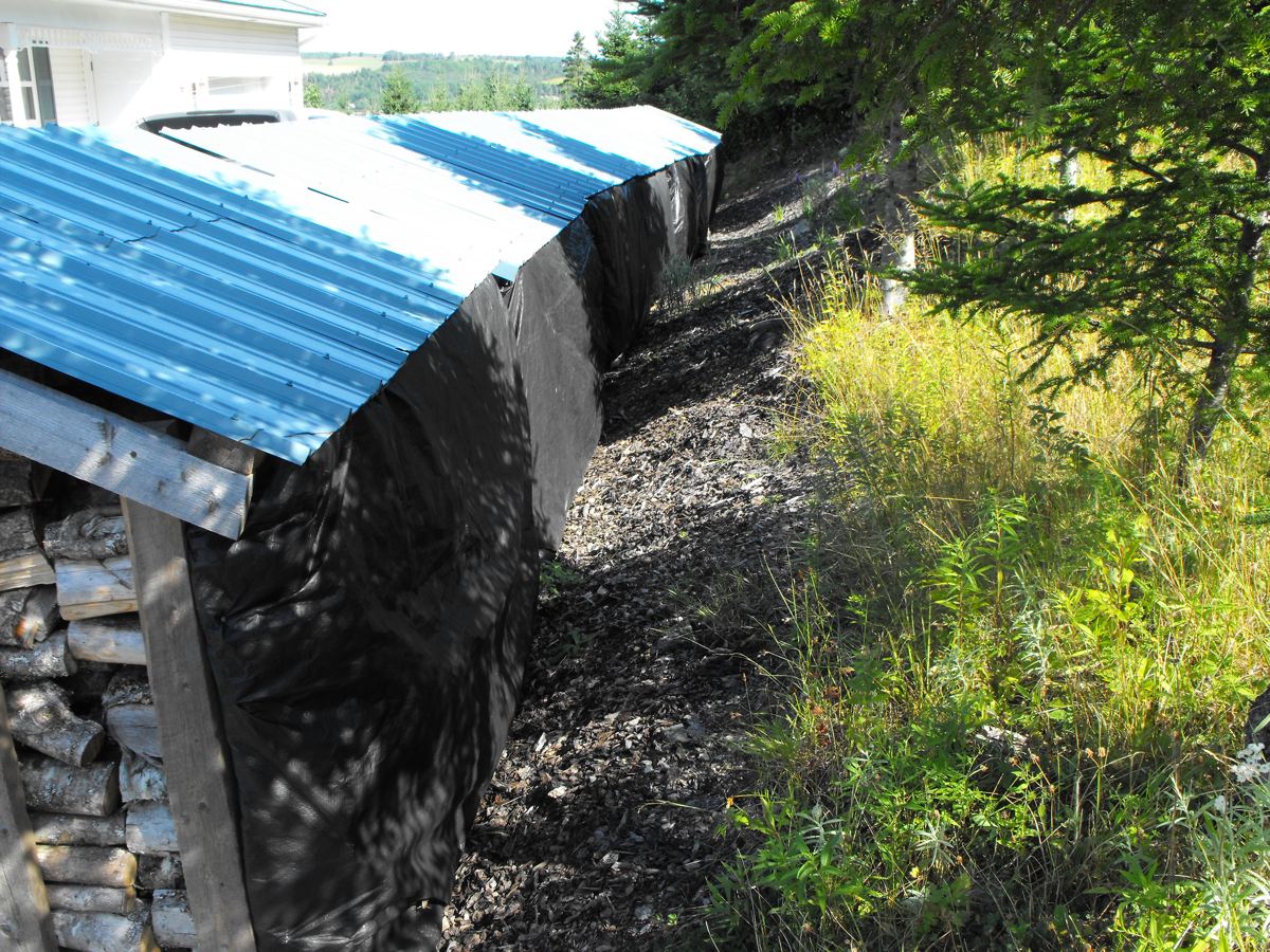

I wouldn't recommend covering the stack entirely. Like its been said, the wood won't breathe. Just cover over the top. The parts that still get wet will dry the quickest irregardless. And don't go out and buy tarp or plastic. Just go to your lumber yard and get some of the tarps that their lumber arrives in. Most yards throw out the tarps or give them away (rather than throw them out). See my pics of the 8 cords we keep. The front is kept open during the summer. The back is always covered (tarps from lumber yard). When the snow starts to fly, we cover up the front in a similar fashion. Only we leave a gap near the top to allow any heat and moisture build up to escape. Yes, even in the dead of winter we can see steam billowing out. The last picture shows wood we cut and stacked in place 4 months ago. It ready to burn as far as I'm concerned. And that's with a spring and summer with higher that humid/temp conditions. Summer really didn't arrive until last week. :D

Woodchuckcanuck,
that's a nice rack design you have. Are the cord sheds made out of 2x4 or 2x6 lumber?
