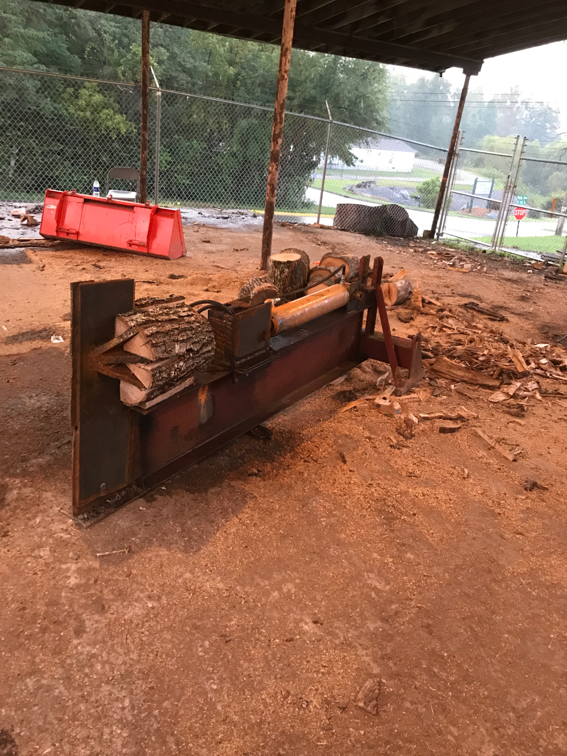

The best advice I have to offer on the splitting part is make sure you've got an adequate beam with about a 5/8 inch or preferably heavier top strap. I can say for a fact that 1/2 is not adequate. Here's the start of my processor that I'll probably never get finished. Another lesson at my expense is a tall I beam is not a good choice. That beam is 3/8 inch thick and 16" tall with a 5" bore cylinder. It's too weak for that load.

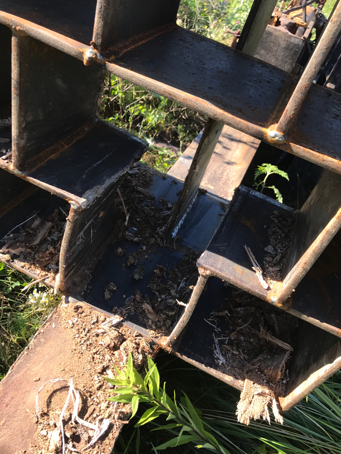

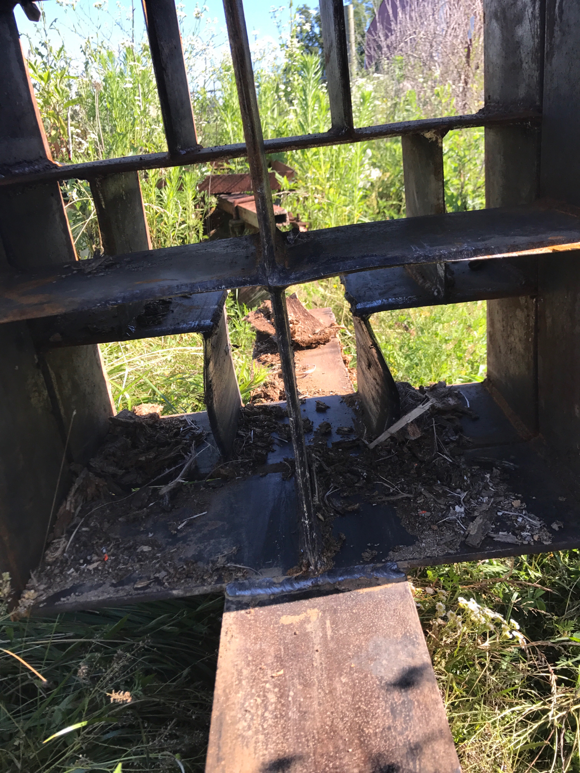

Another lesson at my expense. Those fancy box wedges are unlikely to work with the amount of engineering a first time wedge builder is likely to have. I don't know that even the best designed box wedge would hold up without high grade steel. IMG_0062.JPGIMG_0063.JPG
I was thinking a 8x28 wide flange I beam, it looks like its 7/16" think. 1/2" in not adequate? Man, what are you splitting??? :confused2::eek: Isn't too much for 16" lengths of mostly white ash and red oak? Some black ash at worse. I am thinking just a 4" cylinder , 2500psi. Isnt 15 tons enough for that wood? Even if splitting it before its dry?

A 4" might be adequate with a single way wedge. Forgot the idea of a multi way wedge. Is your beam 28" tall or 28" wide. If it's 28" tall toss it and find something else. My 16" tall beam was rolling sideways. Think textbook example of a DNA strand. I reinforced it, but it's still not a good choice for a beam. My original plan was to use a piece of 6x6" tubing with a 3/4 wall with a piece of 8x1/2 plate welded at the top for the track. That would have been way better than my current beam.
