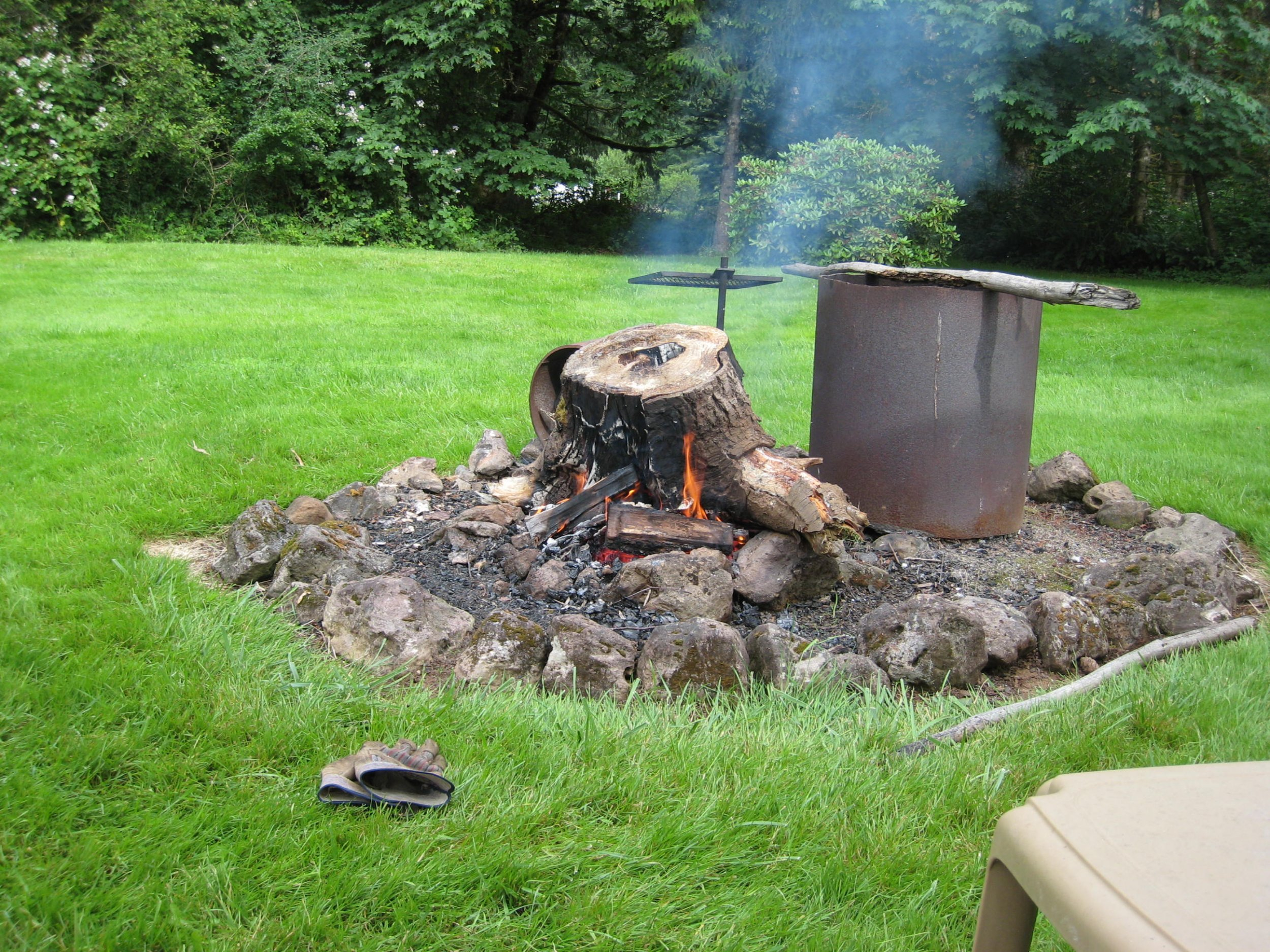

I put in a simple fire pit last fall consisting of a 12' x 12' array of pavers with 4' x 4' hole in the middle for the fire. It has been great to have the neighbors over for an evening around the pit. The land is flat, sufficiently far from trees and I put landscape fabric (used) down before l laid down the pavers. I wanted to keep it simple - no excavating, no gravel, no concrete. The result was a disaster - this spring grass and trees are growing between the pavers. Was the problem caused by using used fabric? Would new fabric prevent growth? I have considered thicker material - shower pan liner, roll asphalt roofing, pond liner - but I am running these alternatives on TBN to get your ideas because I do not want to experiment and have to do it again. Your ideas are welcome.

it must have grown through the fabric. never use anything non-permeable on the soil.
i would roundup it and call it a day i think. if you want to redo it, i would use new fabric, but whatever heavy duty stuff you find, i get mine from a landscape supply place and its way tougher than the big box stuff. or 2 layers of the big box stuff. really, the right way is to get rid of the organics under the pavers, build up with road base, compact.

"never use anything non-permeable on the soil."
Why is this? Many fire pits have tiles set in mortar on concrete. Then there's patios, etc., I could go on...
I will check out fabric from a landscaper and compare it with what I now have. Thanks.

We dug down 8" remove soil than fill it full of hard pack for our small area.
   / Fire Pit Idea Needed #6
Lift a few pavers. Is the grass growing through the weed fabric? Or between fabric and pavers. The ashes are like fertilizer. How do you mow the surrounding grass?

pool liner and plastic sheeting is what i mean, never use it under something like pavers or rock or mulch. its terrible for the soil and can create problems with the stuff above depending on how much rain you get.

I think 12'x12' is way too big - too much maintenance; not enough fire. I just scraped a shallow divot about 3' diameter in the ground. No nothing else. Just burn in the divot and clean out the ashes periodically. Works great all the time.......
