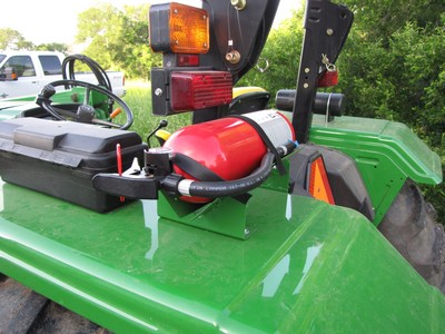

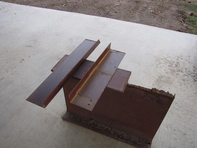

I've just added a fire extinguisher to my tractor. Couldn't mount it on the ROPS since I couldn't reach it from the ground, so I put it on the fender. Here's the metal I started with which is left over from building the barn. The bracket mounted and with the extinguisher in place.

Great idea and good job. :thumbsup:
Now, do me a favor. Get a real fire extinguisher. I suggest Amerex or Badger. I serviced extinguishers for 14 years. Real fire extinguishers do not have Kidde or First Alert on the label. Trust me, that Kidde is junk. One day, maybe when you need it the most, it won't work. Plastic is fine for lots of things, but a fire extinguisher valve ain't one of them.

I owned/operated a fire extinguisher service company for 14 years. I speak from experience. Plastic valves are JUNK! Period. Ever notice that the places that sell those things DO NOT have them hanging on the walls of thier store? Think about it. ;)
To answer your other questions, a 2.5 pound extinguisher is better than not having one. A 5# is twice as good. (if you can find a place to mount it)
Go to your local fire extinguisher service. (should be listed in the yellow pages) They will sell you a quality extinguisher, that they will service, and a proper bracket.
I would suggest Amerex, Badger, Ansul or Buckeye. (in that order) Stay away from anything branded Kidde, Flag, or First Alert.
