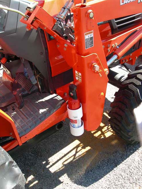

It's nothing fancy but it does the job, mainly I wanted to try out the camera.

Two 3" PVC couplings at the bottom I glued a 1/2" piece of 3" pipe to keep the extuinguisher from falling through also it doesn't hold water or dirt. Next job is to attach a lenght 10" to 14" of 4" PVC fencepost with a cap to hold tools. As you've probably guessed I can"t weld.

Good idea, looks nice. I just mounted the extinguisher bracket on the Case ROPS w/ HD tye wraps, it sits on the base of the ROPS. /forums/images/graemlins/grin.gif
   / Fire Extinguisher holder #4
Dont need to weld if it works /forums/images/graemlins/grin.gif /forums/images/graemlins/grin.gif
Mine is just a piece of flat bar bolted to my triangle holder and the the bracket mounts to that. It was to close to the base of the rops to just bolt it on. /forums/images/graemlins/frown.gif

Many years ago I had the Coast Guard do a safety inspection on my boat. The only problem they found was the way the fire extinguishers were mounted. They claimed if they were mounted vertically they would tend to "pack" all of the solids on the bottom of the tank due to the constant pounding and possibly not discharge properly. They recommended mounting the extinguisher horizontally. Since the boat (and the tractor) will tend to keep the solids less packed due to the rolling effect of the boat. Just a thought... hope this is of some help.

Very valid point Gary. I've got into the habit of tilting my extinguishers back and forth a couple of times until I am sure I can feel the contents moving from end to end. You can feel the weight transfer. However a horizontal mount would automatically do that for you.

I don't think this was the case with this Coast Guard inspector, but he might have overstated the problem. Never the less, it did make sense. Since then I have always mounted them horizontally. Just thought I would pass it along. /forums/images/graemlins/cool.gif

I used to check the ones on my boat and did find they were never "packed" once I mounted them horizontally. I am a believer .... I have to believe the same will hold true for an extinguisher mounted on a tractor. Now I just need to mount one!!!!! /forums/images/graemlins/confused.gif

Interesting thought about mounting horoz. Somehow I suspect I get the tractor bouncing up and down enough to make a Martini, never mind keeping extinguisher powder agitated /forums/images/graemlins/grin.gif I have fired off plenty of units at the end of a job when they hung on the wall for a year, they discharged /forums/images/graemlins/smirk.gif
