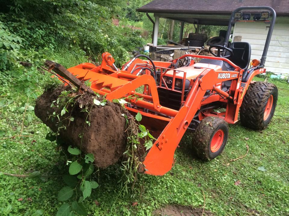

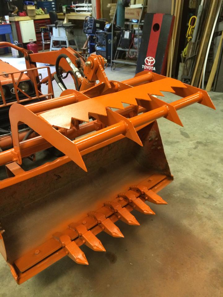

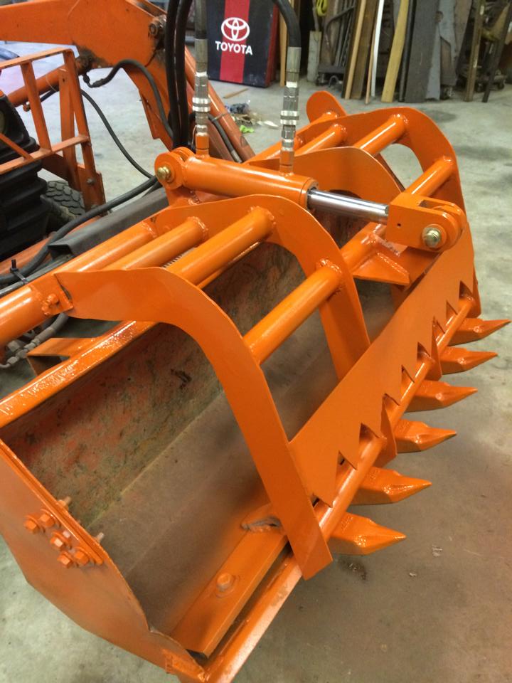

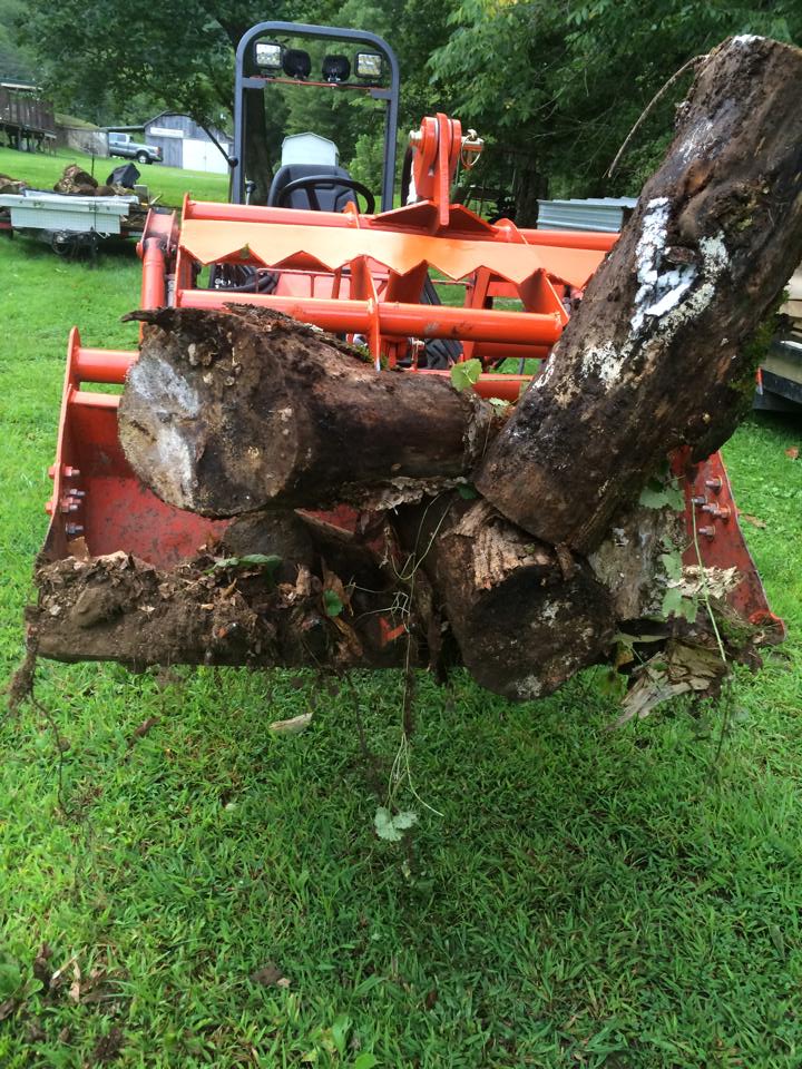

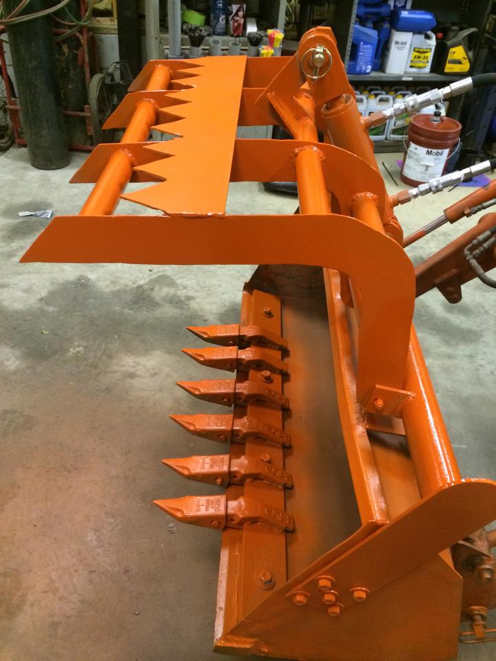

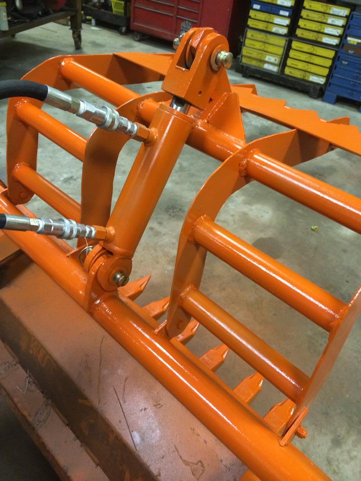

After seeing how handy a grapple for my FEL would be I made one with stuff I had around the garage, I had to buy hoses and Pins but most else was already here, Also Made a removable lower tooth bar which helps to get under stuff,I made it light weight and did some rough testing today, Nothing is bent and it performed better than expected, loaded about 55 logs with it and bunch of other stuff,
