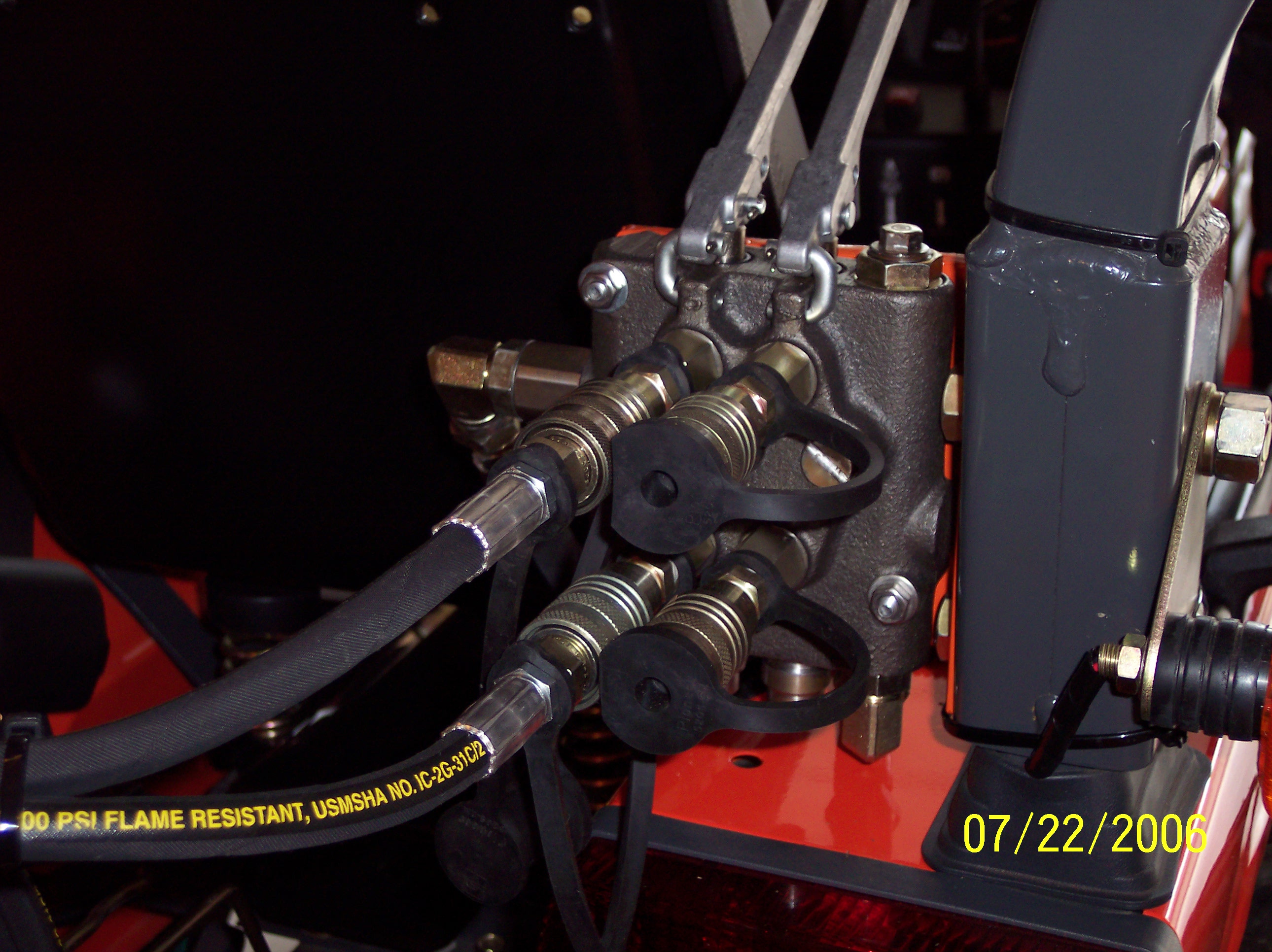

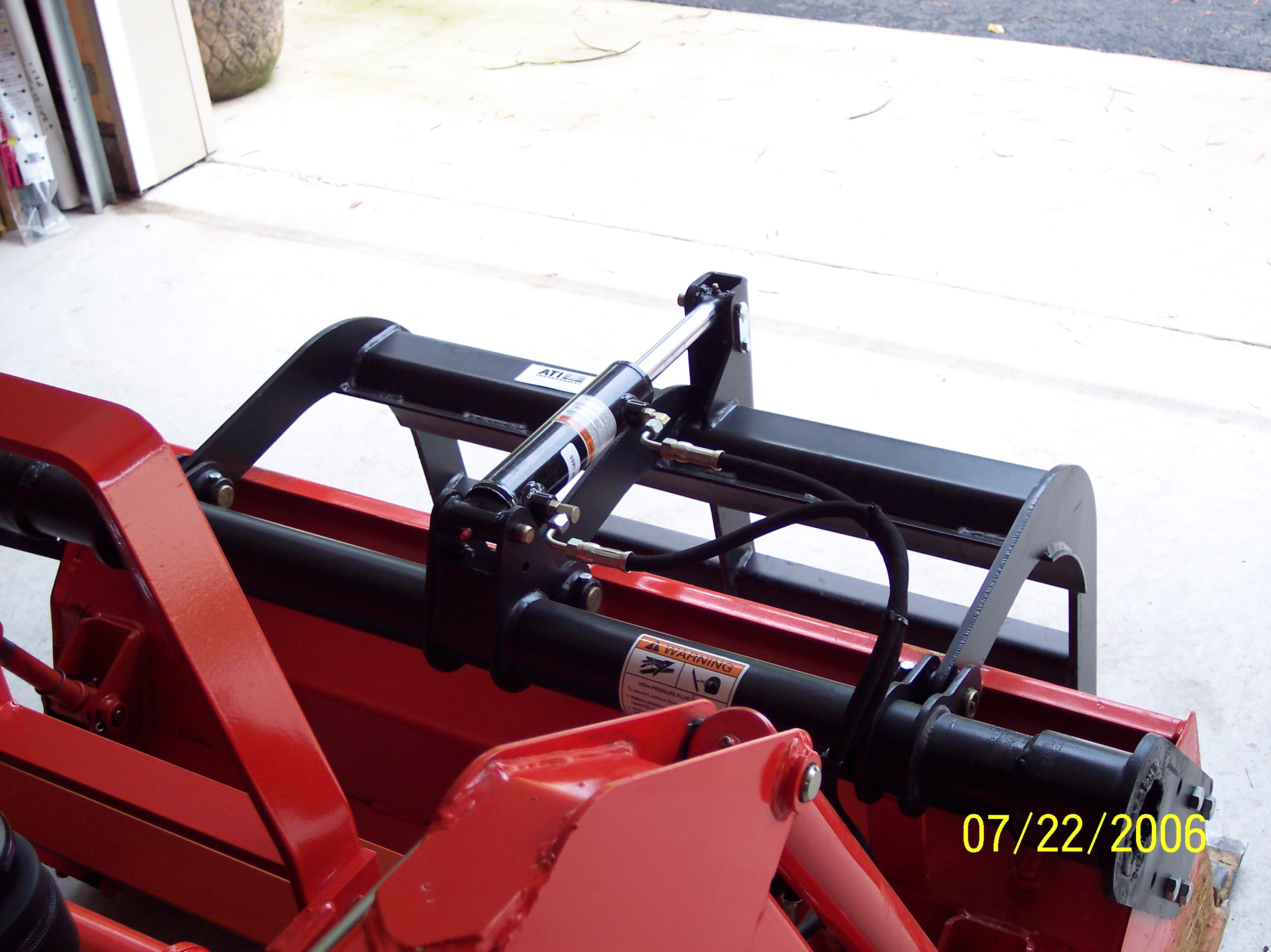

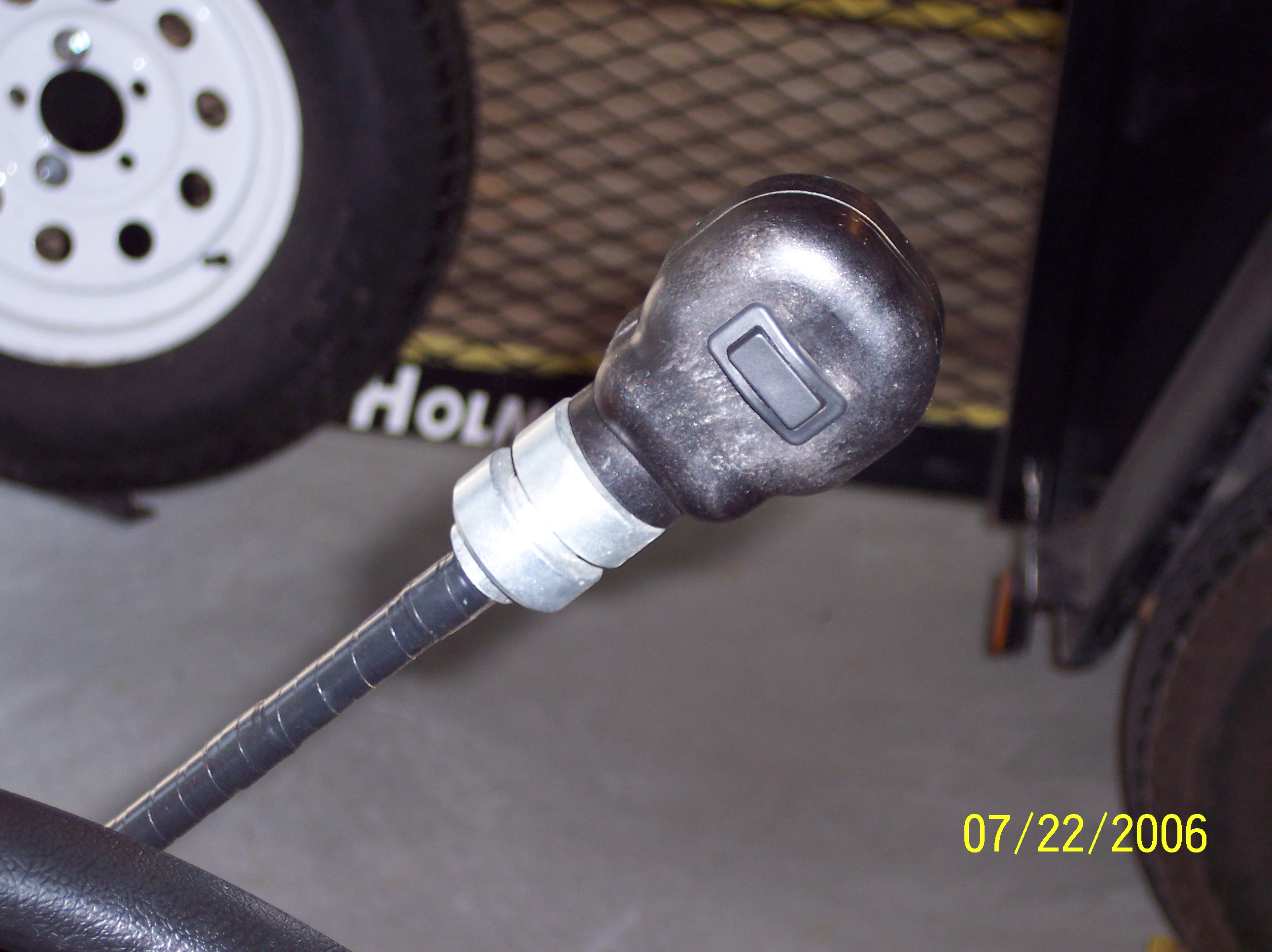

I would like to thank everyone on this forum. The info on this site has been great and a true time saver when it comes to projects like this. I started with the need for a front grapple. I bought the ATI grapple and the electric remote valve from W.R. Long. This is a great setup and works perfect! But I still had the need for an additional remote in the rear for a HTL. For this I used an Eaton Cessna 2-spool from Surplus Center and a cylinder from Redland Hill (cut to 16 1/2"). The most difficult part of this project was determining all the fittings and adapters required. I will post the listing here to hopefully save someone the time and money if you want to add remotes to your 7510/ 7610. Here are some pics.
Grapple......

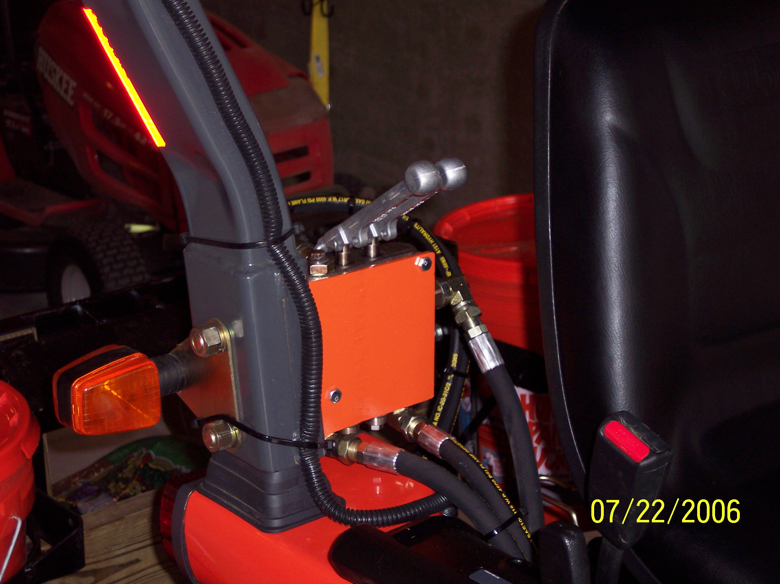

Rear Remote.......

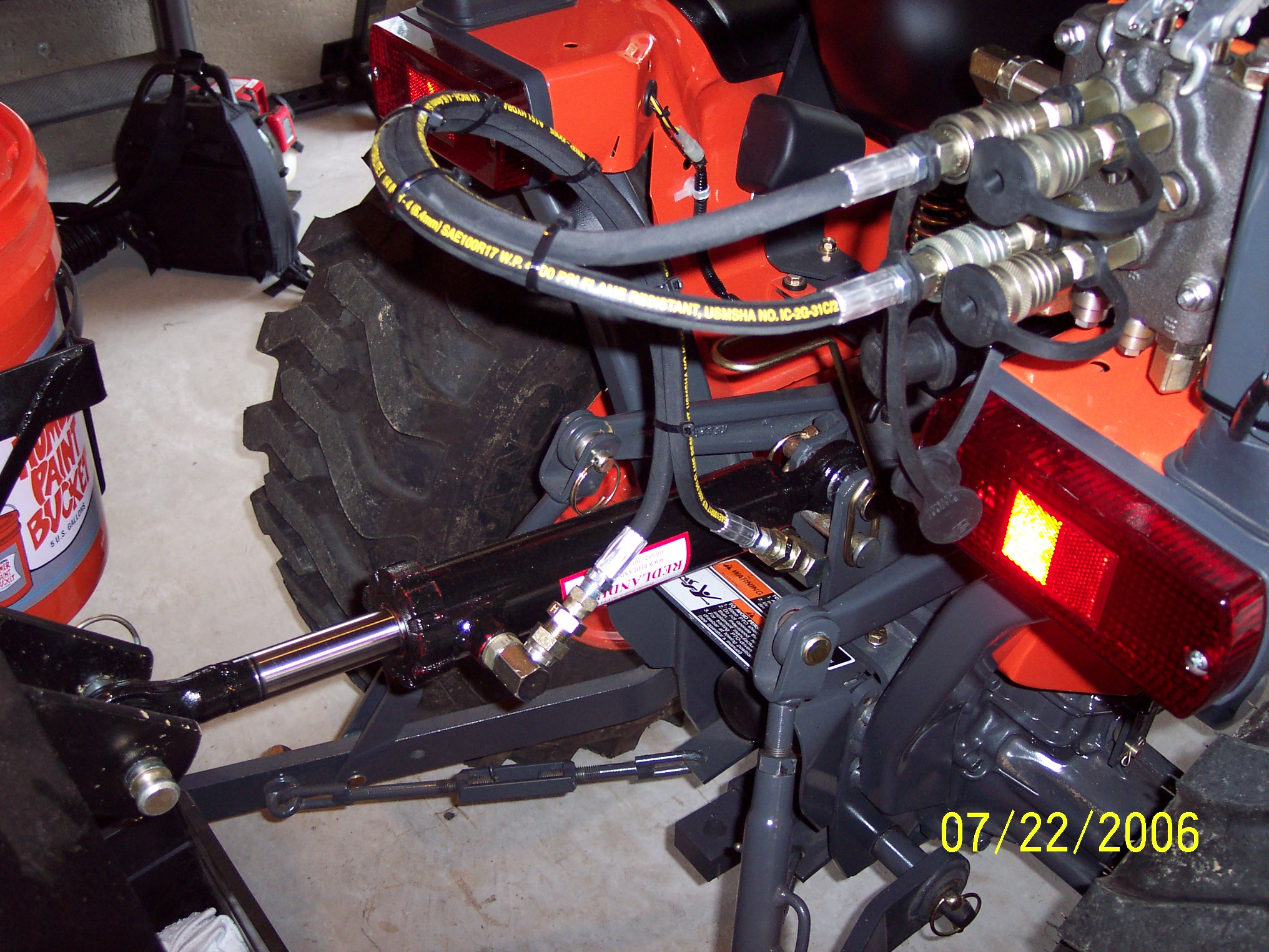

HTL...........

Very nice, PSDawg. I especially like the way you mounted the remotes; very neat. Far better than the mounting the dealer used on my B7610. I'm going to have a look at converting what I've got into something that resembles your installation.
Good Job!
Bob

Very nice install - great location - looks really clean.
I, like Bob, think I'm going to try and rework my remotes (three spool Prince SV valve on my B2910) to a similar location and mounting.

SIR,
i am in the process of trying to do a top, and tilt.
i will have to shorten cylinders, or buy new
ones. do you have a website for the cylinders?
did these have the ball ends on them, or did you
have to rework them?
thanks, and good luck with your projects.
accordionman
wlbrown
wright city, mo.
   / Finished 7510 Remotes!
#9
I ordered the cylinder from Redland Hill and they do come with standard Cat 1 ball ends.
http://www.redlandhill.com/
Very good people to work with. They buy the cylinders, disassemble them, and then install the Cat 1 ends. I believe they buy in the tilt cylinders ready to ship.

Dawg - many thanks and a bubble for your beverage of choice after posting that parts list, it's a huge timesaver! Been leaning towards the same valve location on my 7610 too, but afraid the oem armrest kit will pose an operational or clearance issue.
