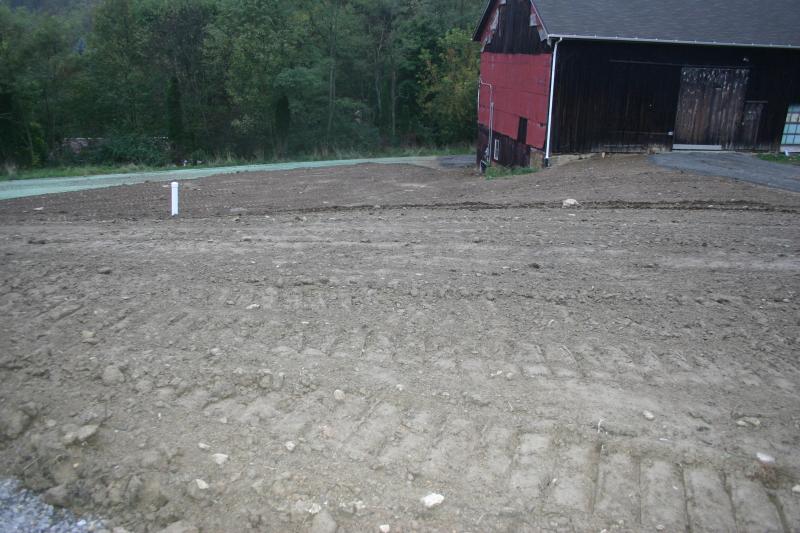

another of the yet unfinished yard.

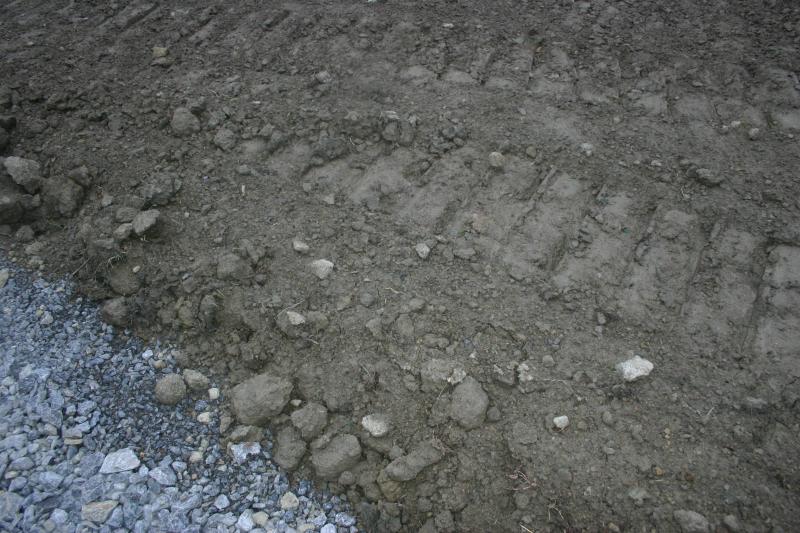

a close up of the topsoil.

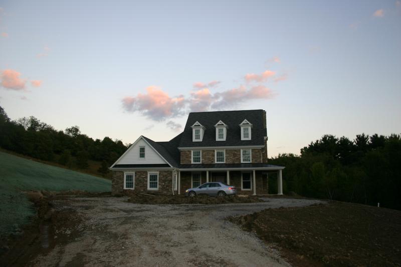

and here's the new house.

Gary,
It actually does not look like you need a lot of work in that the pictures at least indicate the dirt to be pretty clean.
If you are unable to find a yard rake I would simply do a light til on the yard possibly add any needed fertilizer, lime etc prior to the tilling. Once you have the yard tilled rig you self up a drag out of chainlink fence or rent a harrow. Drag to get the yard level and slightly packed add seed and then drag over the yard slightly again to mix the soil and seed.
