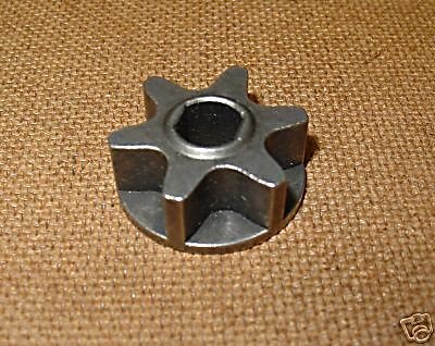

I have an B&D electric chainsaw that I don't use often. It's about 10 years old. Somewhere, somewhen after I last used it the sprocket at the end of the chain came off and went missing. :thumbdown: The part number is B&D Chainsaw Metal Drive Sprocket Gear 376812. Apparently it is discontinued in the U.S. but they have them still available in the UK. But it seems none of the U.K sellers will ship to the U.S.
So does anyone know a dealer in the U.S. that might have them gathering dust on a shelf or a suitable substitute?
I don't want to buy a new $80+ chainsaw for a $5 sprocket. Especially considering how rarely it will be used.

who actually makes the BD chainsaw ( look up the look a like )
six star sprocket ( check your chain size and pitch ) and go look for a match at poulin , crafstman, remingtion , etc...

it is a good chance the craftsman would work, Black and Decker made tools for Craftsman. Your chainsaw may have been built by Black and Decker, they at one time actually did manufacture their products. Not any longer all are made in China or Mexico including the DeWalt line.

It came in Saturday. It isn't a 100% match. There was a little bottom on my old one. It fit though, but I didn't have a chance to fire up the saw.
