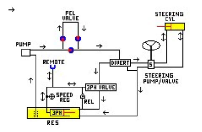

Does not sound like it's plumbed correctly to me ?? Coming off the back of the pump it should go directly into the loader valve, out of the loader valve to the diverter valve.If yours it plumbed like this the loader should would because it is getting hydraulic pressure first and its a normally open valve.The loader valve would need to be replaced if that's what it is, without a gauge in line you do not know where the pressure relief is set at on the valve, so if it's set too low it will bypass and not allow the loader to work

I think it's plumbed correctly, I probably just described it poorly. Line comes straight off the pump and goes into the bottom of the FEL valve. Line comes out of FEL valve and goes to diverter. Does that sound right?
What you're saying though, is that it doesn't matter whats happening upstream from the FEL (with the diverter), it should work as long as there is flow?
Is there a procedure for adjusting the relieve on the loader valve?

What is the diverter valve diverting? What kind of tractor is this? Are calling the hyd block the diverter valve? How many hoses or on the fel valve?
   / Finding point of failure - diverter valve or FEL control valve
It's a Jinma 254. The way I understand it is that it's a priority valve to provide pressure to either the 3pt or power steering. I'm attaching the hydraulic routing diagram I've found. The FEL has 6 hoses. One from the pump, one that feeds into the diverter, and 4 for the cylinders.

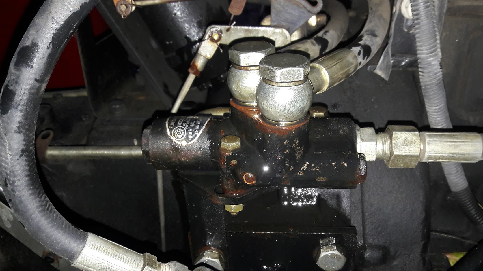

How are you switching the diverter valve? Some diverter valves have a slot that you turn with a flat screwdrive tip. If you could show a picture of the diverter valve it might help.
There is no switching the diverter as far as I know, it happens automagically.
