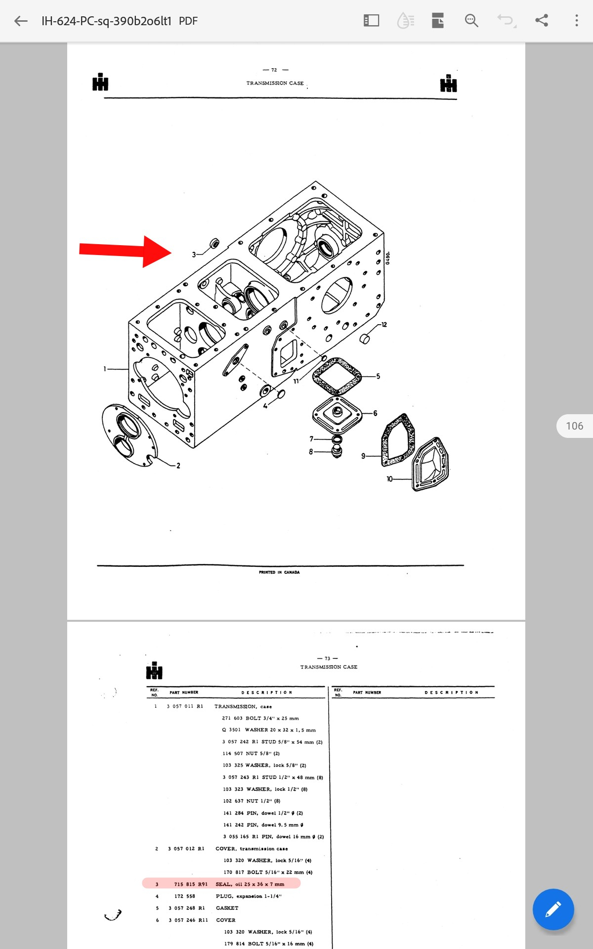

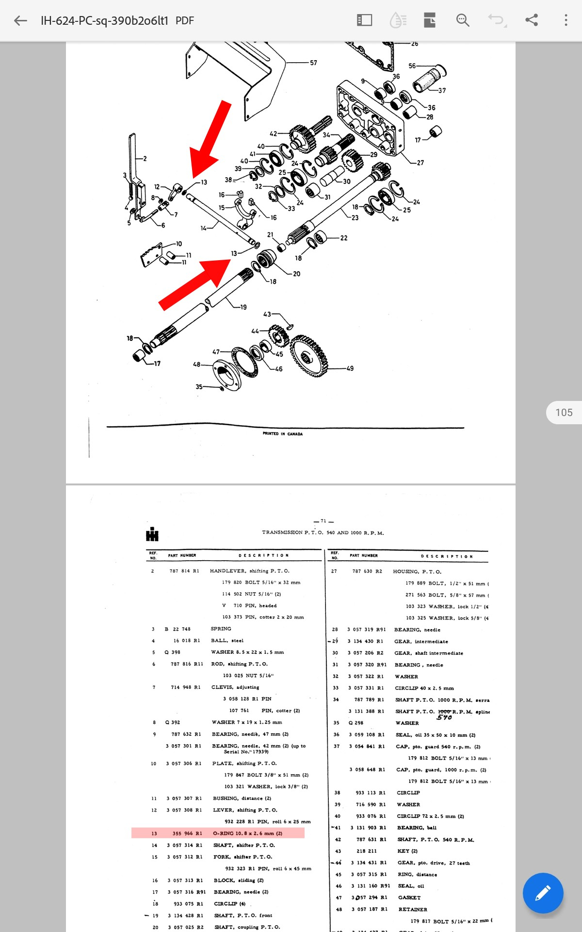

Maybe mine is the donor. It really have seen better days. But could be fun fixing it up a little and get some more use out of it. But if I cant find parts for it there is no reason in splitting it apart.
What is really annoying now is its severe leaking of trans oil from the pto lever on the side of the trans case. I have a parts manual for this model but am not sure what part it is. There are two drawings. One shows the trans case with some oil seal about where the lever is. The other shows the the lever and pto mecanism and shows two o rings. But orings are not seals and why two? The shaft doesnt go through the other side og the case.

O rings and seals looks quite std, should not be a problem.
