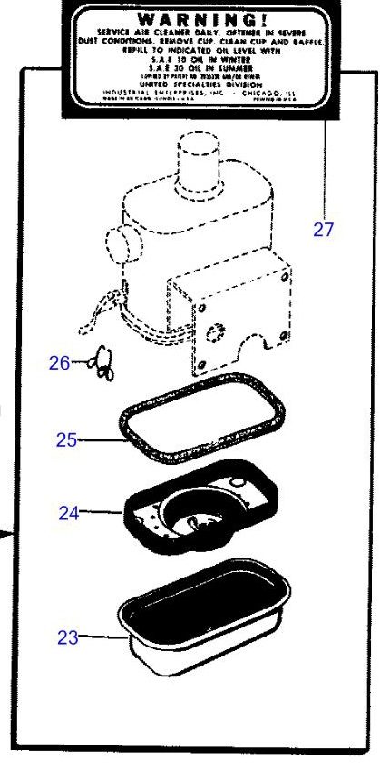

I am loosing patients trying to find parts and prices for my MF-35 perkins diesel, I only want the parts for the air filter, or even the whole unit.
I am venting:mur:
Part Number Qty Description Comments
1755111M92 1 Baffle Assembly sits in oil pan.
193130M92 1 "Cleaner Assembly, Air (Order 187467M94)" The whole assembly
1755110M91 1 "Cup Assembly, Oil" oil pan
1755112M2 1 "Gasket, Cup To Body" oil pan gasket
1019899M1 2 "Spring, Side Clamp" side clamps

Being the Diesel Deluxe it has a different configuration. the attached jpeg is the correct version
