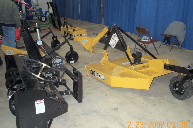

Who is the Kodiak blade manufactured by ? My search's for Kodiak Box Blades is only turning up pocket knives. $395 seems like a good price for a 6', How much do you figure it weighs ?
   / Finally went and did it. #4
Kodiak implements from NY Farm Show
{see attachment}

Hi Ed...
I was looking at those units at the NY Farm Show a few weeks back...
Those prices were quoted by the distributor... as retail...
On ground engaging implements... one of the things I look for is a strong A-frame assembly... since I don't own a box blade... I can only tell you what my eye likes... certainly not experience from using one... the best I've seen so far has been the Gill... $$$$$$$$$$ /w3tcompact/icons/smile.gif
