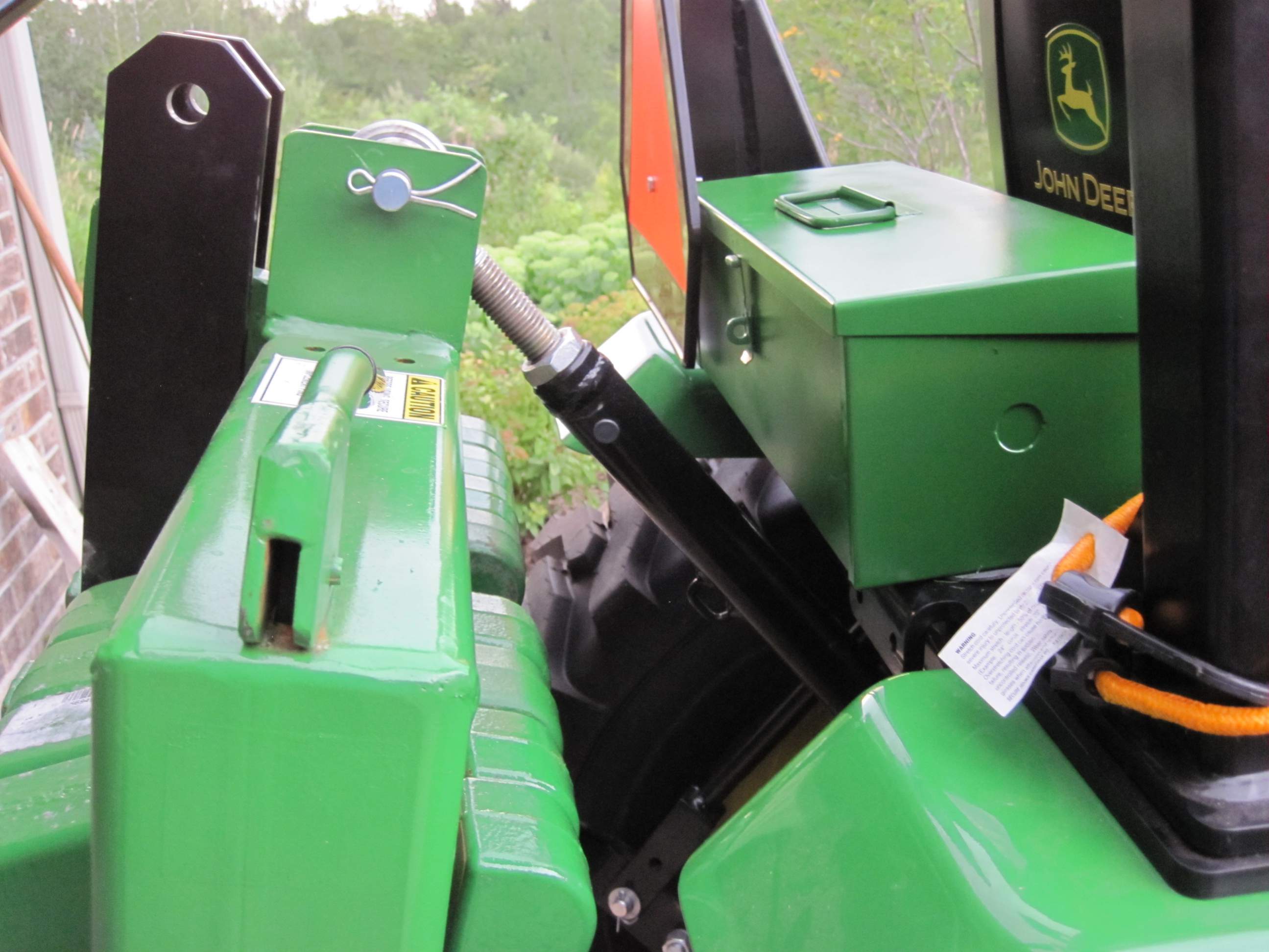

I have to agree on the lights, brush guards, hooks and toolbox.
The lights can be done by the dealer or yourself. JD makes it easy with the plug n play style connectors. Same for the brushguards.
Depending on your dealer they may or may not be able to weld on the hooks to your loader. I would go with a min of 2 and place them inline with the loader arms. If they cannot provide the hooks and you do not have access to a welder...Kenny's Hooks are an option also. Ken's Bolt On Grab Hooks (Ken is a fellow member at TBN).
revitupfaster was spot on when he said there was no place to carry any tools on the 2x20 series tractor. I also added an ammo can to the front to carry my chain.
Push hard for the iMatch in the deal. If nothing else maybe you and the dealer can split the cost.
Others have more knowledge on this than I, but if you remove the loader and have the box scraper on the rear with wheel weights...does it require suitcase weight in the front for proper ballast?
Oh yea, and if you go with the auxillary lights, I would recommend the Glare Shrouds offered at Artillian. Glare Shrouds (Chris is another member here).
And finally no worries on the reply, we are good at spending someone elses $$
